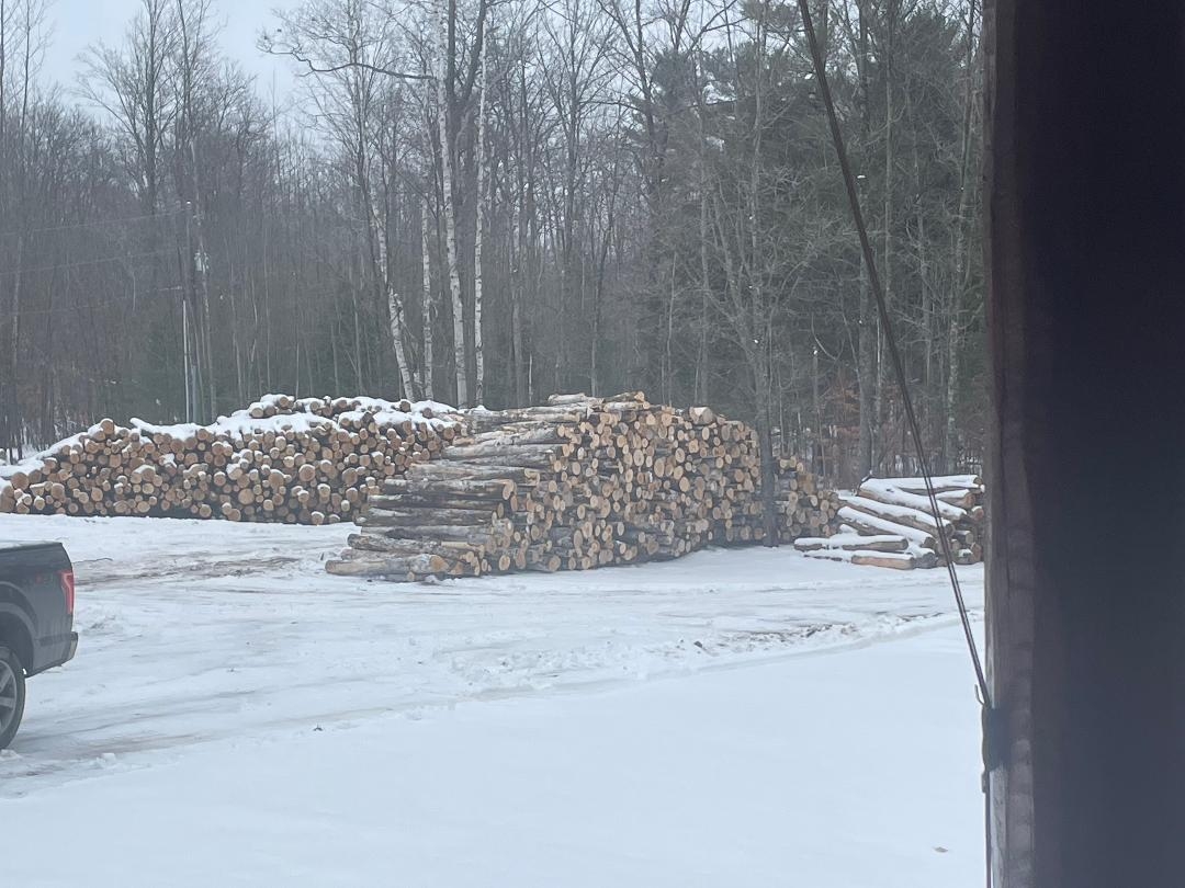

You are right. I was going to use a diverter valve but the dealer talked me into a third function and I am glad he did. But I run a small firewood business. For the guy moving 100 logs a year and some brush, the diverter value is not a bad way to go. I move 100's of logs. This is part of my last delivery:
