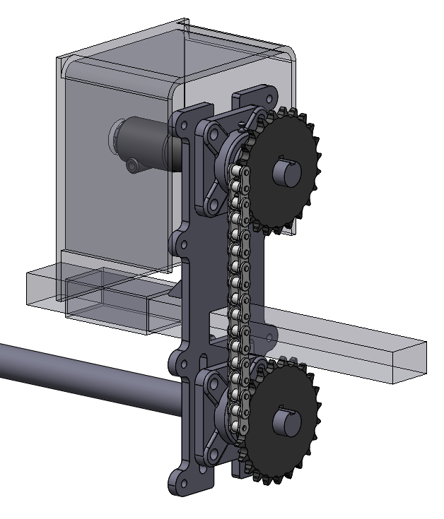

Do you have any detail pictures of the rear-to-front drive system? I'm guessing mounted bearings, sprockets and chain drive?
   / Loader mount front snowblower for Kubota B2920
#12
VERY nice!
Yes, you are correct. It was tricky sizing the sprockets so that they would clear the drawbar and still fit with the guard between the 3 point lift arms.

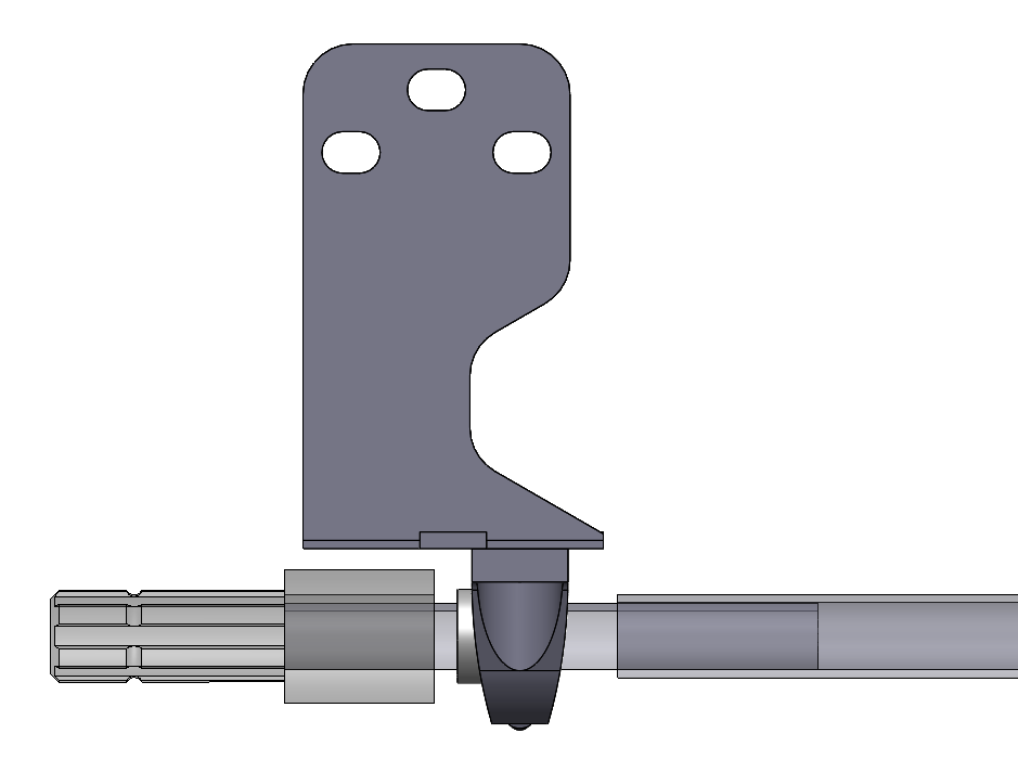

Last question: The main shaft to the front...did it come with splines for attaching the drive shaft?
#14
Ah, thanks.
No, the main shaft is a piece of steel tubing. I purchased some 1" keyed shaft from Surplus center, which was slid inside the tube. I used an adapter (also from Surplus Center) to go from 1" keyed to 6-spline PTO. This layout also gave me a nice surface to use with the pillow block bearing (see picture).
From you picture it looks like you have a 1 to 1 gear ratio, so as to not change the RPMs is that correct?
I have thought of building something like this to run a mower in front of my tractor.
How are you keeping the chain and the gears lubricated?
