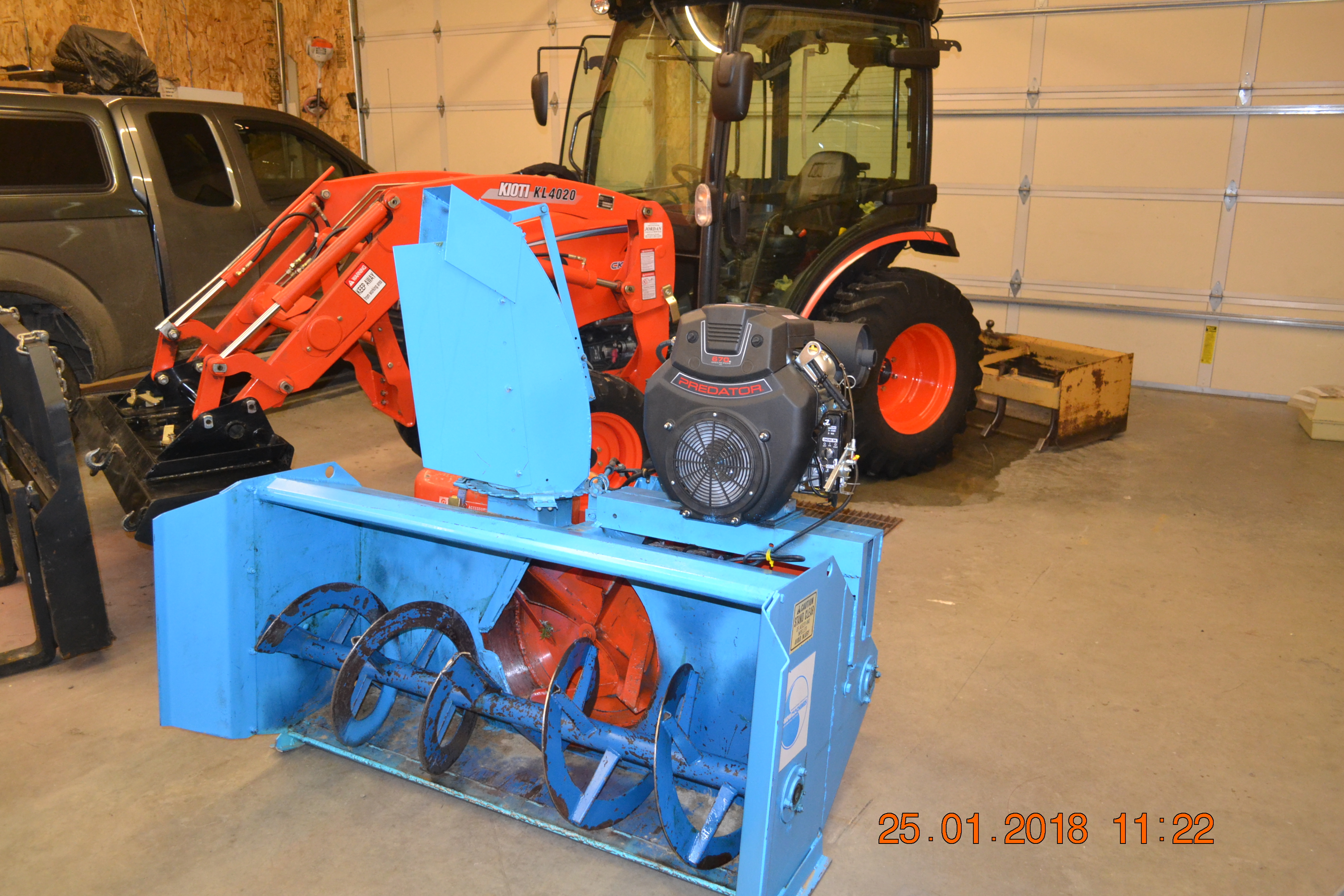

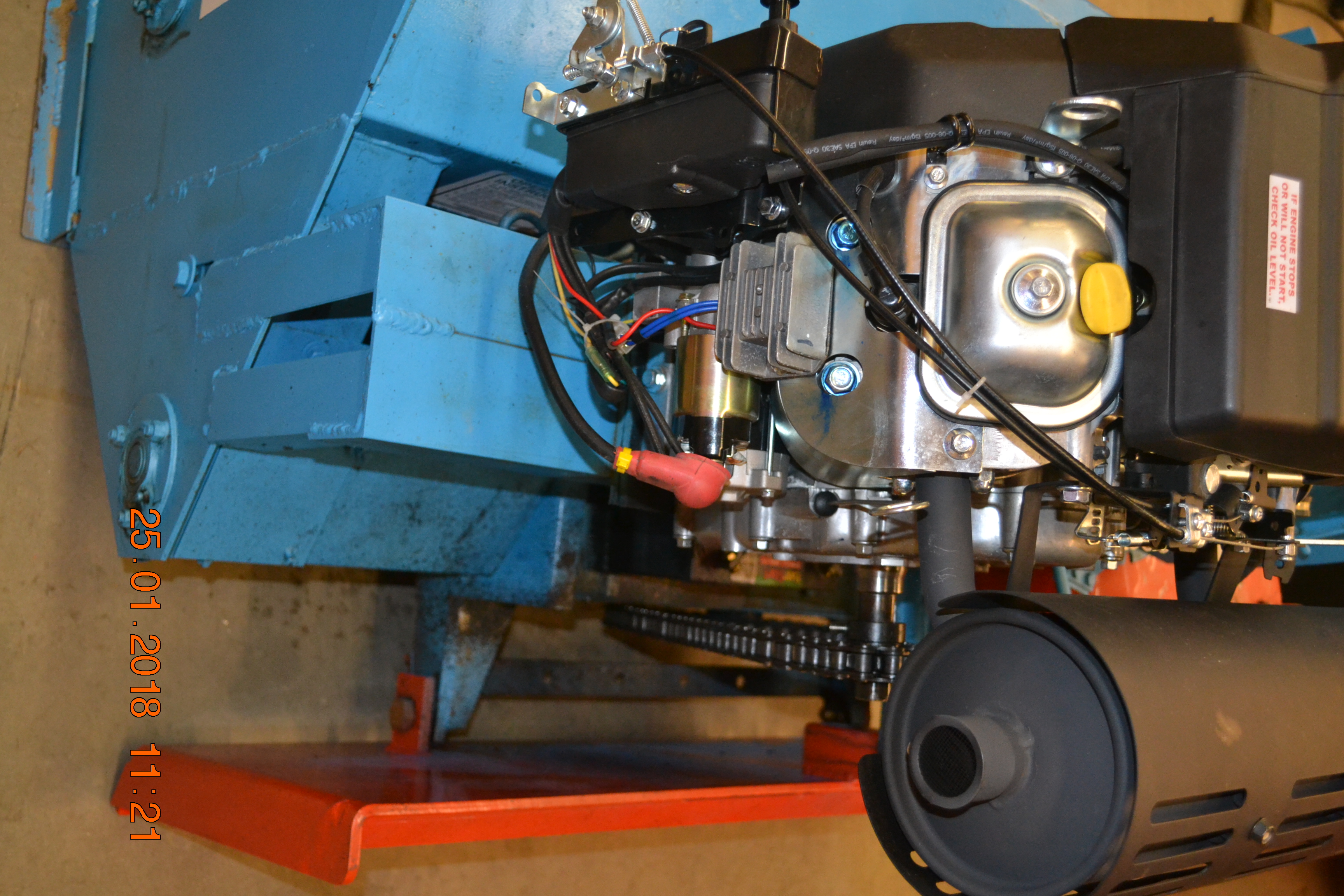

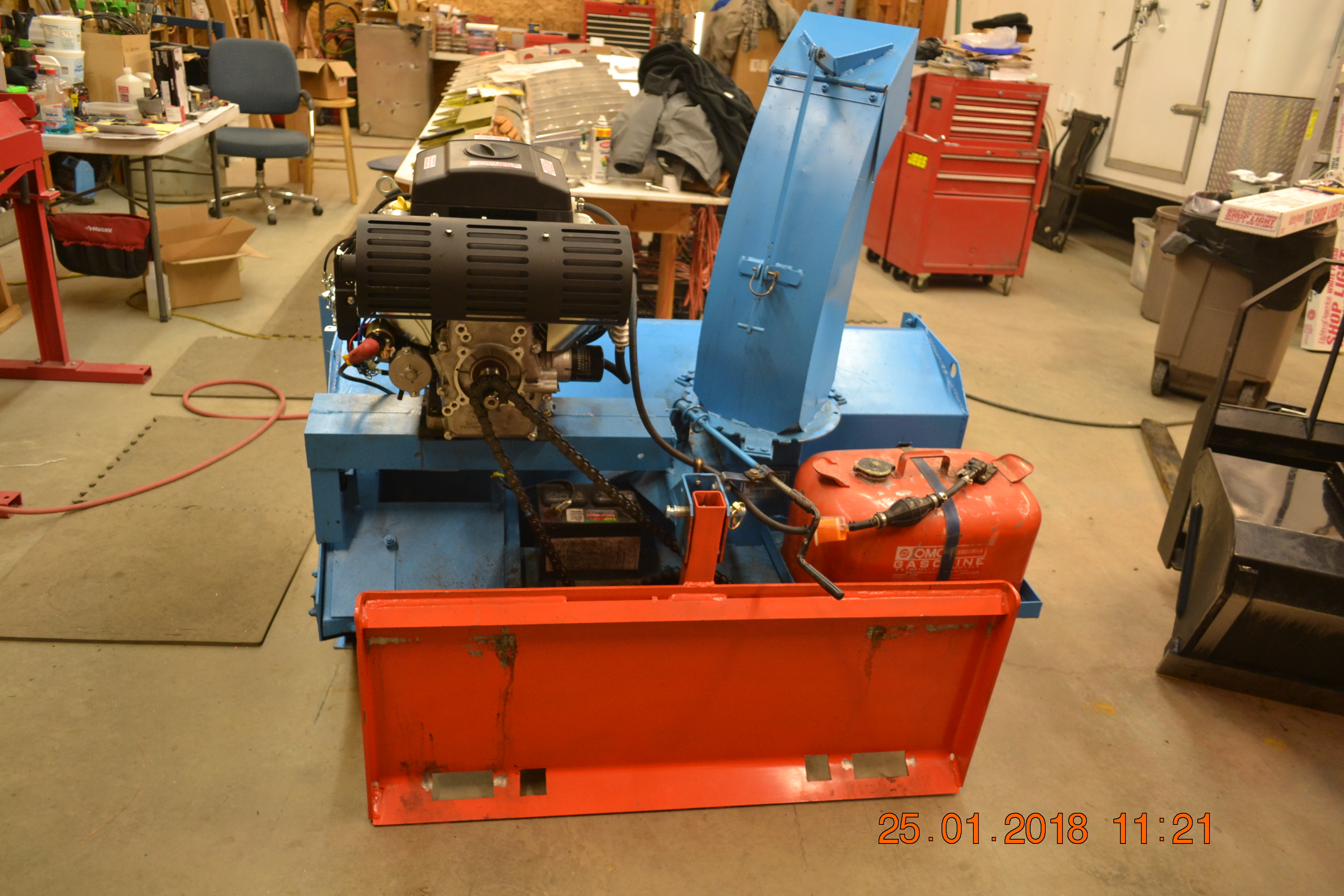

By request.
Conversion cost about:
Engine: $620 with coupon
QD plate: $100
Chain and sprockets: $175
I had some steel to make the QD attachments and of course expert welding...free. I paid $500 for the rear snow blower so the entire thing cost about $1,500 and allows the whole thing to be lifted up on the FEL to clean up and take it up to blow snow deeper than 16 - 18". We had one snow of about 28" which required two passes but worked fine. I welded a piece of 2" angle on the bottom of the front edge to keep it out of the rocks and also skids on both sides as well. No problem at all with picking up rocks or dirt.
I bought a 2500 lb remote control winch to control the chute but haven't got around to installing it. I haven't found it a big deal setting the chute to throw to the right and do most of my drive and area between the house and shop (80' x 100') using just the "right" setting. I do sometimes set it straight ahead to move snow in different areas. It's 1.3 miles from the house to US 95 so all the neighbors do their part to clean the road. I clean the 1/4 mile along my property and usually the widow's drive and parking area. Takes about 2 hours to do it with the blower from inside a 70F cab...great improvement over heavy clothes and wet condition on my old Ford...but I do kinda miss it.
