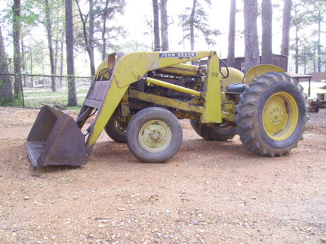

I have a JD 1010 landscape loader.When raising and lowering the bucket it is real jerky.When dropping the bucket it drops real fast! What is the problem?

I have been a mechanic all my life but not too much on hydraulics.The control valve has just three positions.up,stop and down.By the way this is an old 1963 JD 1010 Landscape loader.They were just like the backhoe but no backhoe attachment on them.Hydraulic pump on front of engine.There is no filter on it and looks like there never was a place for a filter adapter on it.Its just strait thru to the pump and no screen or anything.The oil is really clean and was changed about a month ago.It was also clean when I changed it and no sludge in bottom of tank.

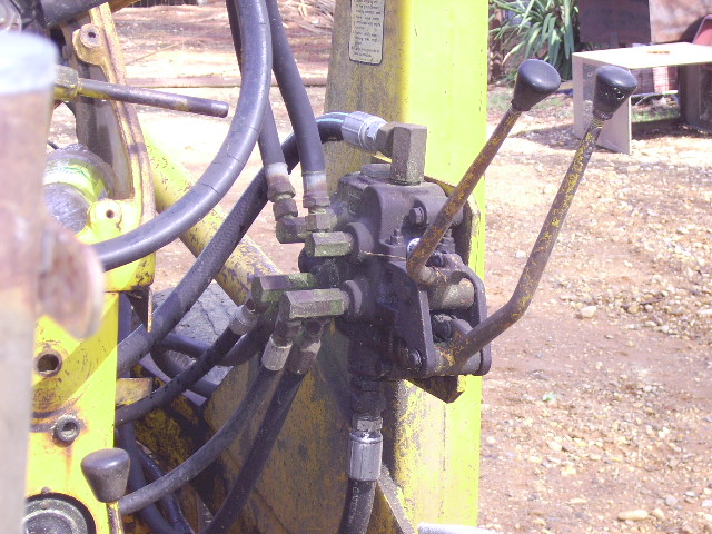

Any chance you can post some pictures? I can't seem find the loader detail in JDparts for this tractor...does the loader have it's own model number?
I am suspecting a bad valve...

Here are a couple pics.If you need other pics just let me know.

I'd remove the handles and pull out the spools.... put new 0-rings on and see if that will solve the problem. The condition of the 0-rings may give you an idea if that is the problem.
Cheap and easy to try, just need to match up the 0-rings.
The valve block may have some tell-tale numbers on it too. And your friendly Deere dealer should be able to help with parts.

I doubt that valve has O-rings. Most are just machined spools they are lapped to fit into the body with very close tolerances. A new joystick valve is $200 and might be the best solution.

Well I took it off and looked it all over.Washed everything and put it back together and all is OK.I guess there must have been something in it I didnt see and a cleaning just took care of it.A good cleaning helps a lots of things.

I cleaned the control valve block.
