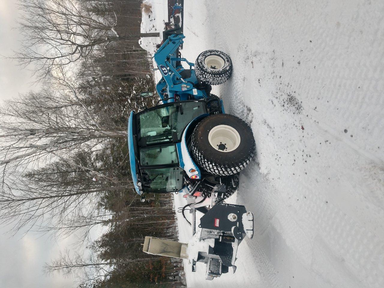

And a scut goes about 8mph? Is this enough speed for this type of blade?
You'll push snow but it won't curl as it would mounted on a truck.
Also when loaded it will want to push your front sideways, so much so tour front wheels might suffer.
(I run a 60 inch on my CUT)
I had mine manually angled but modified it to straight push with side wing.

One thing you might run into, if there's enough ground roughness to catch your blade, is the front wheels rising up. The problem is that the loader arm pivot point on the tractor is up high, somewhere around operator height. On a purpose-built dozer blade mount, the pivot points are about as low as they can get without hitting the ground, so the floating blade force pushes almost straight back on the tractor near the bottom. With your loader floating, the force pushing back on the tractor is partly upwards and is several feet above the ground.
I guess another thing is that loader frames are bigger than dozer frames, and longer, so the down force when floating may be more than you want.
But, hey, if it's working for people, it's working for people.
   / loader snow blade on scut, yey or ney? #25
Most "factory built" front snow plows don't have "float built into the plow itself" or very little;most coverted truck plows "do" have built in float via a chain.Much easier to float the plow and not the FEL.

I mounted my rear blade on a SSQA adapter plate (see link) and use it for light snow plowing and back blading where the blower cannot get to easily. I have not pushed deep heavy snow so cannot comment on how it works on a dumping of snow. A thick wall plastic piping from a gas/oil well was added to the edge as I have gravel. I do not go fast and know my area so hope a trip edge is not crucial.
https://www.amazon.com/gp/product/B07449SDC5/ref=ppx_yo_dt_b_asin_title_o04_s00?ie=UTF8&psc=1
For $200 delivered is has been a worthwhile addition. A "proper" FEL mounted blade is about $2500 so a huge savings.
