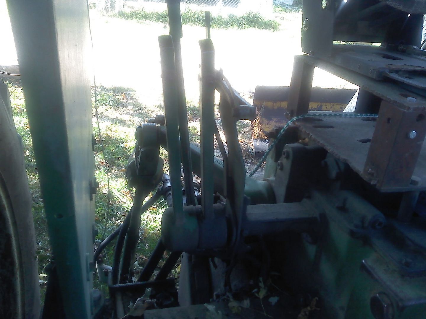

I cant find my digital camera i will take some with my phone. No i have two levers next to my seat, one controls my up and down on my main rams, The other controls my curls, like i said my system is alot older then most of these forums, i will have to get some picts in the am.
I was thinking if i got my self one of those multifunction controls like you got, then again i cant i dont have live hydraulics.

Try to post photos of your controls. There are some real talented folks here who can likely help you once they understand what you are dealing with.
As a thought, does that Oliver have a place on the engine where you could mount the truck's old plow pump?
Another thought in the pto pump idea is the used market. I lot of folks convert pto pump driven backhoes to direct connects. There must be a pile of those pumps somewhere... ?

This photo shows the controls for my remotes.
The controls in the back control the pto and the three point lift.
The next two photos show the remotes.
