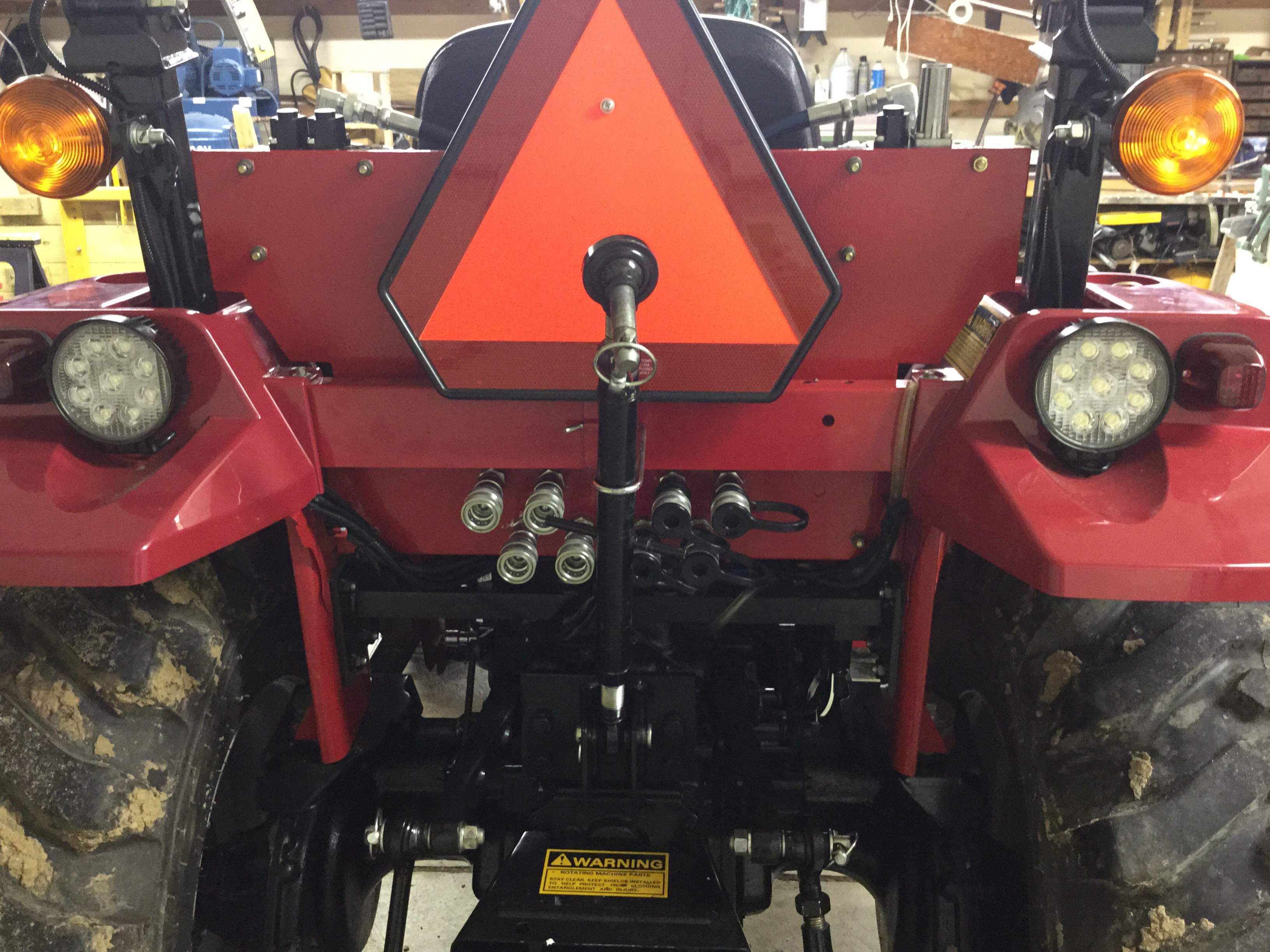

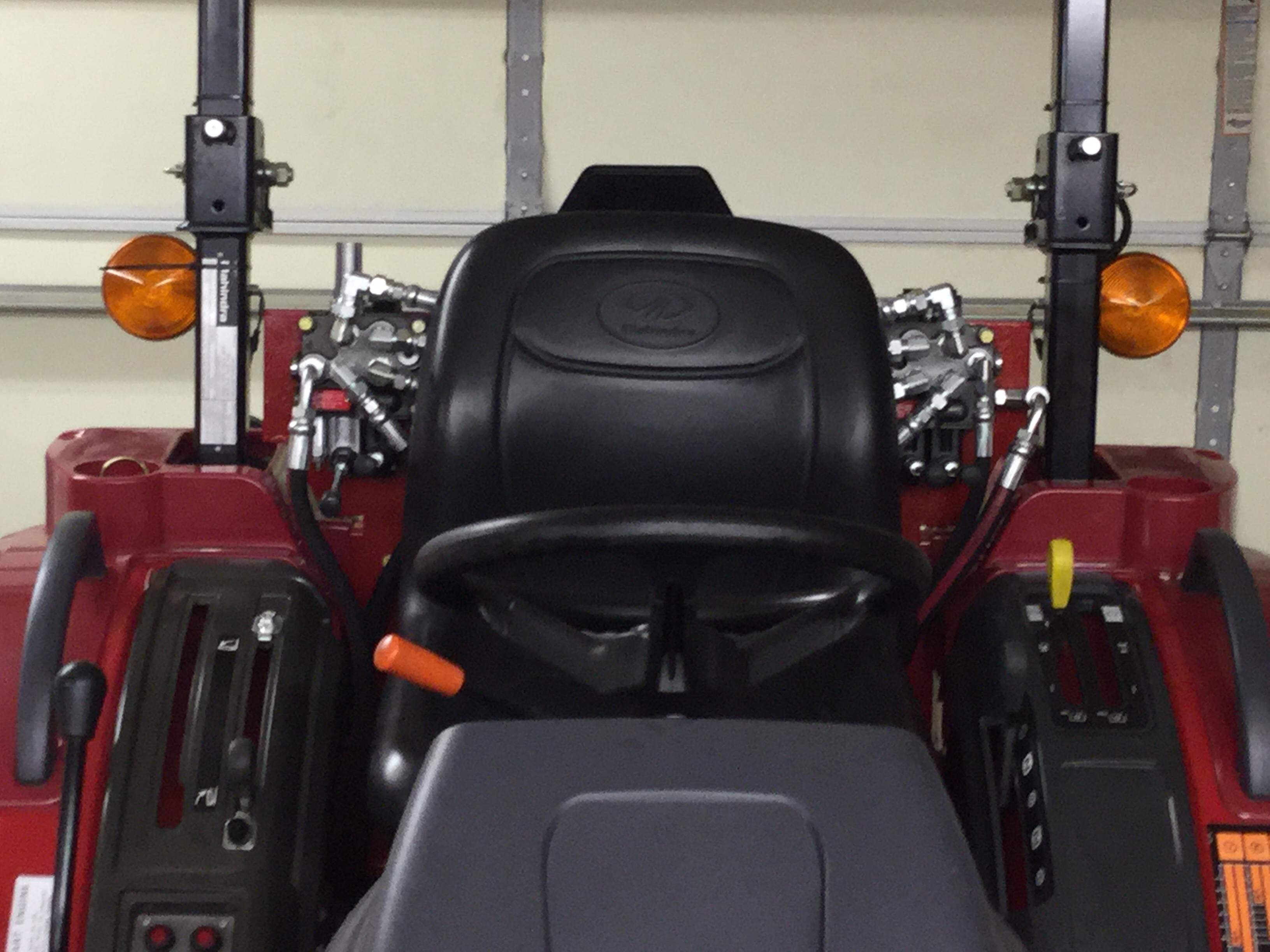

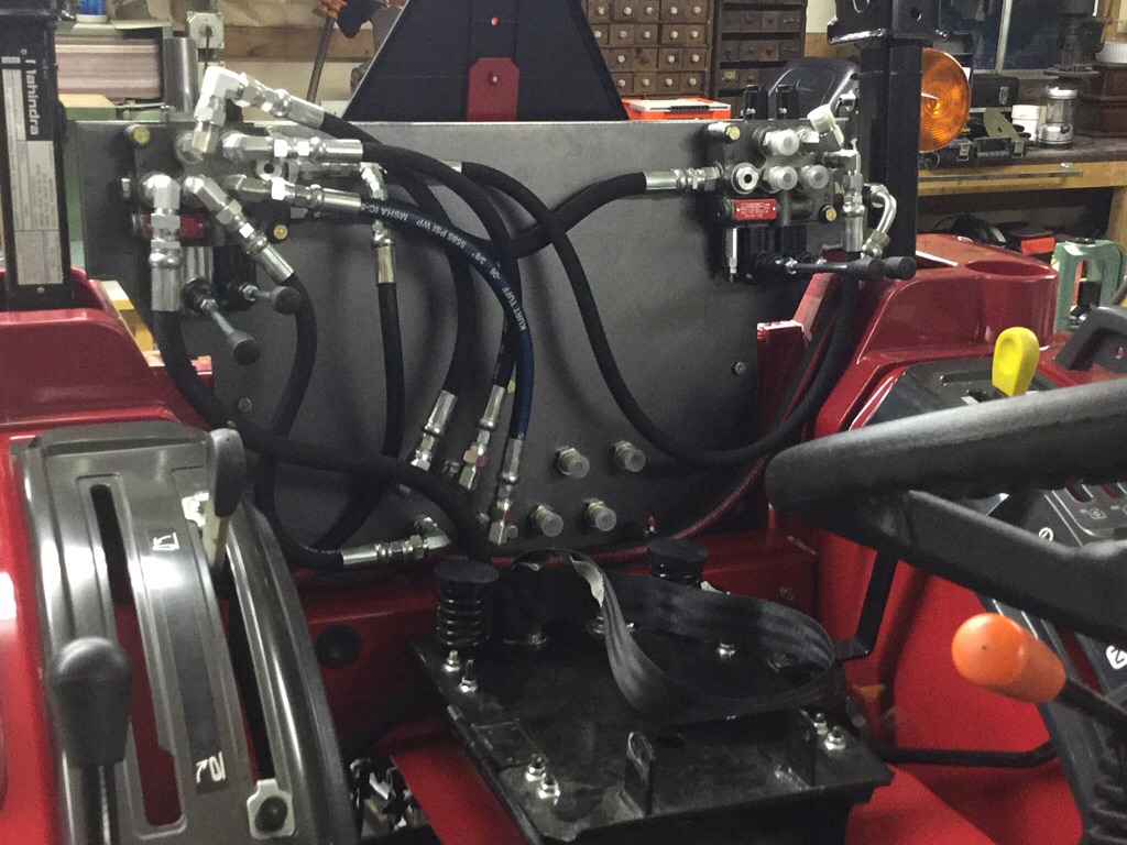

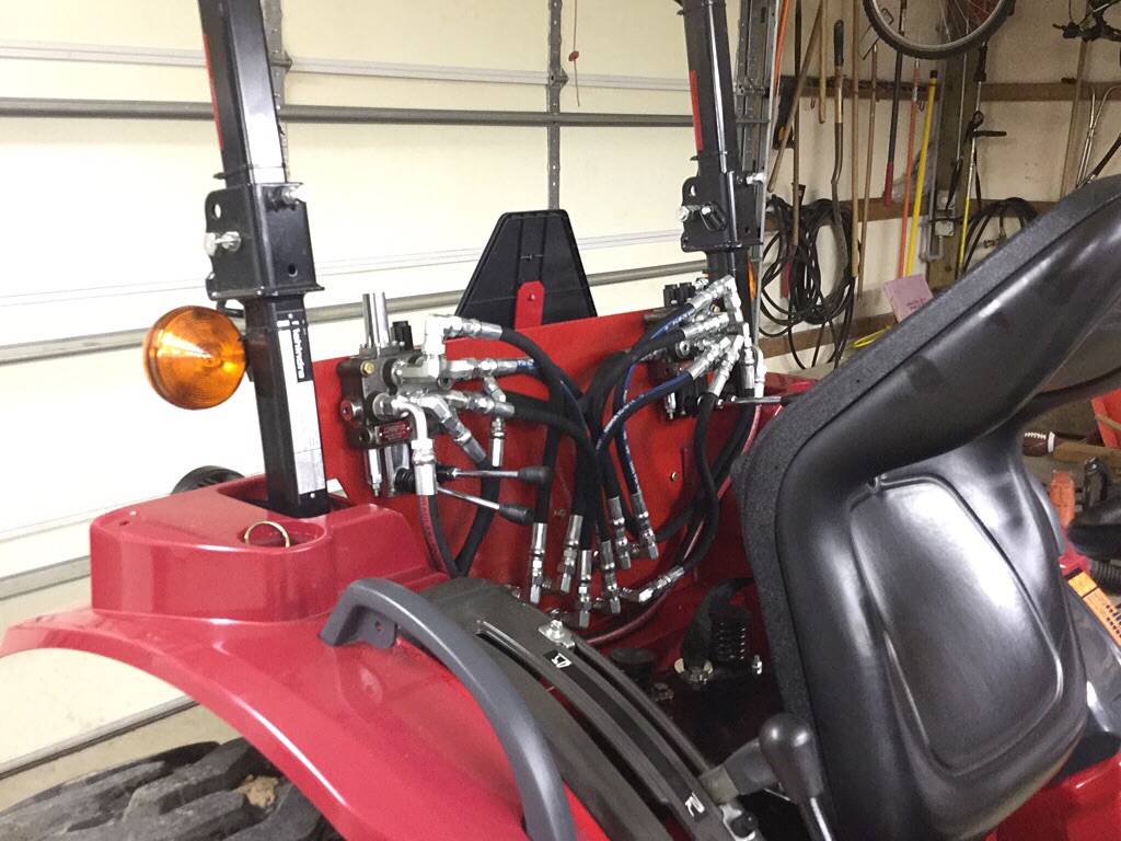

Adding rear remotes.

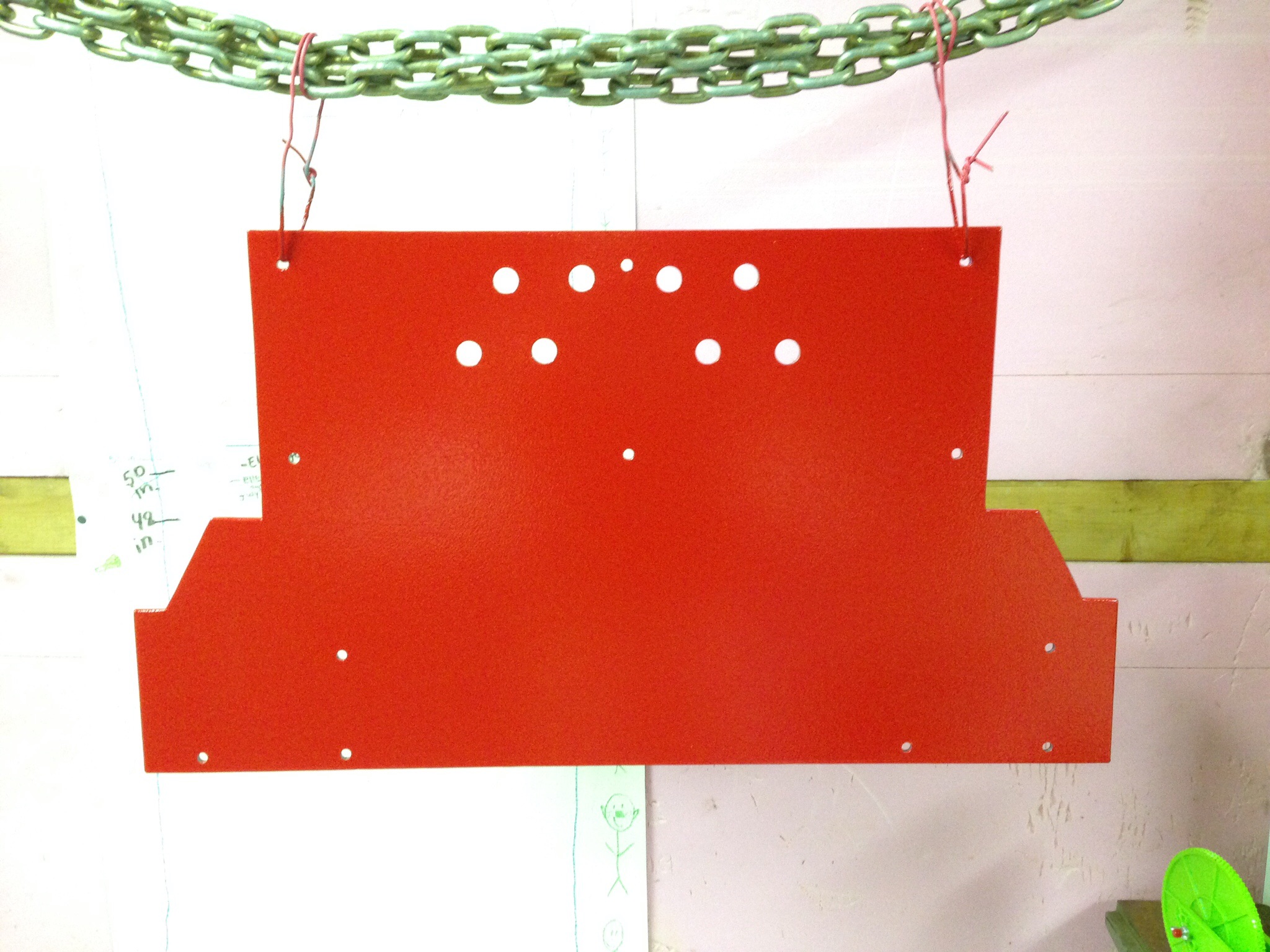

I am dry fitting it all together. I miscounted on some of the fittings so I am waiting for another order. It's a good time to paint the mounting plate.
   / Loader Valve plumbed with BYO, although no remotes
#22

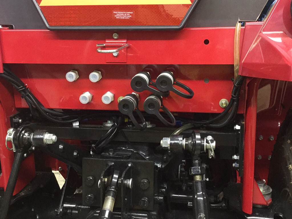

Re: Adding rear remotes.
I finished painting and assembling it all. Everything seems to be working ok. I just have a couple of leaks where the qd's thread onto the bulkhead fittings. I used plumbers paste and really cranked them down so I don't understand why those would be leaking. All in all a this was a fun project and I learned a lot.
   / Loader Valve plumbed with BYO, although no remotes #23
if they are NPT threads, they are designed for a few tightenings. You distort the threads every time you tighten them. Well used NPT treads might leak even with thread dope.
Thanks and Yes it's the only NPTF threads on the entire install. They are difficult to get to to tighten. I have to disconnect them, remove them and bring them over to the vice to tighten. Oh well I'll get it done. I have one jic fitting that was existing on the tractor that I hase been leaking a drop on the floor overnight. I have been tightening that one an eighth of a turn a day. After the last turn it seemed to have made it worse so I am wondering if I could have over tightened that one. Any suggestions?
   / Loader Valve plumbed with BYO, although no remotes #27
Either get a new hose or a new fitting on the old hose.
Switch to JIC fittings.

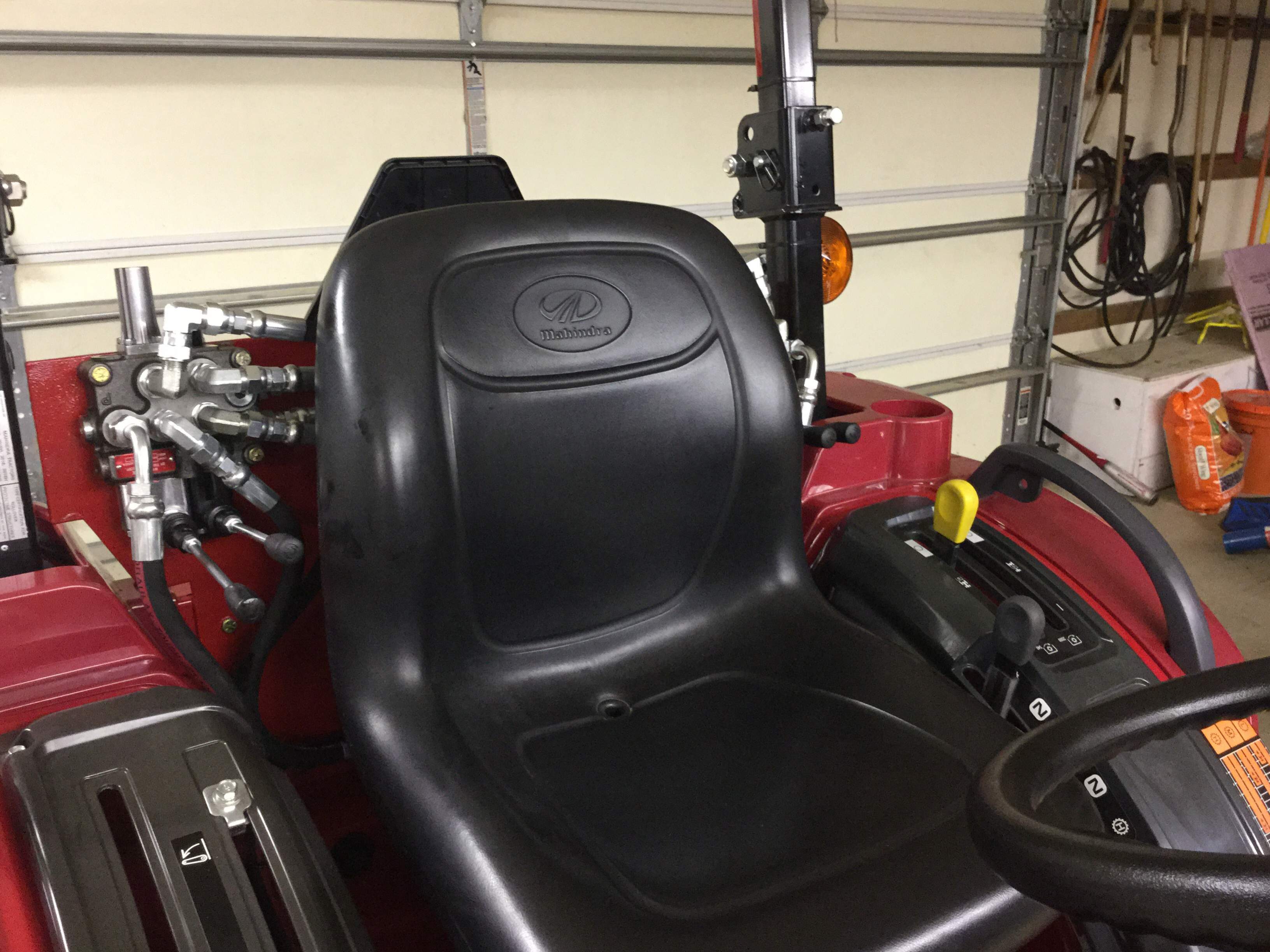

Hey 2funkids, sorry for pulling up such an old post but I was wondering if you had any hose clearance issues where your remotes are located behind your seat when you raise your 3 point? I have a 1526 and am adding a top and tilt, thought that looked like a great place to put remotes!
