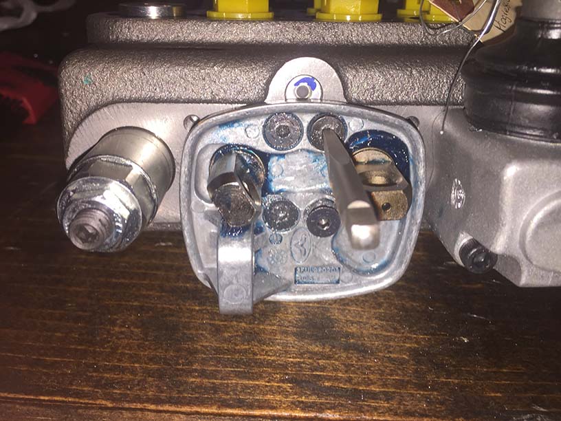

Thanks Dave, I found a technique that worked on one. Now if I can duplicate it 2 more times.
I am drilling the center out to make a deeper seat for this extractor. I had to grind the tip of the extractor to get a tight fit then I use the trusty old hammer and drove the extractor till it bottomed out. If it worked once surely it will work two more times? Let's hope!

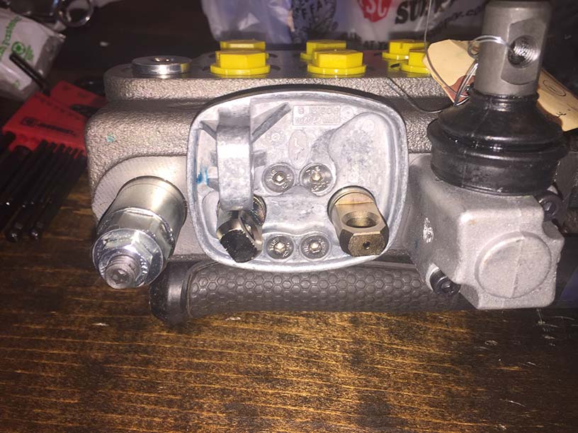

Success!! Thanks to ACE hardware for having the perfect replacement Stainless Steel screw, the valve will now work in the proper direction! The new screws are a little longer that fit perfect. They bottom out at the same time they snug the plate up. No Locktite needed! :cool2:

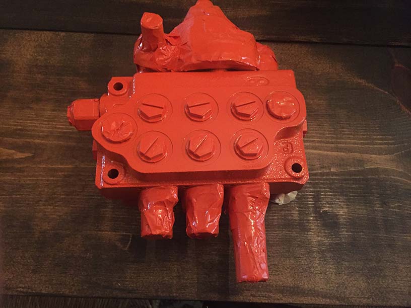

I used Kubota orange on the valve that will be mounted on my Kioti. Think I will get sued? :laughing:
