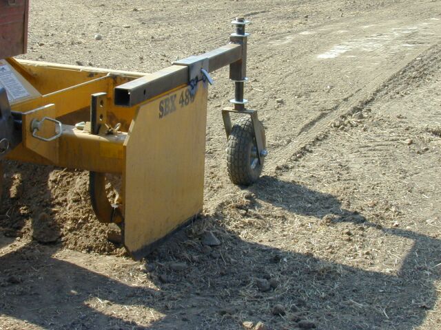

Anyone try the Level Best for grading ?
I only just found it on ATI's web site, having searched for 5 days.
It looks expensive, although as with most pro tools it probably pays off quickly if used frequently.
http://www.level-best.com/
Any idea on price ?
/ LOADER VS. BOX BLADE #36
Wow, looks like a Box Blade with Guage wheels /forums/images/graemlins/cool.gif /forums/images/graemlins/smile.gif
/ LOADER VS. BOX BLADE #37
I like the last pic showing the Draw bar opition, Thats what I thought about building for my box blade just had not got around to it.
/ LOADER VS. BOX BLADE #38
Sure enough, it IS "a box blade with gage wheels" (-:
I was as interested in the laser leveling part of it.
Given some of the claims in other threads; maybe the laser, controls, hydraulics, ..."automation", etc. might not add as much in function as they do in co$t. Credits and congrats to the inventive folk who have been adding gage wheels to box scrapers, rakes and rear blades. It is simpler, easier to deal with and cheaper than trying to mimic the big graders with mid blades. Well, it sort of BECOMES a mid blade.
I had a brief chat with somebody less than a mile from my house about the LevelBest last week-end. He seems to be some sort of part time rep for it, so I'll take a salt shaker along the next time I drop by - but I probably WILL drop by and maybe have him give me a demo (and pricing).
I'll post what I find out.
/ LOADER VS. BOX BLADE #39
Yes, it can act similar to a mid blade. Those of us who have used receiver mounts, or such, have the ability to vary the length of the supports/stingers. When used at full 36" length, they permit agressive cutting of hills, ie, not following the contours closely. When shortened to minimum, the system will follow the contours more closely which, is very good for spreading gravel in an area where there is a several percent slope differential, ie, vertical curves.
