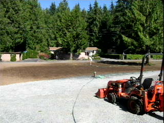

here's a photo of before work with a boxblade. [image]http://[/image]

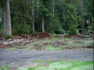

here is a photo of after the boxblade and ready for seed. I think with practice and patience, you can do alot with a box blade.

That's a couple of impressive before and after shots, Steve. I appreciate you posting them.
Did you grade that bank with the box blade too? If so, what is the technique to achieving those profiles?
I picked up a 6 foot Braber blade this morning so will start to set out the new road tomorrow and begin cutting it on Monday.
   / LOADER VS. BOX BLADE #30
George,
I'm not sure what bank you are referring to. My land is relatively flat, It has the usual highs and lows associated with raw land, but there was very little slope to work with. Maybe the picture has a strange angle that appears to be a bank? I have done some work on another property that I graded a slopeinto. You can set the angle of the box to cut in angles to the grade pretty easy.
