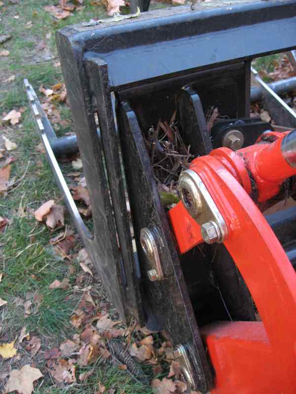

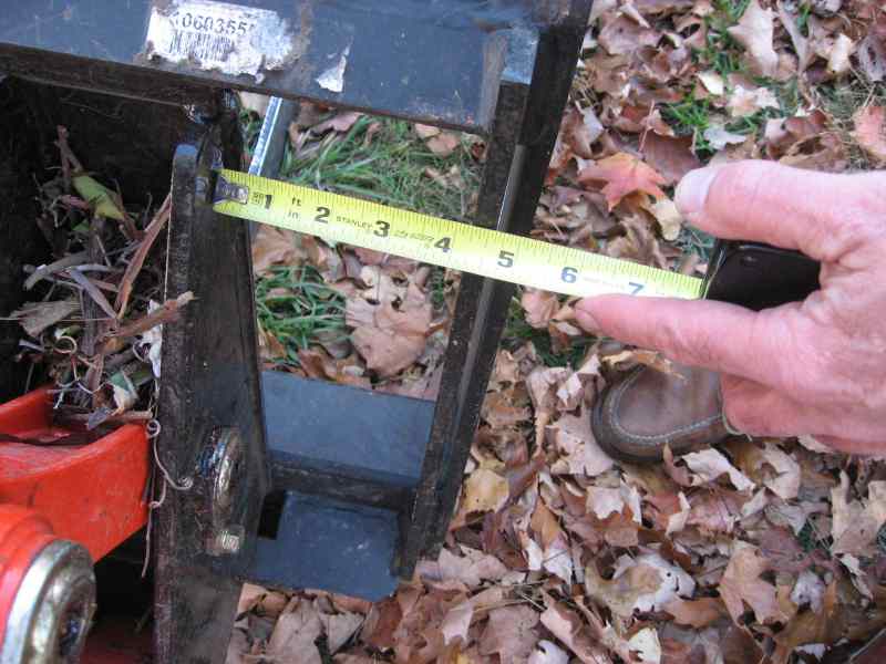

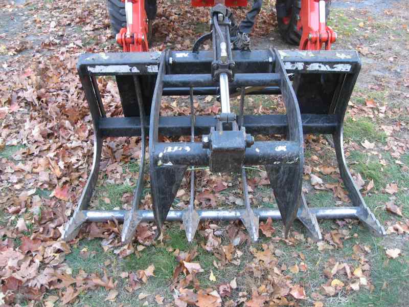

I measured the tractor QA yesterday. The KL401 QA is 40 inches wide. My grapple (Millonzi) is 44 inches. A "standard" QA adapter plate I bought on eBay is 45". There is clearly some variation in "skidsteer QA" attachment plate sizes but I've never seen anything as small as the Kioti's 40 inches.
There is a full 4 inch gap at the moment on my grapple as it has managed to get itself pushed all the way over to the left side. It works fine but is lopsided. You can see the gap on the right side (driver's perspective) in the photos.

There is a fairly simple solution that any full service dealer could implement for a couple hundred bucks. First woudl be to simple weld a couple of 2 inch spacers to the outboard side of the KL401 attachment points, that would give you 44 inch width. The next thing you'd need to do is to weld on a standard QA adapter plate to the Kioti bucket so your new "standard" width KL401 would fit the Kioti bucket. After doing that everything would be hunky dory.
