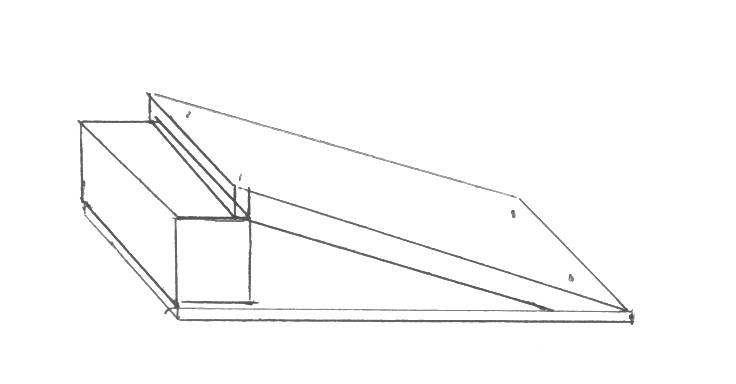

All of these ideas will work. But it seems to me like you'll put much effort and money into constructing them and that they'll be difficult to transport. I would return the aluminum ramps and get the brackets Eddie mentioned and mate them to a couple of long 2x12s. Cheap, easy to use, easy enough to transport, and available anywhere. Couldn't take more than 30 minutes and $60 to put the whole thing together...
Only problem with 2x12's is if it's wet or some mud on the wheels. The metal ramps have some nice grippers.
/ Loading a riding mower #25
Some old roofing nailed to the planks really helps with the traction. No old roofing? Home Depot or Lowes generally has a pack laying around that ripped open and they'll sell it for cheap.
Myself, if I was building the ramp out of wood, I'd use 2x12s, and then run a 4x4 underneath them, with the appropriate bevel cut at the bottom end.
Or, you could use a couple of pieces of 2x12s (or 2x8) of the appropriate length, coupled with a set of good hinges to make a swing down leg in the middle of the 2x12. This will keep the long 2x12 from bending quite as much in the middle.
I drive my lawn tractor up and down a 30 degree slope in my yard going forward. I can back up it, but don't want to even think about backing down it.
Why not buy a used utility trailer? I see them all the time in the $100-$150 range on Craigslist. I know, a truck alone is much easier to handle.

Don't want to drag around my 18' trailer I use for my tractor, and I just acquired a new riding mower. Also bought some arched ramps for loading it into the bed of a pickup. I've got some ideas, but does anyone have a sure-fire way to make loading and unloading it a one-man operation?
Since you've got the ramps, just get a small boat winch & rig an attachment to the front of the pickup bed. Piece of plate a couple of holes & some captive nuts would do it , then just two bolts (use T handles & the winch is fitted or removed) I load Wheelhorse C series ( much beefier than modern rideons) onto a breakback trailer like that, & a simple non geared winch does the job fine.

UPDATE: I fashioned a harness out of heavy rope and looped them around the frame next to the wheels. Attached the hook from a come-along with a long cable (standard looped cable will not be long enough). Ran a chain between the bottom tie-downs at the front of the bed, then attached the hook at the end of the cable to this, and started ratcheting. Worked great.
