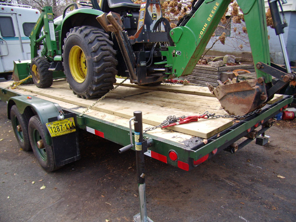

I put some jacks on the back of my trailer. They are removable or can be swung on the pipe holder for storage. :D

I used box tubing to make drop legs for my trailer. Five years of use with no problems. Notice with the empty trailer the legs are a few inches off the ground. These drop legs will contact when loading but should rise back up enough to remove them from a bind when tractor is positioned on trailer for transport. I have multiple holes in the inner tubing for adjustment too.

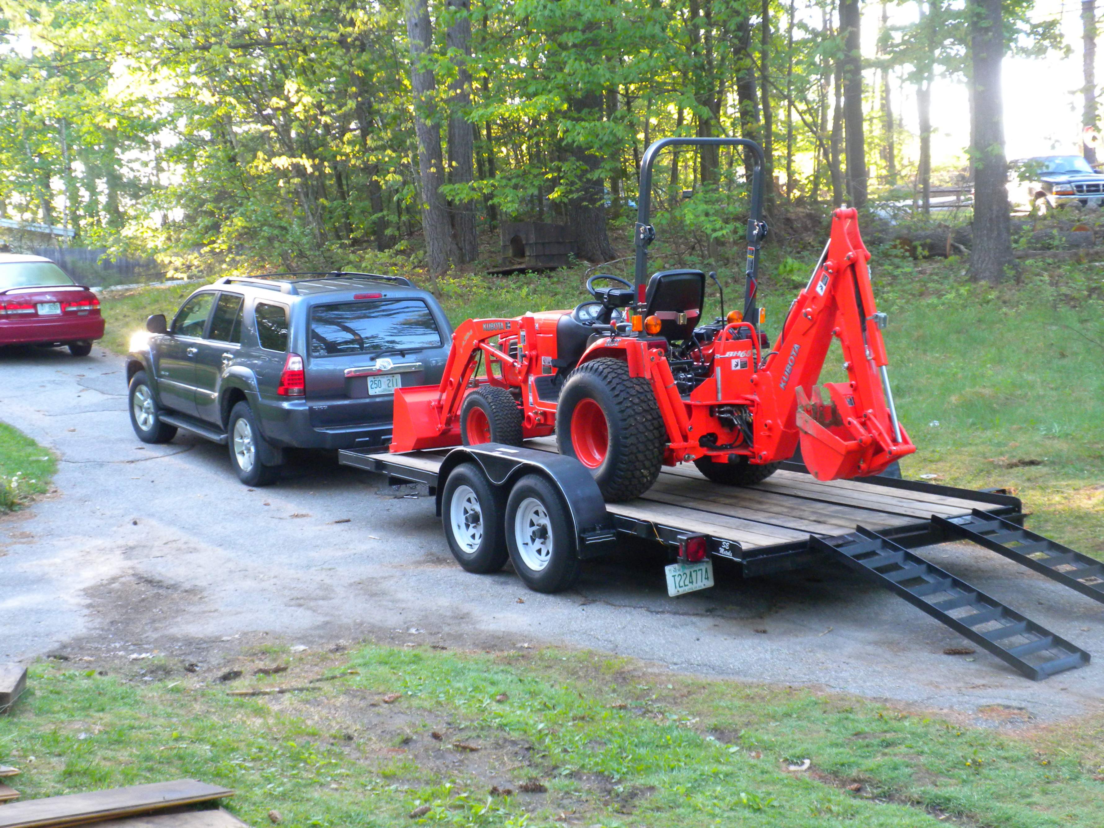

I see where you're coming LB from but my trailer does the same thing....it has nothing to do with not enough tongue weight but all to do with all the weight of the tractor on the tail while driving the tractor on (therefore lifting the front of the 16' trailer up due to leverage), my trailer ramps do not have the legs under them so the all these suggestions of adding corner jacks and brace legs are welcome to my situation also.....
Once loaded and the tractor balanced properly, it has excellent tongue weight and trailering stability, I know my trailer is lighter than most but it fits my pulling rig and tractor awesome.....:thumbsup:
Maybe the OP's problem was balancing properly, or just while loading.....
