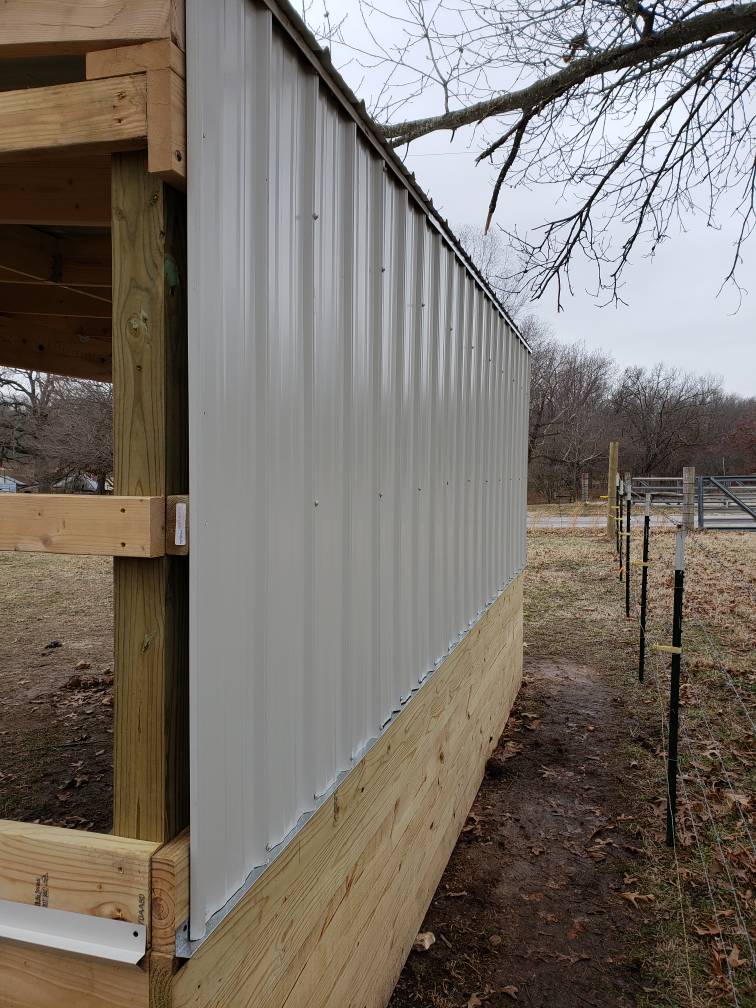

Rat guard serves two purposes; provides a shelf for the bottom edge of the metal siding to sit on and keeps pests from entering. I use it as a shelf for the siding. Here is a close-up picture:View attachment 589112
If building a metal sided building on a slab (either with post brackets or studs) you could also tack an extra piece of 2x on the top inside of the forms to leave a similar rabbet for the siding to overlap down into past the top edge of the slab to close off all the rib ends. Backfill the ribs on the inside with grout if desired.

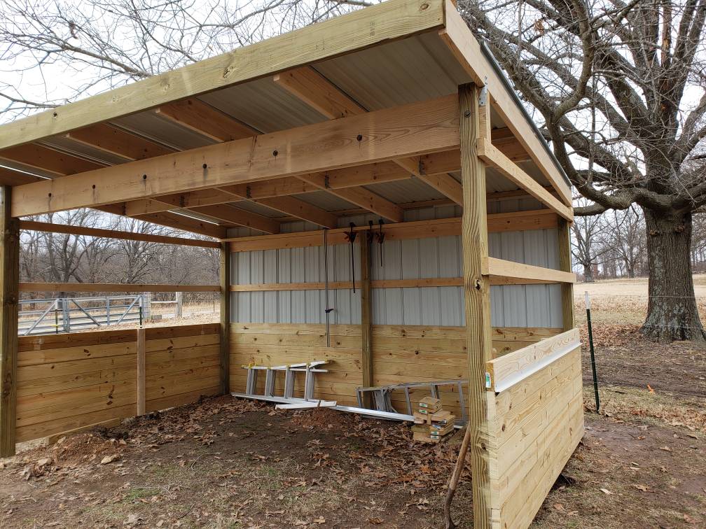

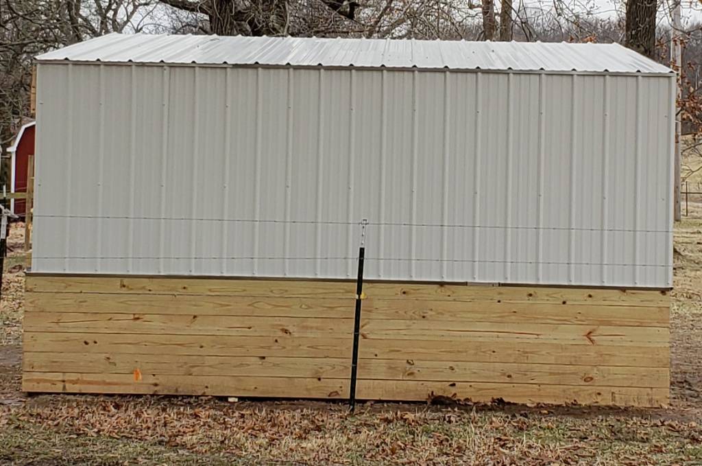

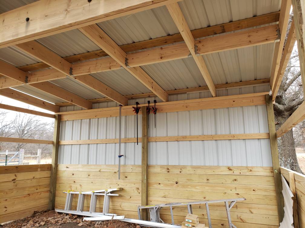

Day 7: First....a correction...I decided after my first post to increase the height of the rear wall to 7' instead of 6'. Can always use the extra head room.
Today, I decided to add one more board to all three sides of the wainscotting so it is now 38.5" tall. This will save me one sheet of siding.
Installed the rear panels using 10' panels cut into 2 pcs that are each 5' tall. This worked perfectly....just had to reposition the rat guard.
Really happy with how the panels lined up and how the top of the wall met the roofline.
Will work on the side walls tomorrow. 20190202_134428.jpeg20190202_131517.jpeg20190202_131540.jpeg20190202_131458.jpeg

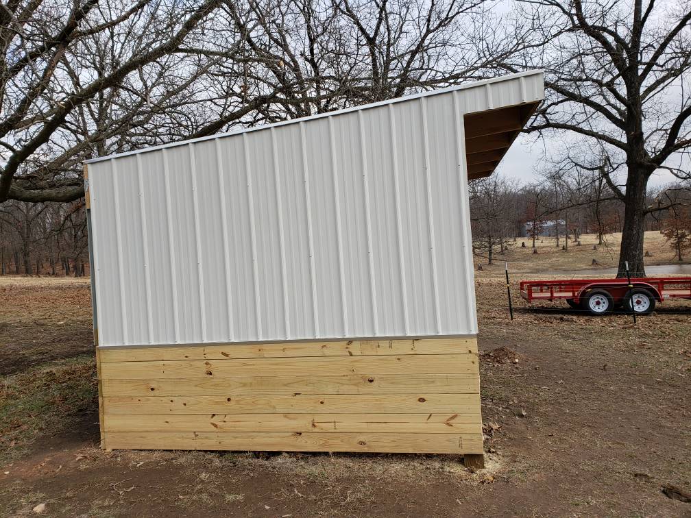

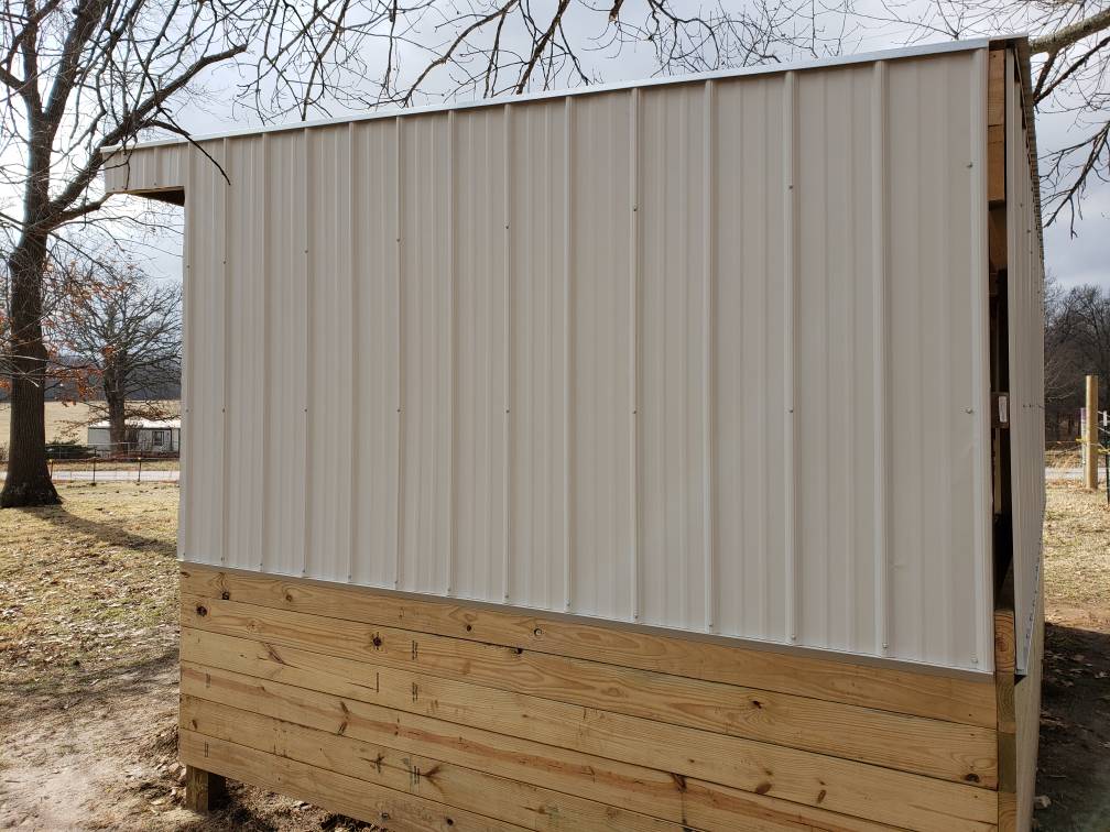

Day 7: Today I installed the side wall panels. To get the angle right, I placed a piece panel in place (over the J channel) and the traced the cut cut line on the backside of the panel using the J channel as my guide.
Toughest piece was the very last piece on each side which was the last foot at the front and the roof overhang. Lots of tedious cutting. 20190203_134930.jpeg20190203_134908.jpeg
