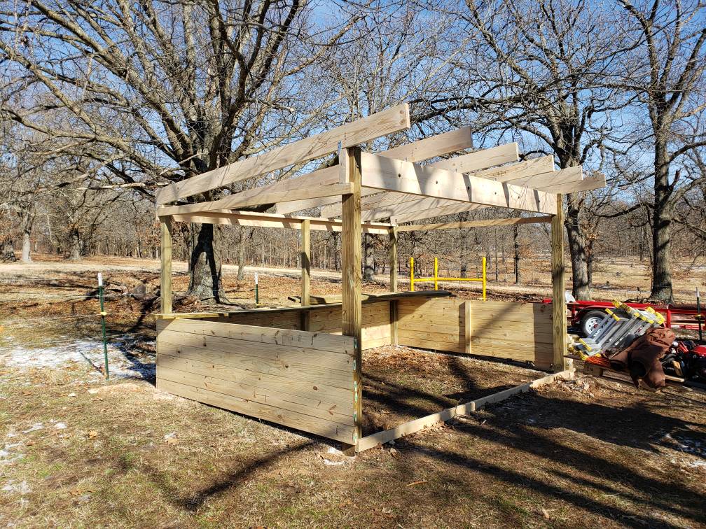

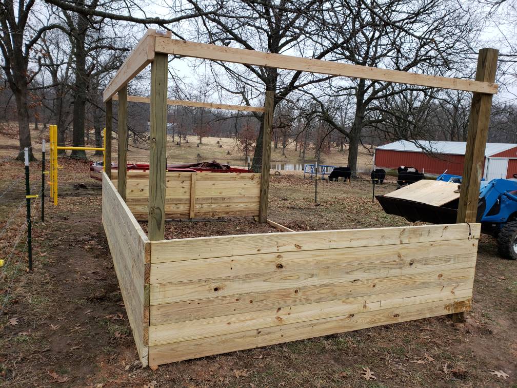

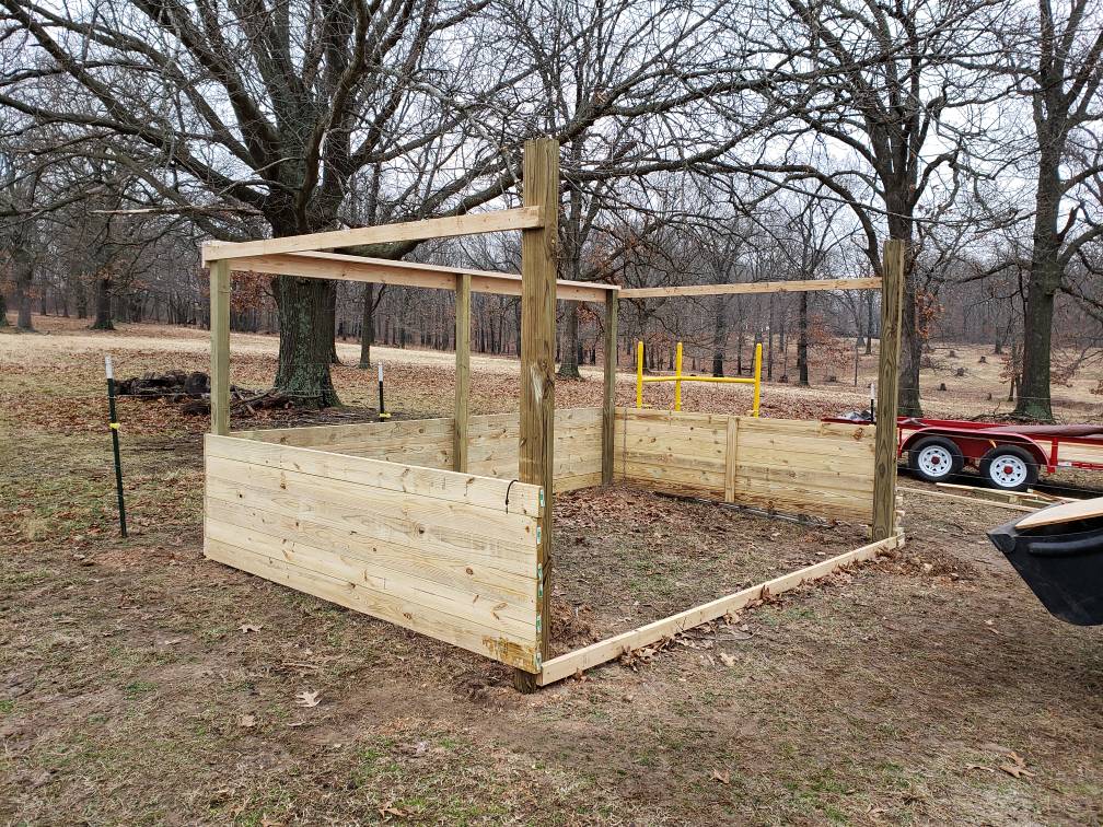

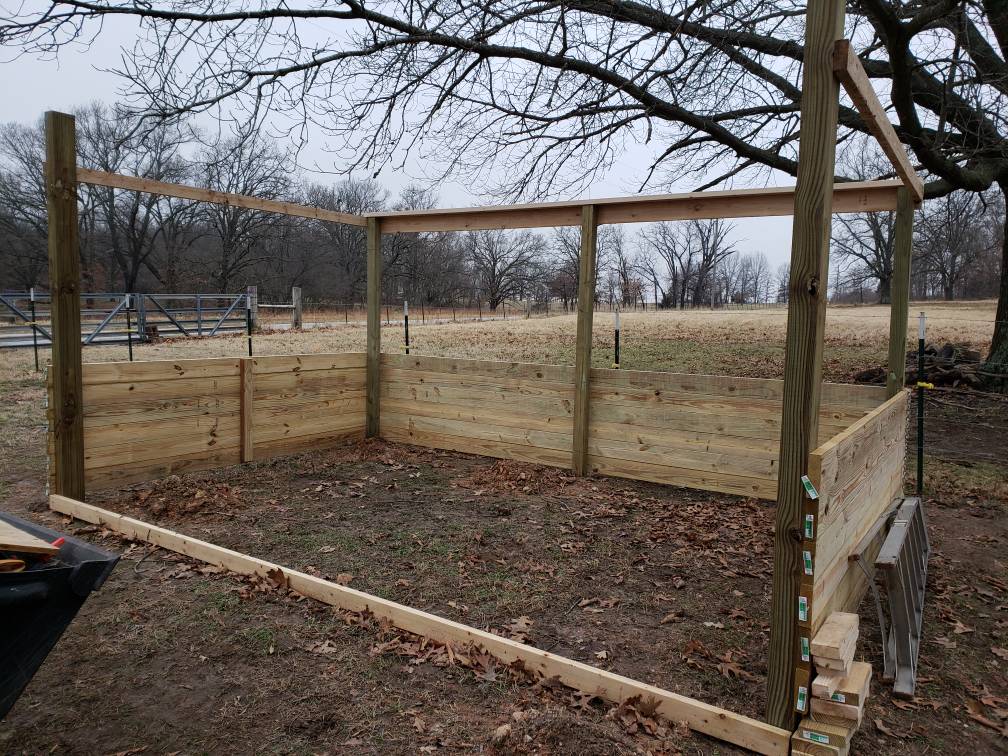

Day 5: Started off the day with a trip to town to pick up the metal siding and some more lumber. Then I decided to remove each rafter so that I could angle cut the front and rear ends....wanted the rear to be flush with the wall line and wanted the front level with a vertical line so that I could attach a fascia board. Finished that and reinstalled the rafters and three purlins. Installed remaining girts on sides and rear wall. Had a little time left before I had to quit so I decided to assemble the rafter joists so they would be ready for tomorrow. 20190126_160022.jpeg20190126_160014.jpeg20190126_155932.jpeg20190126_155909.jpeg20190126_155836.jpeg

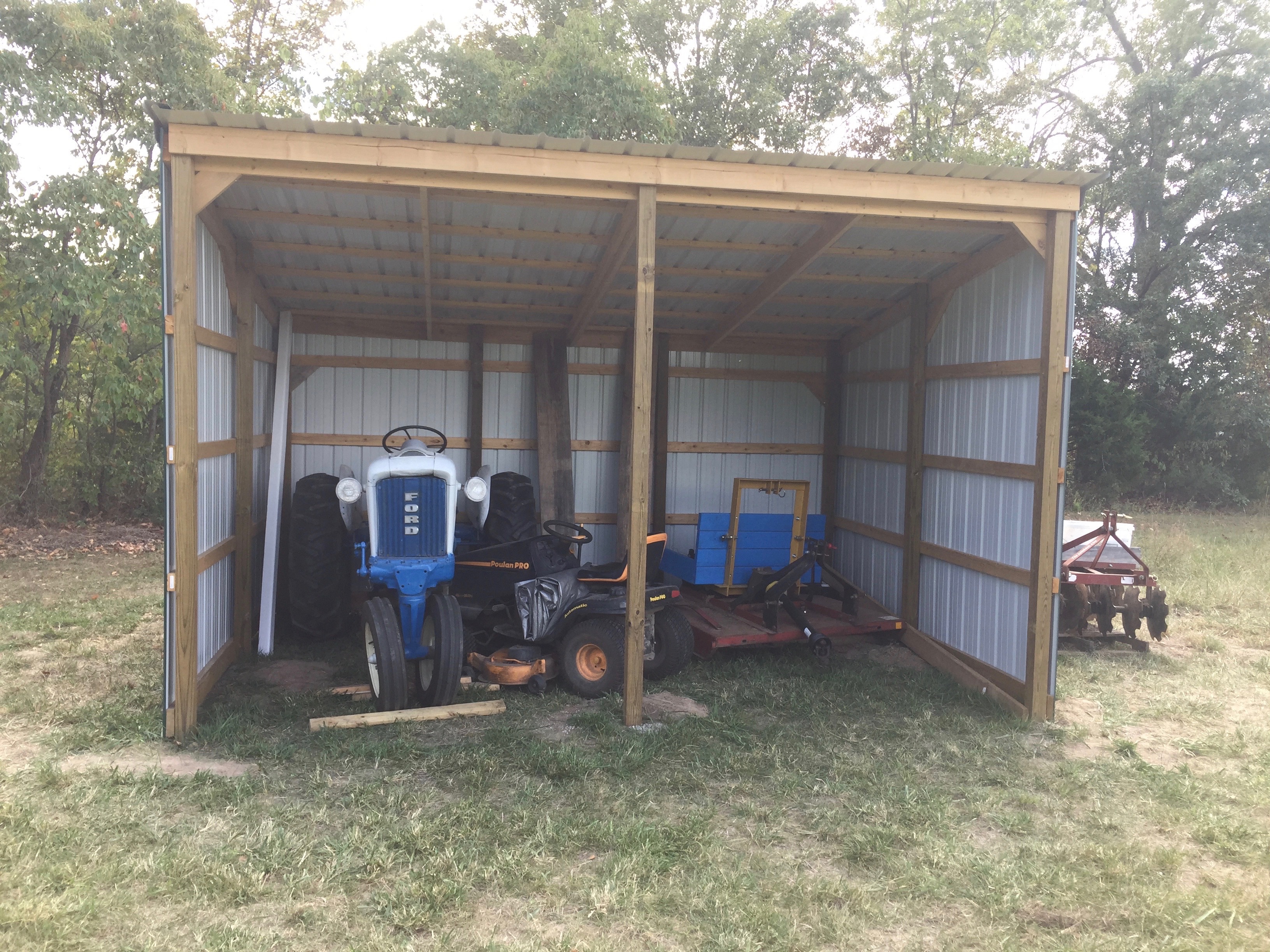

yours looks great! Very useful to have sheds. Here is the one we built last year at the Georgia farm- 30' x 20'. We need to build one this year at the Alabama farm and it will probably be the same design but 44' x 24'

Wow....now that's a beautiful shed!

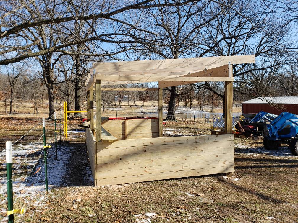

Day 6: Fairly nice day. Started off below freezing, but quickly warmed up and eventually got up to 51 degrees. Started off by installing the fascia on the front overhang. Then installed the rafter joists. Finished that and then installed the roofing panels. Finished up with installing the rat guard along the top edge of the wainscotting and the J channel along the top. Should be ready to install the metal wall siding panels next weekend.20190127_134005.jpeg

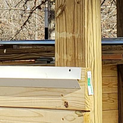

What is a "rat guard"?

Rat guard serves two purposes; provides a shelf for the bottom edge of the metal siding to sit on and keeps pests from entering. I use it as a shelf for the siding. Here is a close-up picture:20190128_101236.jpeg

Rat guard serves two purposes; provides a shelf for the bottom edge of the metal siding to sit on and keeps pests from entering. I use it as a shelf for the siding. Here is a close-up picture:View attachment 589112
Thank you. All of my experience with metal has been doing roofs. I've never installed it on a wall before.
