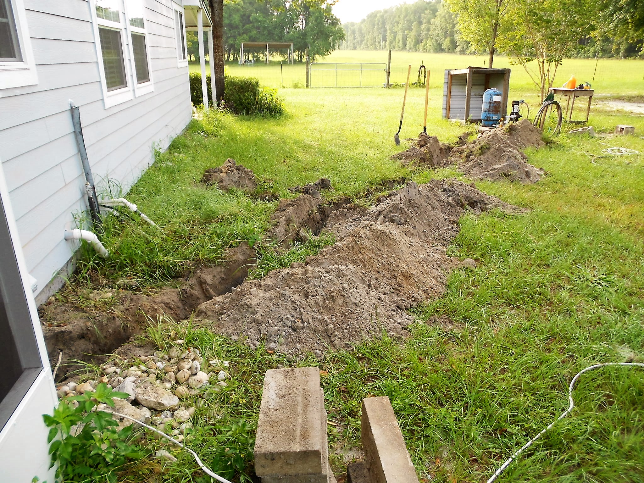

I was trenching power to my new shop and I knew I had to go past the underground service to my house.
I borrowed one of the locators from a friend and it worked great!
You put the transmitter loop on the wires on either end (no connection) then you scan with the receiver and it tells you where the wire is buried.
I hand dug the area, located my service then dug the rest with my backhoe.
You probably need to just replace the whole wire though.
