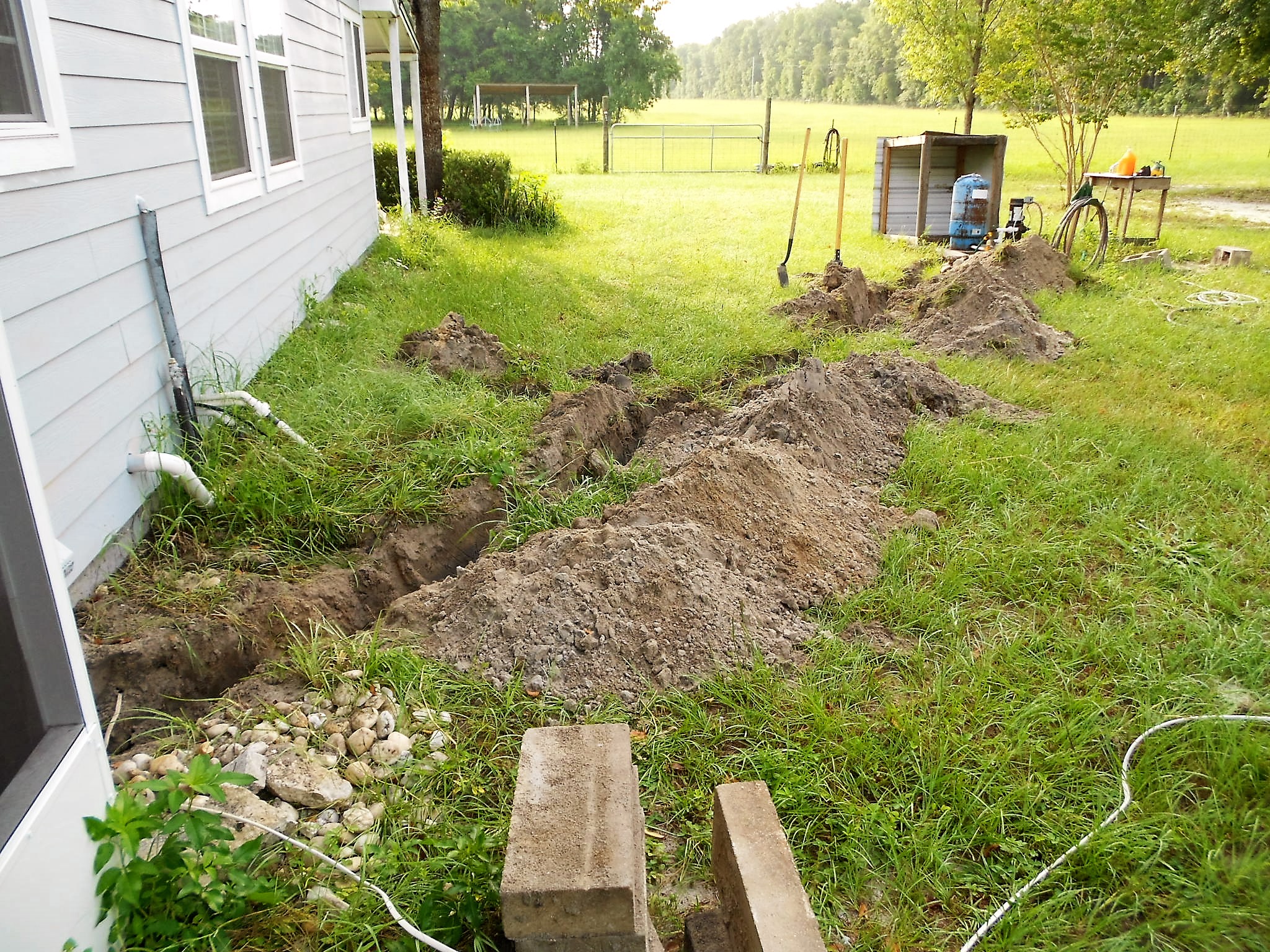

What will probably happen is the fault will continue to bleed and then burn the wires opening the circuit.
Someone buried romex 50' to my water pump before I bought the place.
Water compromised the insulation and the wires burned through and one day my pump stopped.
I had to dig it up and install the proper wiring.
Nice having a Backhoe Attachment!
