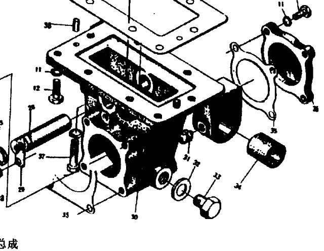

I have seen on this form somewhere that there are three drains when changing transmission fluid. One in the back by the draw bar , one under the creeper box. I can not find a third one. I have opened the two and got approximately 3 gallons of fairly clean fluid. However it does not resemble 80w-90 gear oil nor does it smell like it either. If you know whether there is a third drain I would appreciate your input . Thanks Robby
   / Location of transmission drain plugs JM224 #2
There could be as many as four. Some folks have reported two at the very rear. Then there's the one on the transfer case, and the last one is just forward of that - underneath the creeper box
//greg//
I have two in the rear and one under the creeper box . I do not see anything that would resemble a drain under the transfer case. Robby
   / Location of transmission drain plugs JM224 #4
<font color="blue"> I have two in the rear and one under the creeper box . I do not see anything that would resemble a drain under the transfer case. Robby </font>
Hey Robby,
The drain on the tranfer case, is on the side. If you have allready drained the transmission, then you will not get very much out the transfer case. But it is a good idea to flush with diesel fuel or kerosene, and when you do, remover the creeper and transfer case drain plugs first, to make sure that the oil passages are open. Then finish draining with the 2 drains that are underneath, in the middle, and are inline with the rear axle.

I have 56 hrs on my tractor. I have finally changed all of the fluids in the tractor (highly recommend flushing with diesel upon first fluid change).
I never found a drain plug on the side of the transfer case.
I do not know if this is recommended or not but when I filled the tractor back up with 80w-90 gear I took the creeper box cover off and put most of the fluid through there and watched to make sure that the oil passed through the bearing. Robby
   / Location of transmission drain plugs JM224 #10
</font><font color="blue" class="small">( I never found a drain plug on the side of the transfer case.)</font>
Facing the front of the tractor Robby, the drain is on the left side of the transfer case - that little box that is bolted to the underside of the tranny. From it, the front driveshaft housing goes forward. The creeper drain is partially obscured by that housing. Transfer case drain is Item 33 in the attachment
