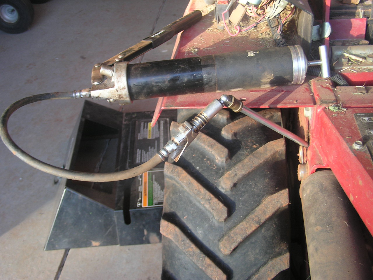

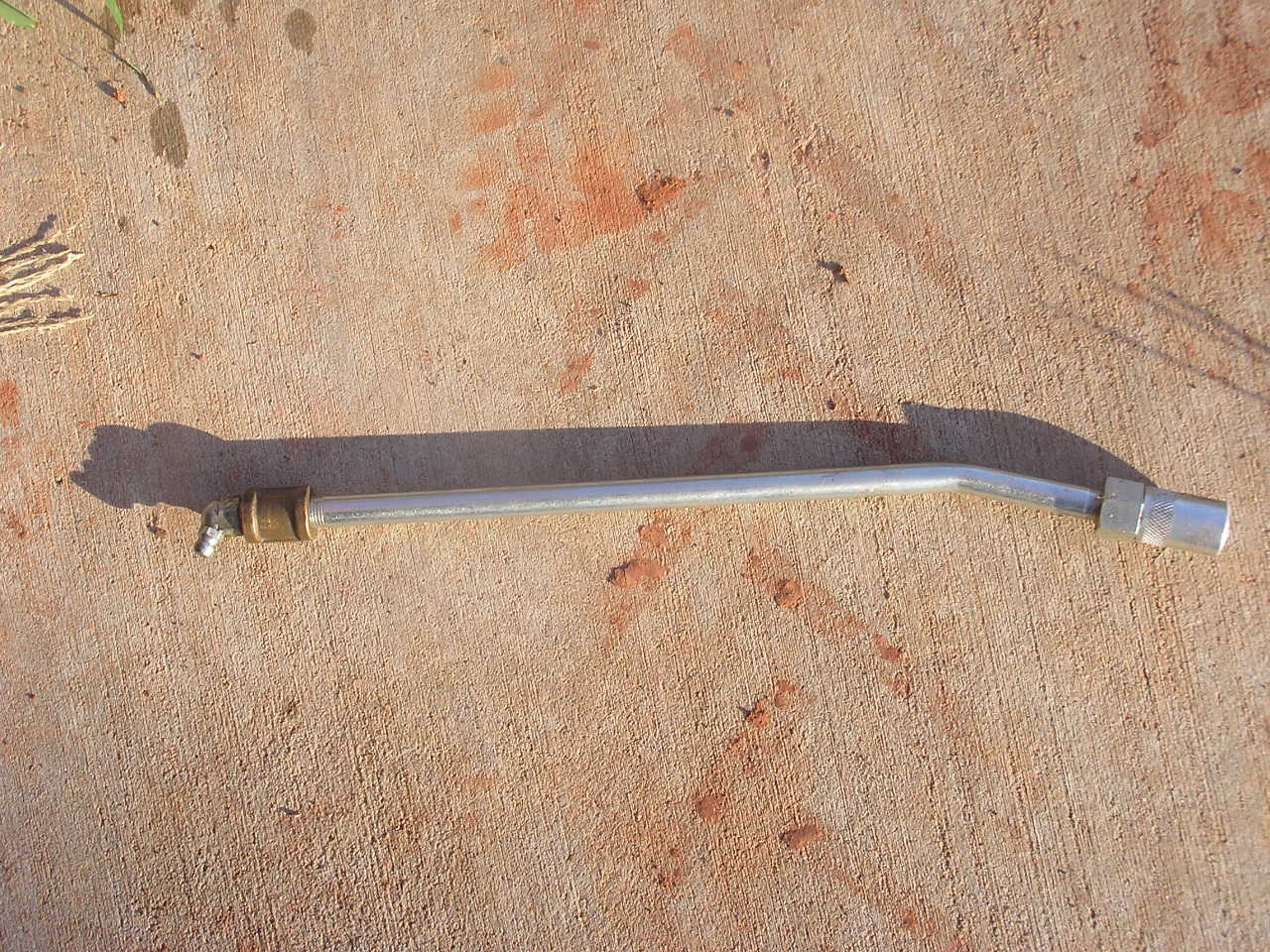

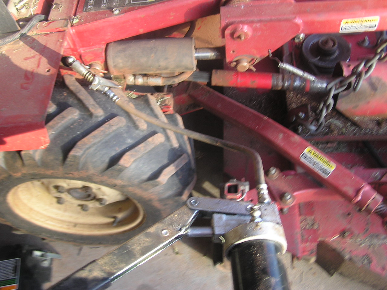

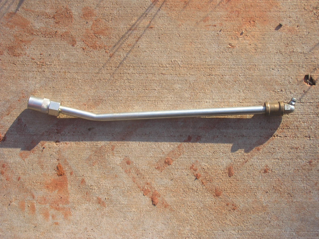

I only have a couple of fittings on my backhoe and my JD loader it won't get on. I have a 8 in hose with a male and female fitting to use on those.
   / Lock n lube grease gun fitting #29
Here is my extender for the one I can't reach:
