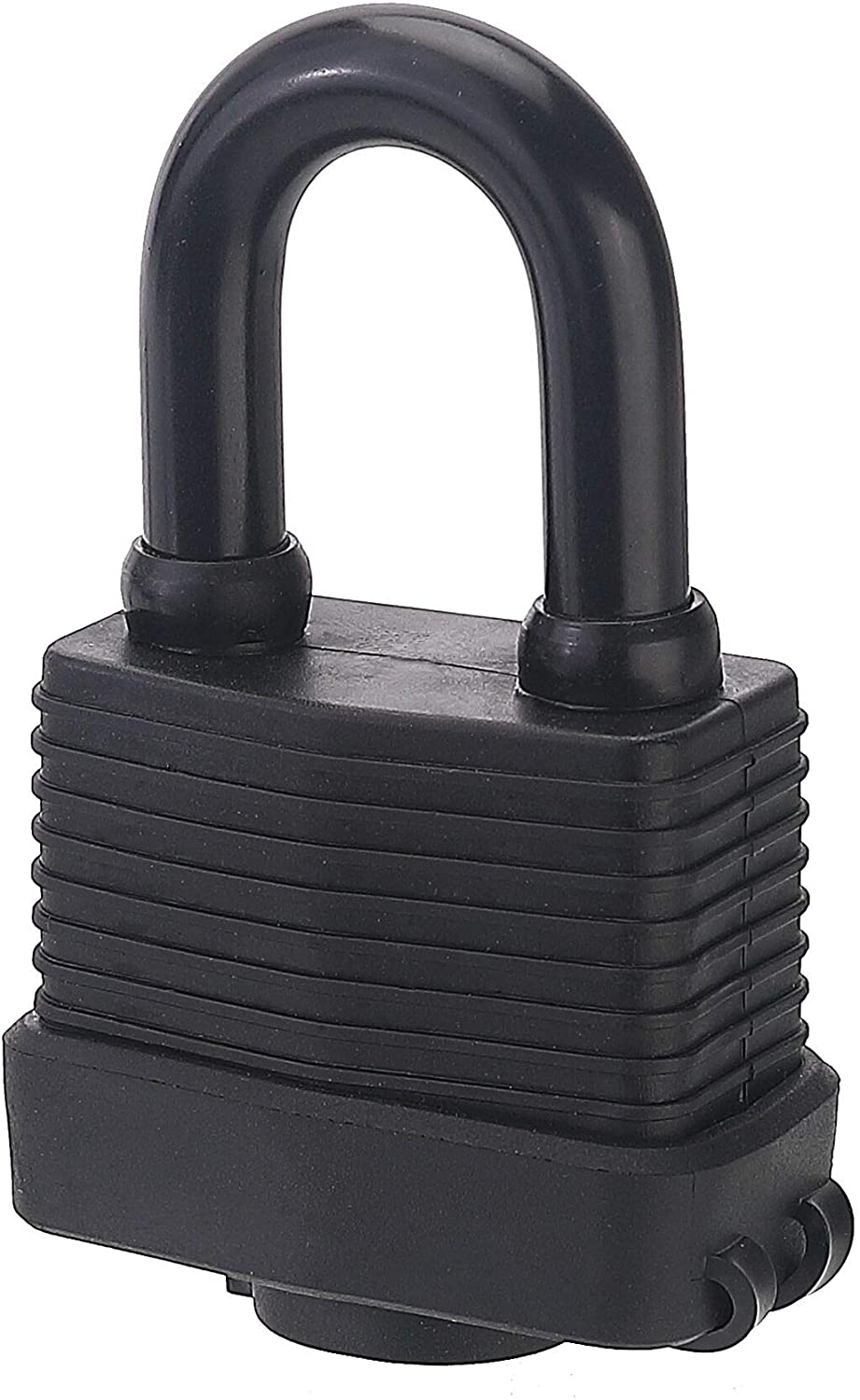

Have you tried rubber coated padlocks that have a cover over the key area like this. waterproof padlock.jpg

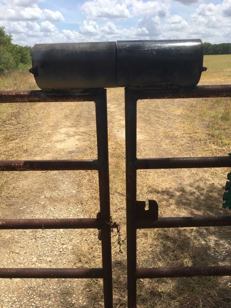

Like this, instead have pipe vertical, capped on top.
Slot cut in each side, flat bar or chain connect the two pipes.
With a lock on 1 side.. or both for flat bar.
Other side can be a tab, bolt on flat bar or whatever to keep it from sliding out.
See no reason it can't be adapted for a single swing gate as well.

You could use the lock like George2615 posted and put a piece of rubber over it with a couple of wire ties ( rubber roofing work good)......

Yes I have, the problem I've had is moisture must condense inside when the temperature changes fast, so after a warm day if it gets really cold at night, the next day it's frozen internally even though it hasn't rained or snowed. Also I don't want any more keys, we have people that work for us who have to come in, there's no way they can keep track of another key.
