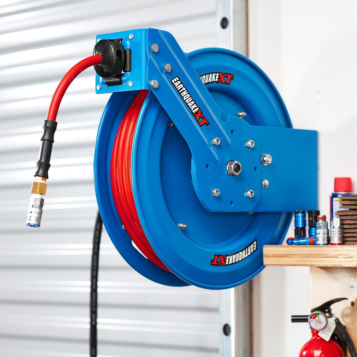

I use the same approach for compressed air. Instead of running pipe around the shop, I use this hose reel:
It can be mounted to the wall, floor or ceiling. I have mine mounted near the door, so 50' of hose reaches the entire shop and outside as well.
