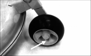

I was so glad to find this thread - just ordered a one for myself.
The thing that I grease most are the guage wheels on my mower deck:
<img src="http://www.tractorbynet.com/forums/attachment.php?attachmentid=375284"/>
In order to get the zerk in the correct position, they have to be up off the ground enough to turn them. But then when trying to attach the grease gun (flexible hose - pistol type gun) the wheel turns and can't keep the proper alignment.
This Lock N' Lube should alleviate that problem.
It certainly did that for the wheels on my Farm King finishing mower. They were a real pain to grease but the LNL solved that.
Even worse was the brake linkage on my DK35. It requires lying on your back, threading the gun between other parts, and trying to keep contact while pumping the grease. It's still a challenge to get the LNL on but once it is there you don't need to worry about it coming off.

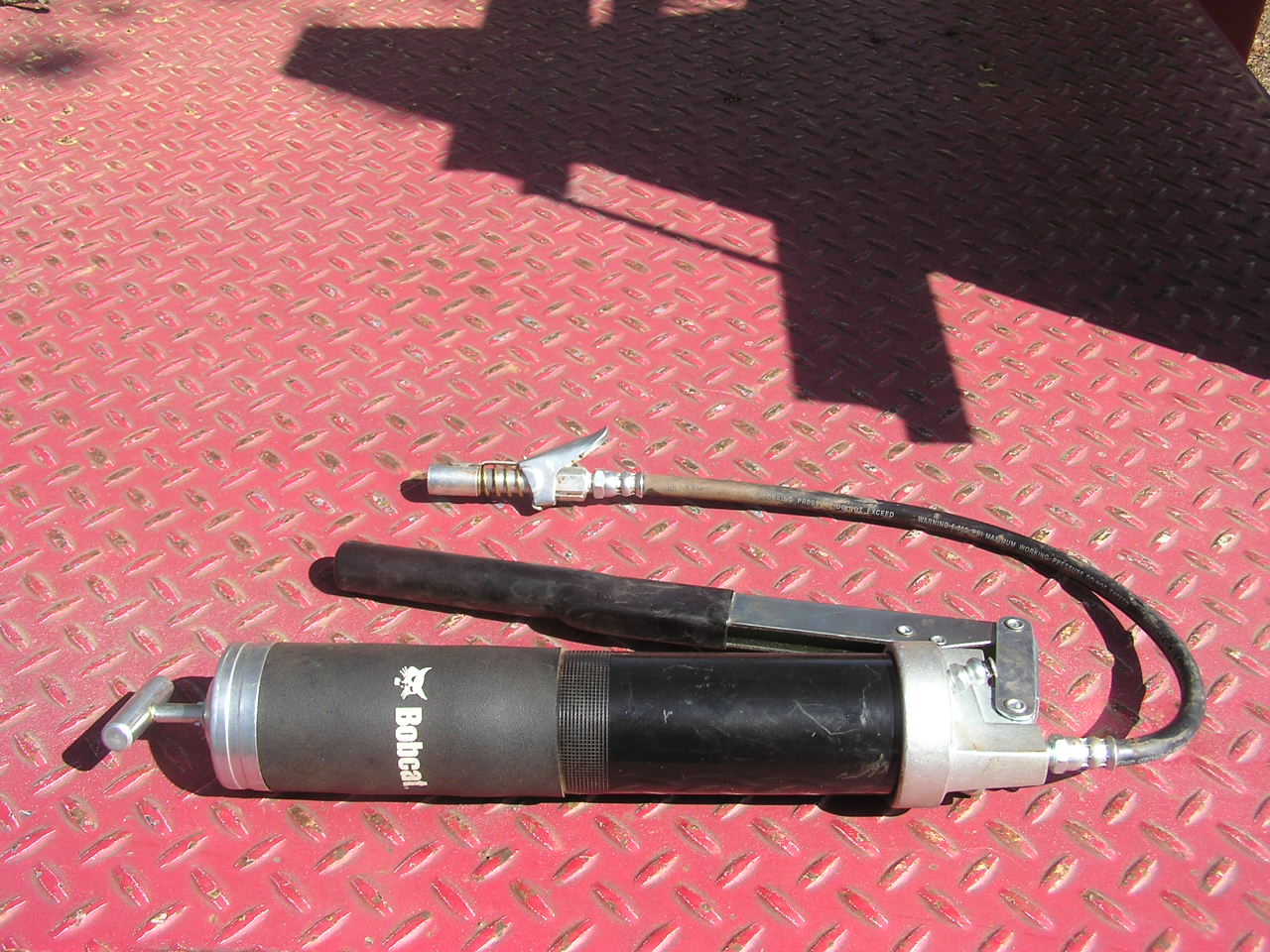

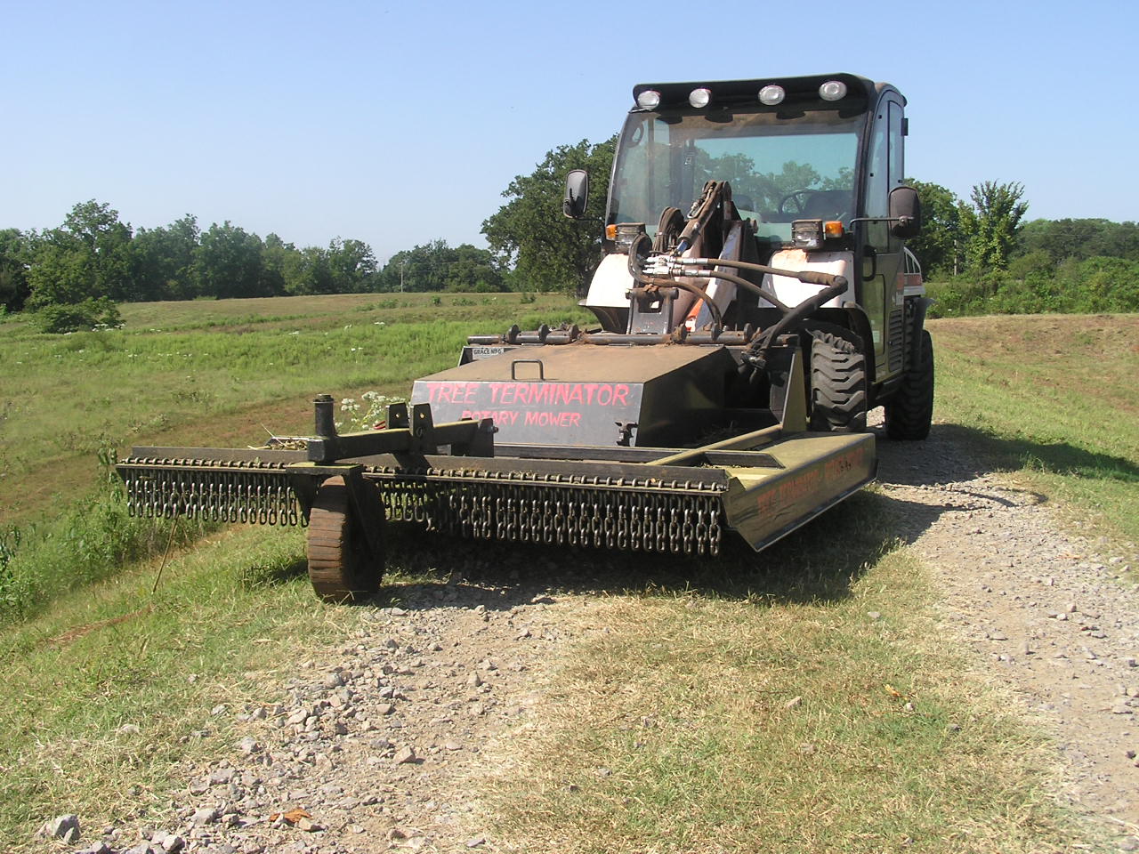

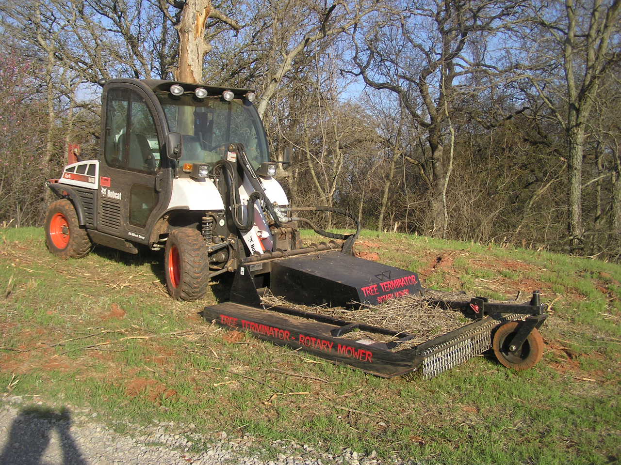

---------------In order to get the zerk in the correct position, they have to be up off the ground enough to turn them. But then when trying to attach the grease gun (flexible hose - pistol type gun) the wheel turns and can't keep the proper alignment.This Lock N' Lube should alleviate that problem.
It will!-----I have mine on a hose on a long handle gun, works great on the front brush hog wheel.
