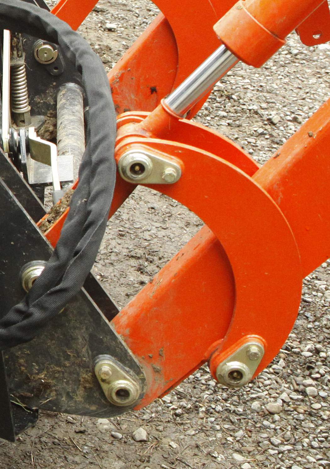

I have several grease fittings that just have holes large enough to get the normal size head into. I actually have to use the hose to push it on. That head looks kind of big. How easy is it when dealing with hard to reach fittings?
   / locknlube cupler for a grease gun #23
well, i cant tell you that, cause i had no issues with any on my equipment. i guess if it was in a real tight area one can change to a 90 degree fitting.
these are the style of fittings i have. it fits fine
As you can see by his photograph that the Kioti loader fittings are recessed, and as such it makes it very difficult to push the coupler sideways to try to release it. I can see how the quick release coupler would be a time saver.
   / locknlube cupler for a grease gun #27
yup, it clips on and off with ease. no issues at all
Yep on mine, I normally have to unscrew the tip a little to get it off sometimes, because you cant push it sideways.
