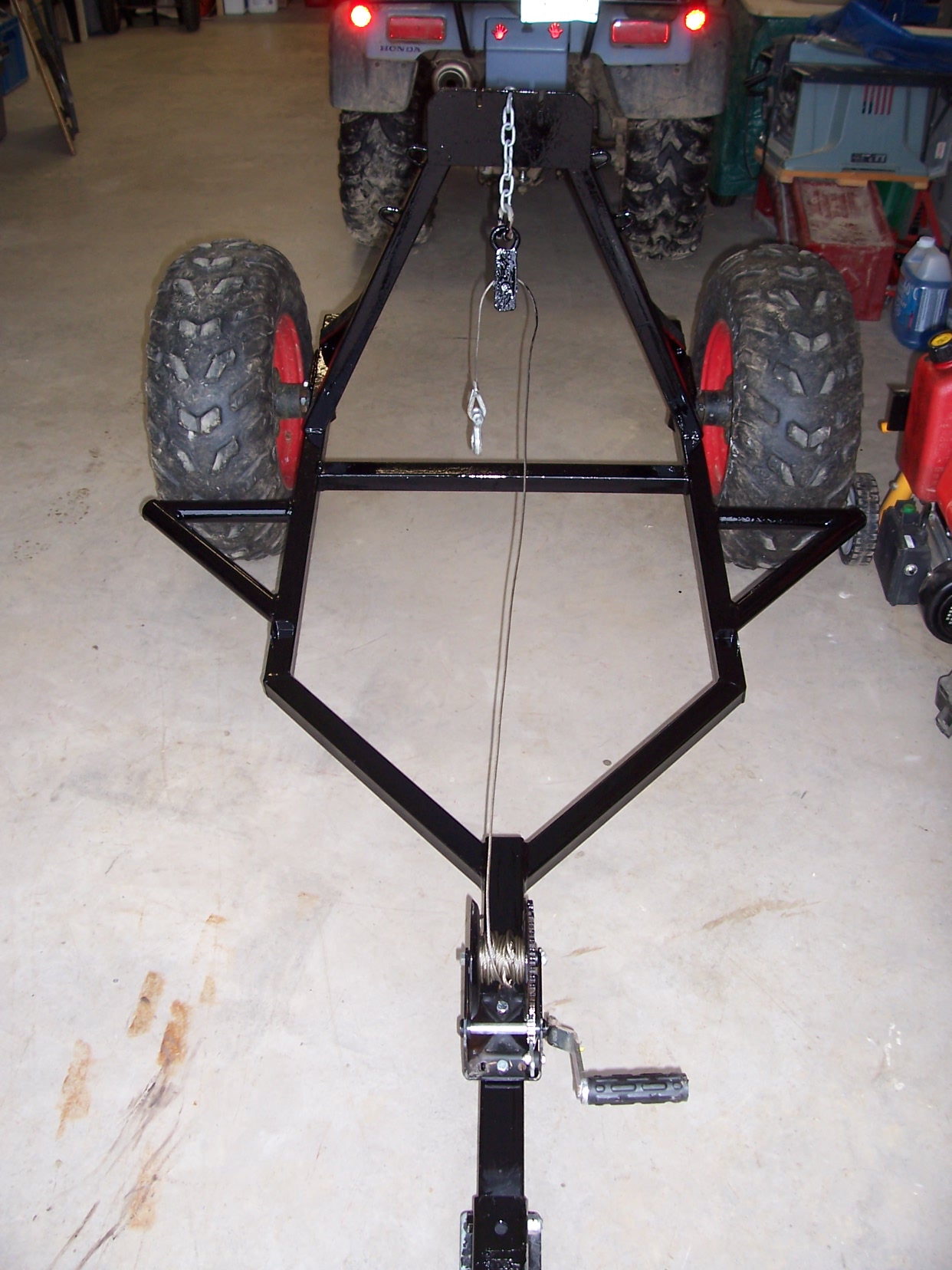

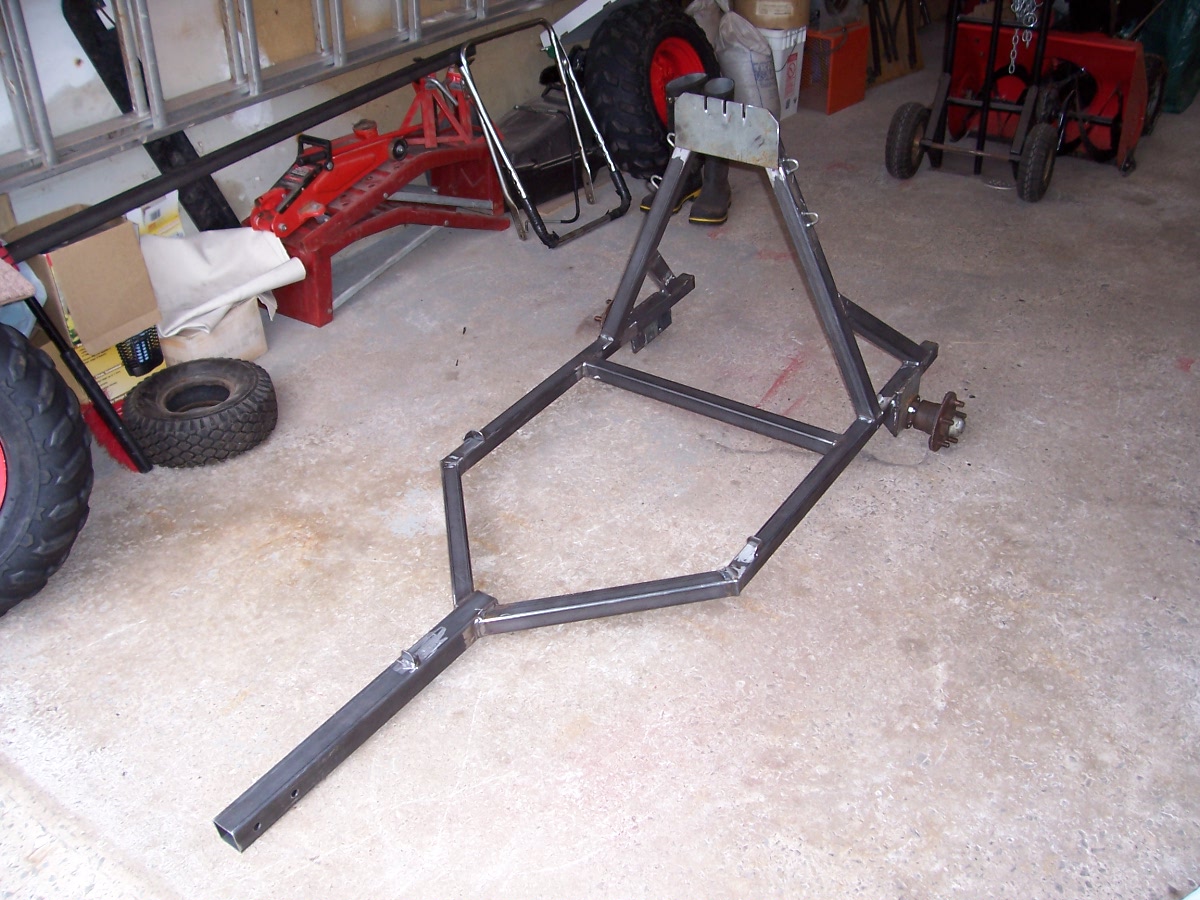

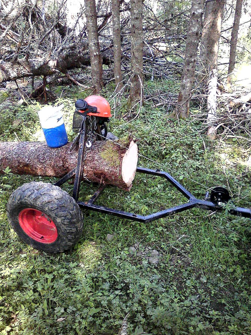

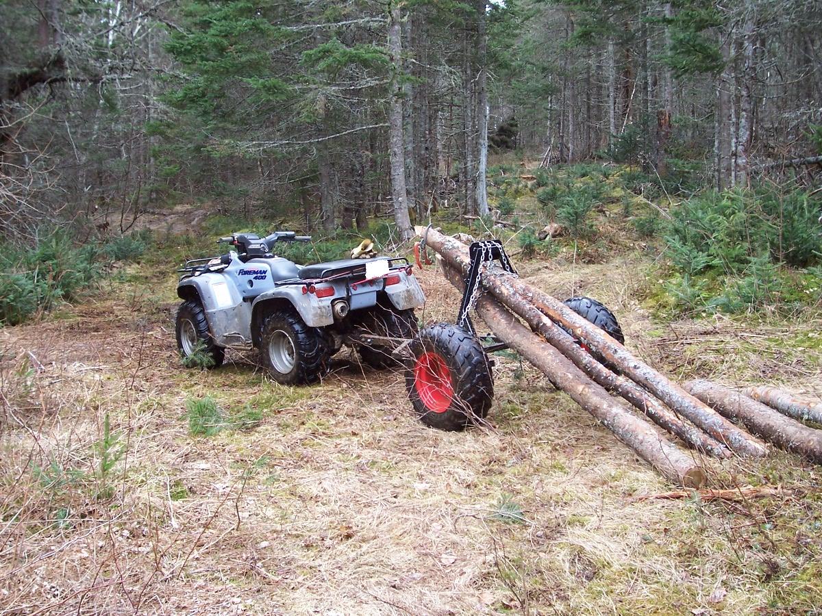

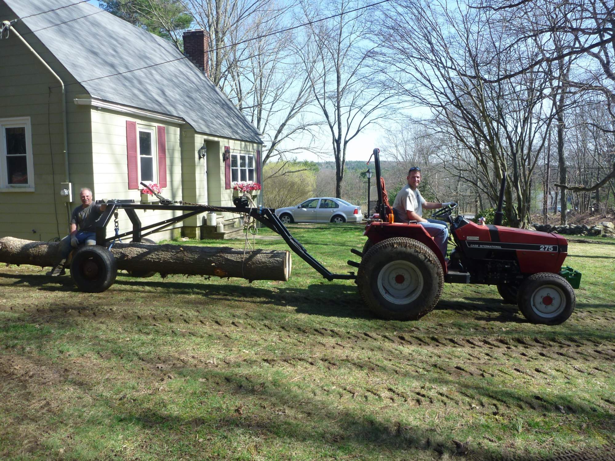

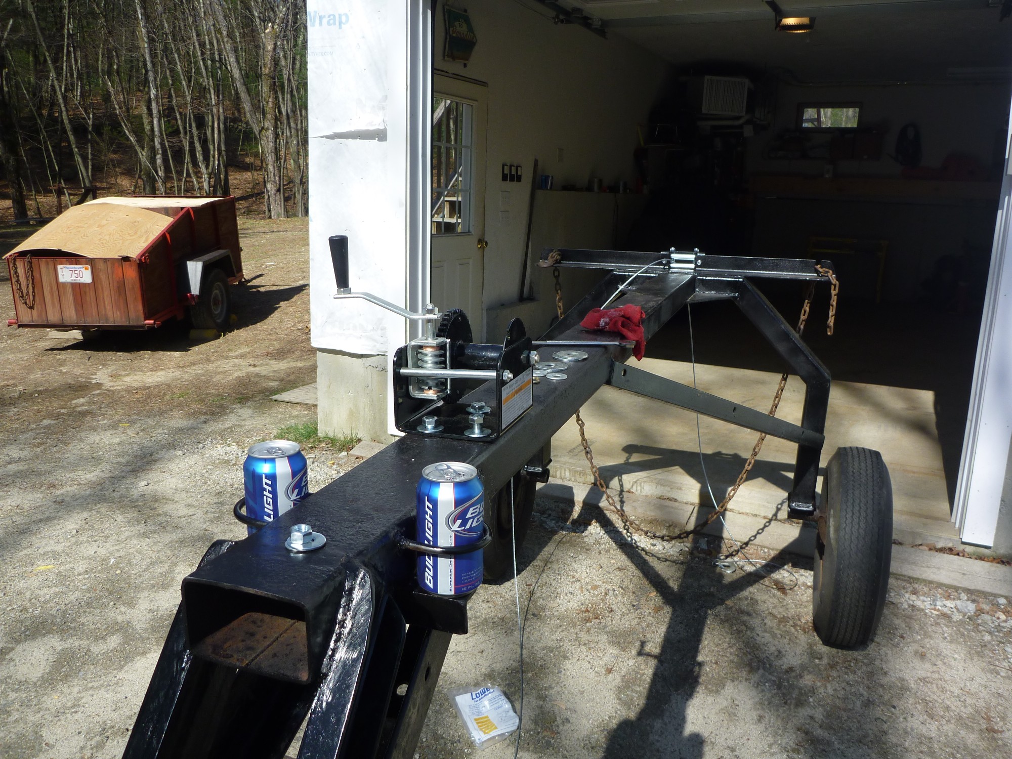

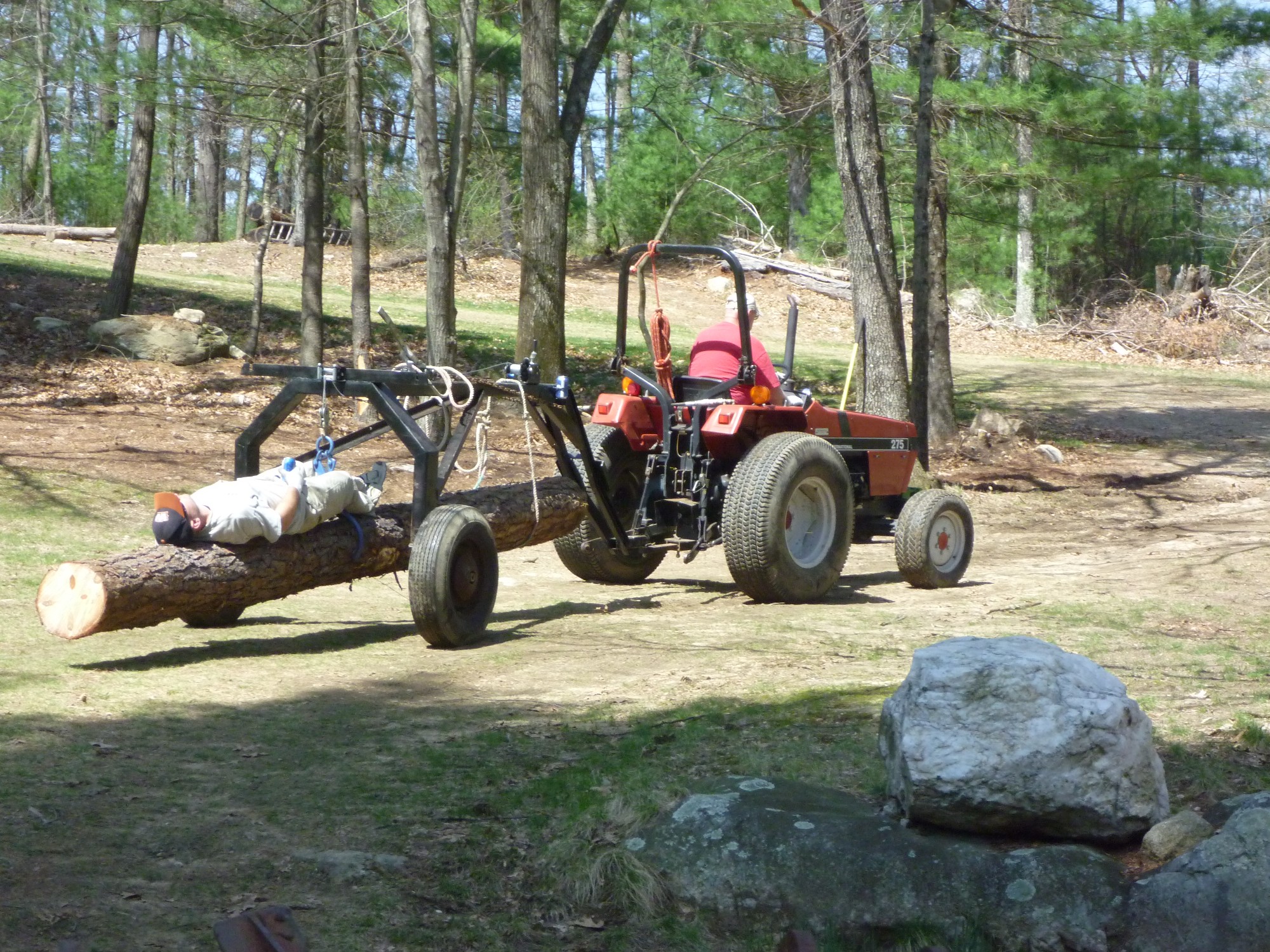

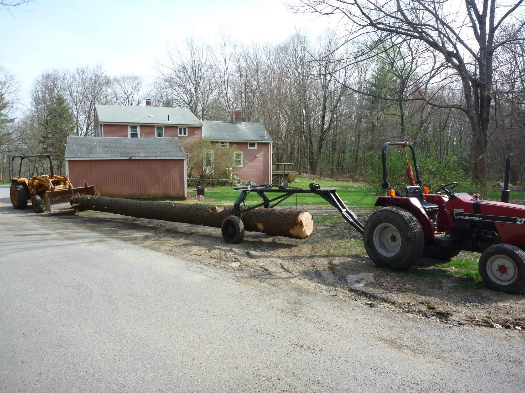

Nice arch, I have used mine quite a bit getting logs to the mill, it's pretty long so not good in tight woods but I haven't had any problems so far. I made it 8' long so I could suspend a 16' without dragging it, its made from 2x4 rectangular steel so its not too easy to move around by hand.

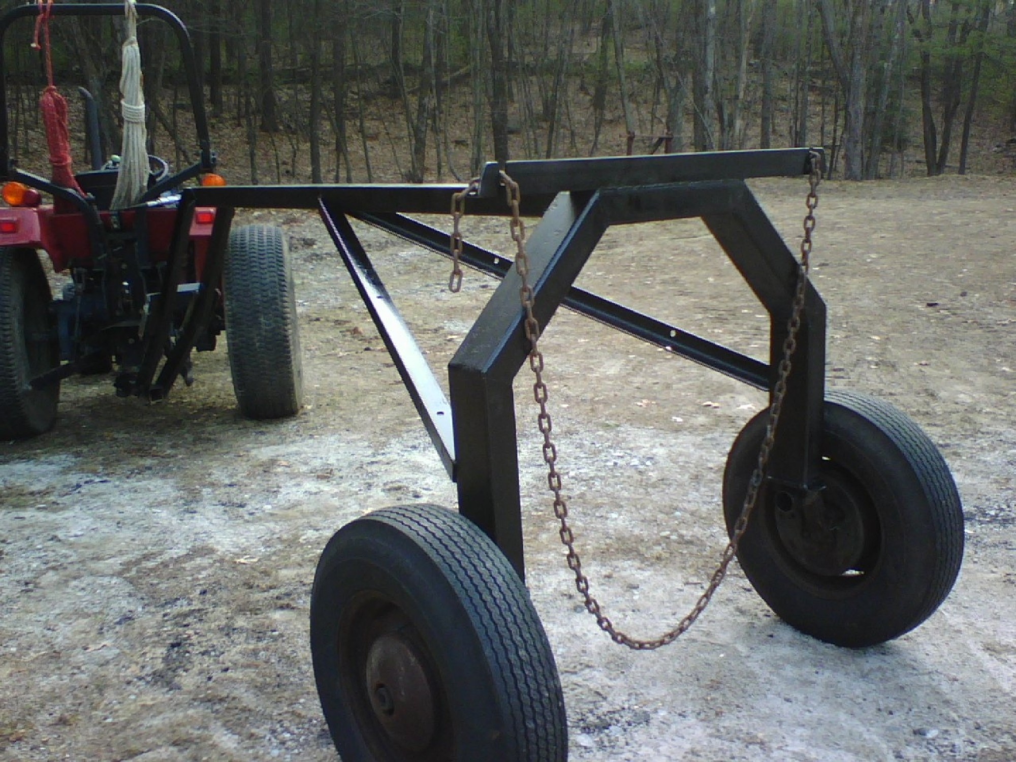

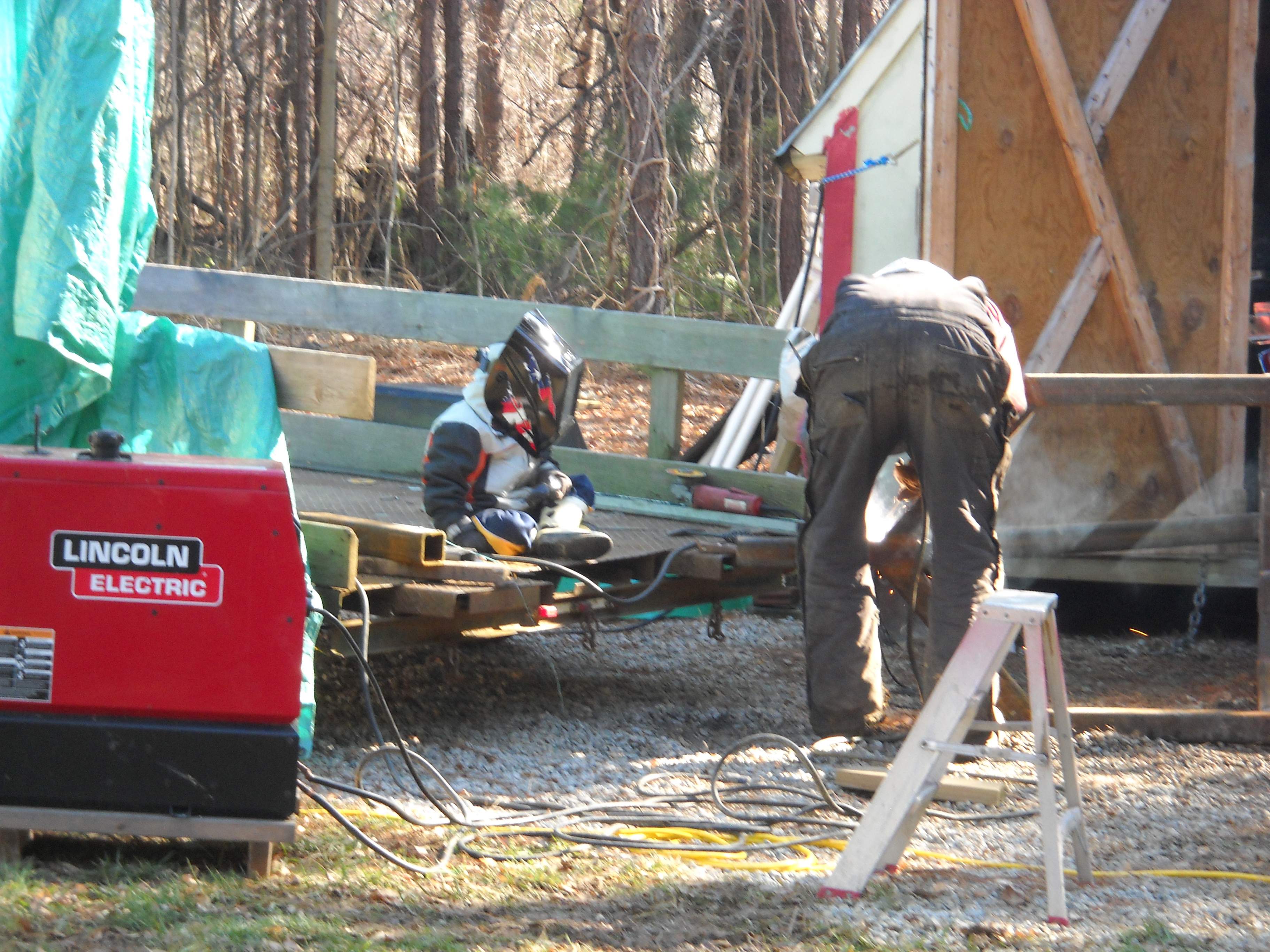

I know how you guys love pictures, here's one with one of my twin 5 year old grandsons making sure Pop is welding it right.DSCN0128.jpg
