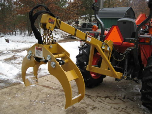

The one pictured has a single double acting hydraulic cylinder to push the jaws open and pull them closed. If you have power to the rear, or a kit is available for your tractor to install it, it would be quite easy to get power to it.

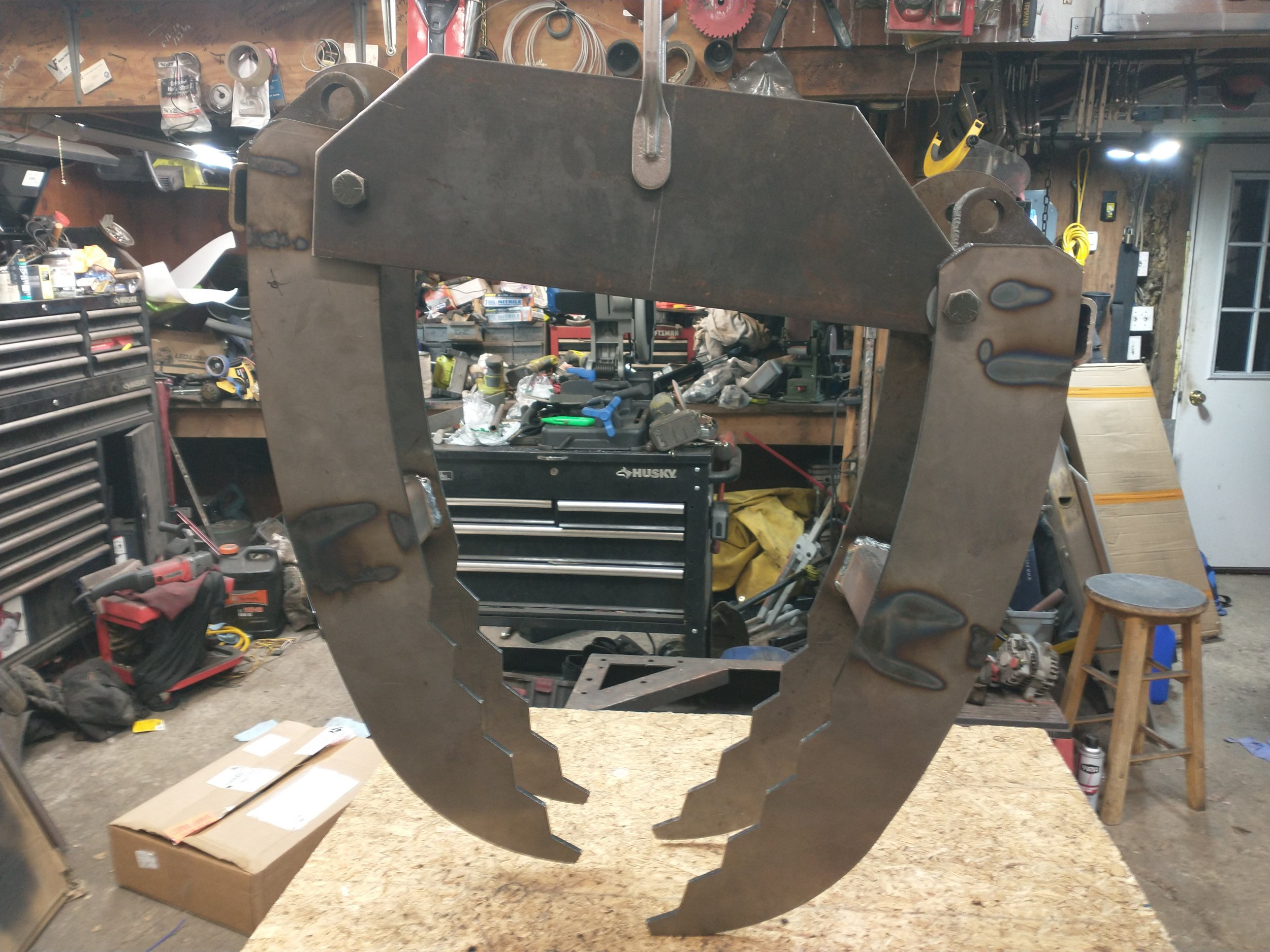

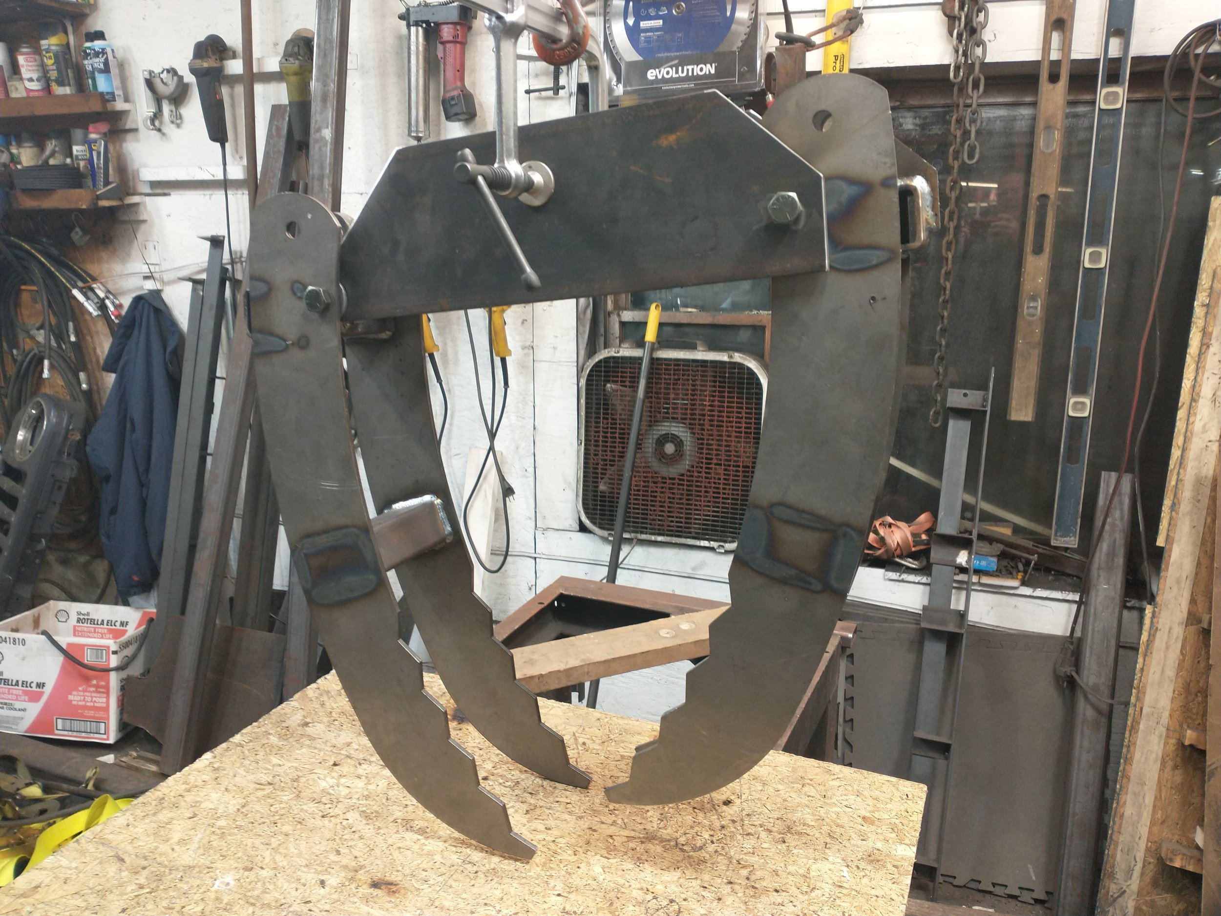

Yep, first thing I did. I think I have it figured out. Of course it would probably have been a good idea for me to see one in person prior to attempting this..lol
Anyway, I just braved the cold and went out to the shop and snapped a couple of pics of what I have so far.
Notice the pivot holes are not on the same plane, this seems to be needed so the will bypass each other instead of smashing ends.
The whole thing is about 24" tall
Instead of using chains I think I am going to use to 3/4" D rings like one of the pics I saw.

That looks like a good start. (y)

I'm going to build a 3 point log grapple, I have never really seen one up close so I don't know how the geometry is for opening and closing. Anyone build one or have a schematic of one? I have searched but have come up empty handed. Just the open/close part I need help with. Thanks
It will be this design:
