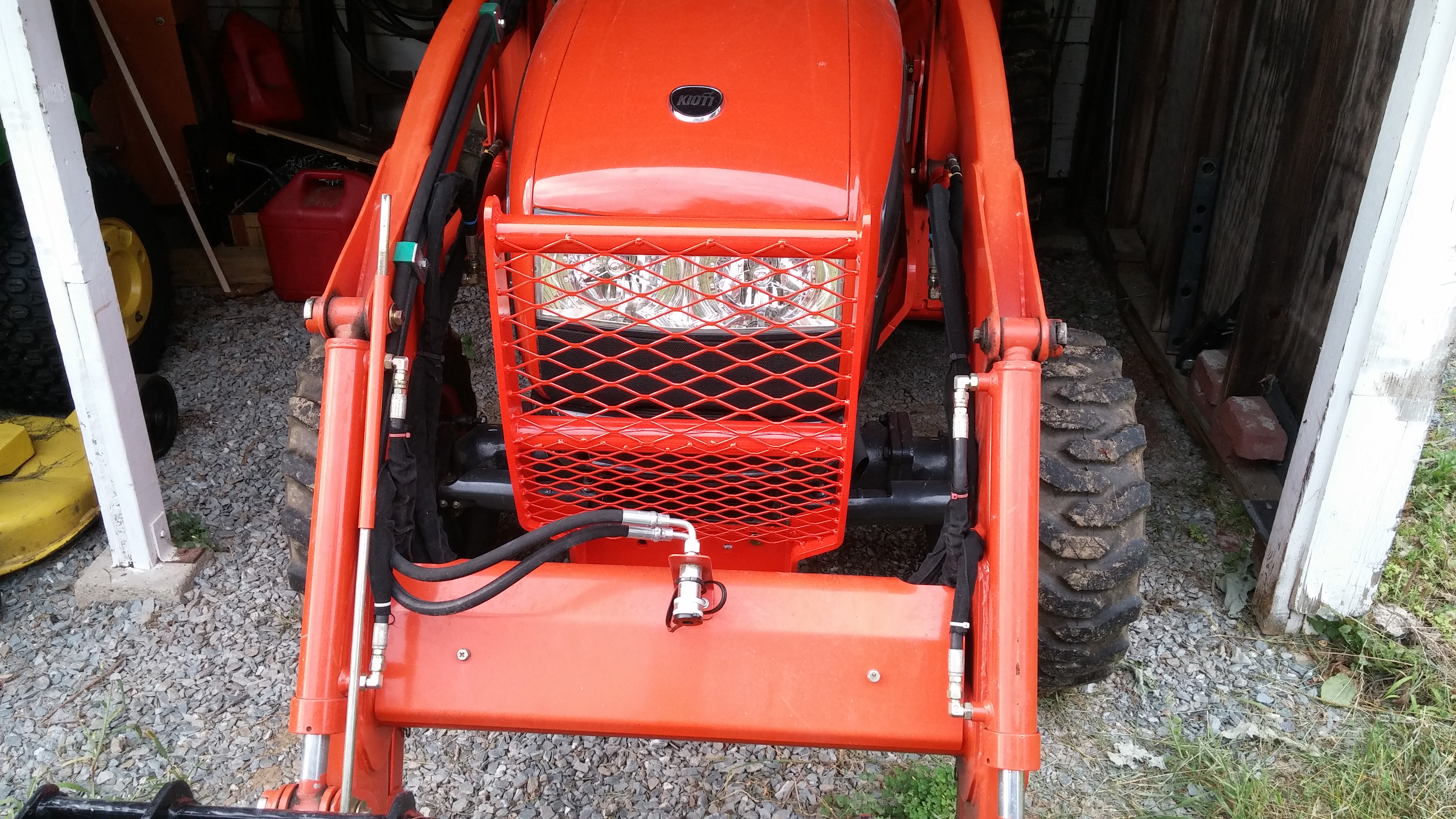

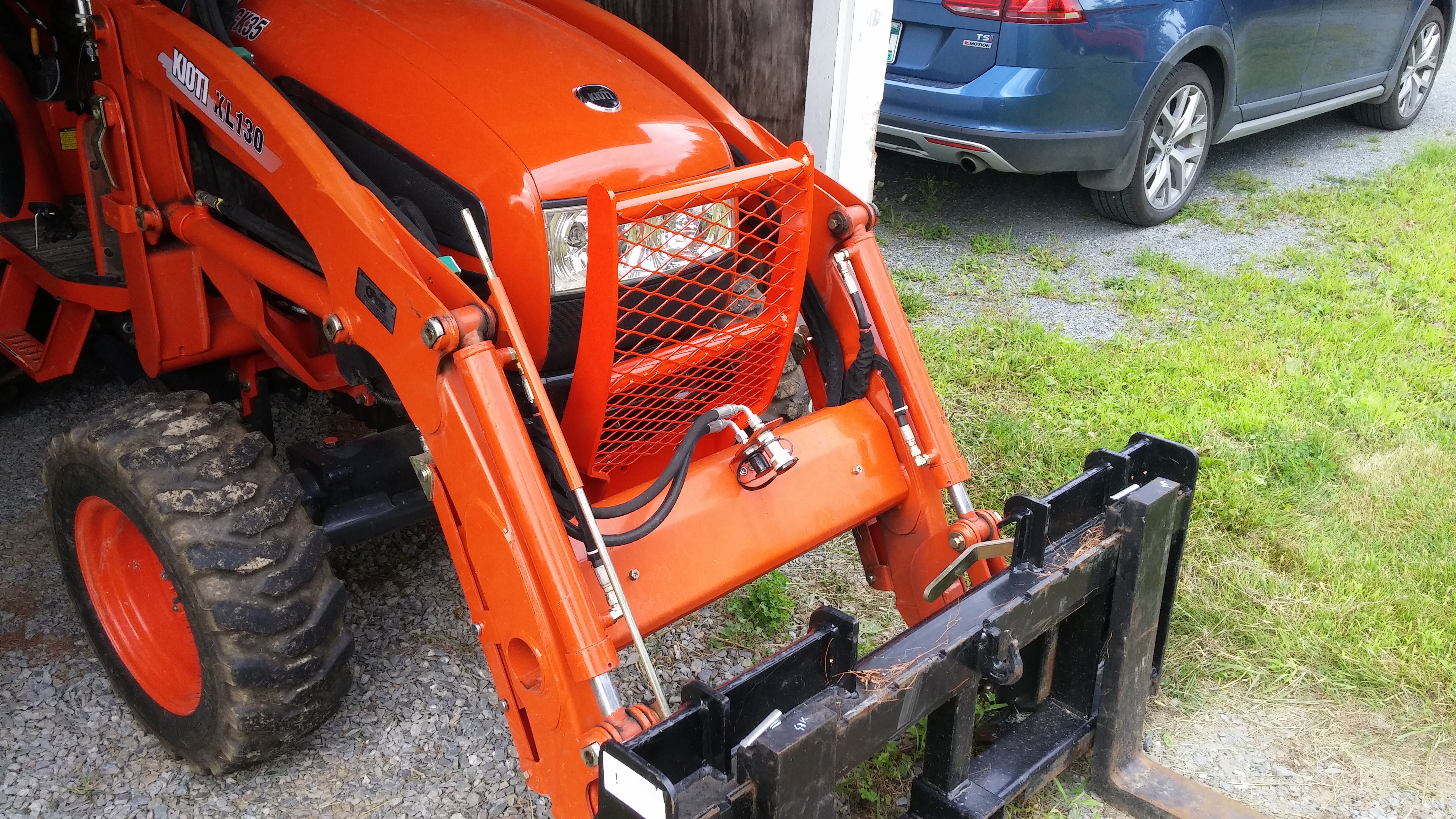

Bush hogging around my field last week without my loader on, I heard a crunch up front so I stopped to take a look and found a nice 2"dia branch shoved up through the plastic shroud below the hood into my battery. Luckily I stopped a soon as I heard it and no major damage done just a broken shroud that I can replace for $70. So I decided to add some expanded steel to the front guard went with larger mesh on top for the headlights. It should stop most everything now. Online metals has a great price on expanded steel ~8bucks for a 2x2 piece.

Nice job, I'm interested on the way you secured the hydraulic lines to the loader frame. Is it factory home built? I just use an elastic cord.

OUCH on the log jam ! Nice fabrication work ! I always have the loader on when i use the brush hog. Yes it can limit my turn radius but it has saved me numerous times from hitting stumps and bigger items. I keep it about 6 inches off the ground.
/ Log in the grill #9
jabelding - Great work ! looks like you found a perfect match for the paint . What was it ? We bought a can of touch-up-paint when the 2004 CK30 was new . Had some touch-up to do - found the never used can and it sprayed out brown !
Chuck
I used some standard hose clamps (the green plastic pieces from surplus center) 1/4 IN TWO WIRE DUAL HYDRAULIC HOSE CLAMP | Hose Clamps | Hydraulic Hose and Hose Assemblies | Hydraulics | www.surpluscenter.com
then tapped the loader arm for the bolts. On my QD bracket I fabricated up the bracket and painted it with Kioti new orange Spray bomb. Same paint I used on the front grill. It is expensive from the dealer $20 but it is very good quality paint and seems to be an exact match.
/ Log in the grill #11
View attachment 518857 Its a simple bracket, 3/16" steel, welded on to the crossmember with two holes drilled to hold the hose ends.
