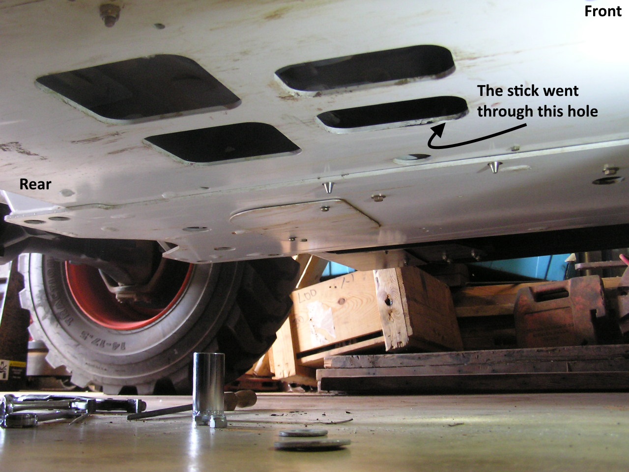

My brush hogging ran over stick story: http://www.tractorbynet.com/forums/safety/327514-what-have-you-missed-hit.html#post3981448
Went through a hole under the engine:
Wiped out fan blades :eek:

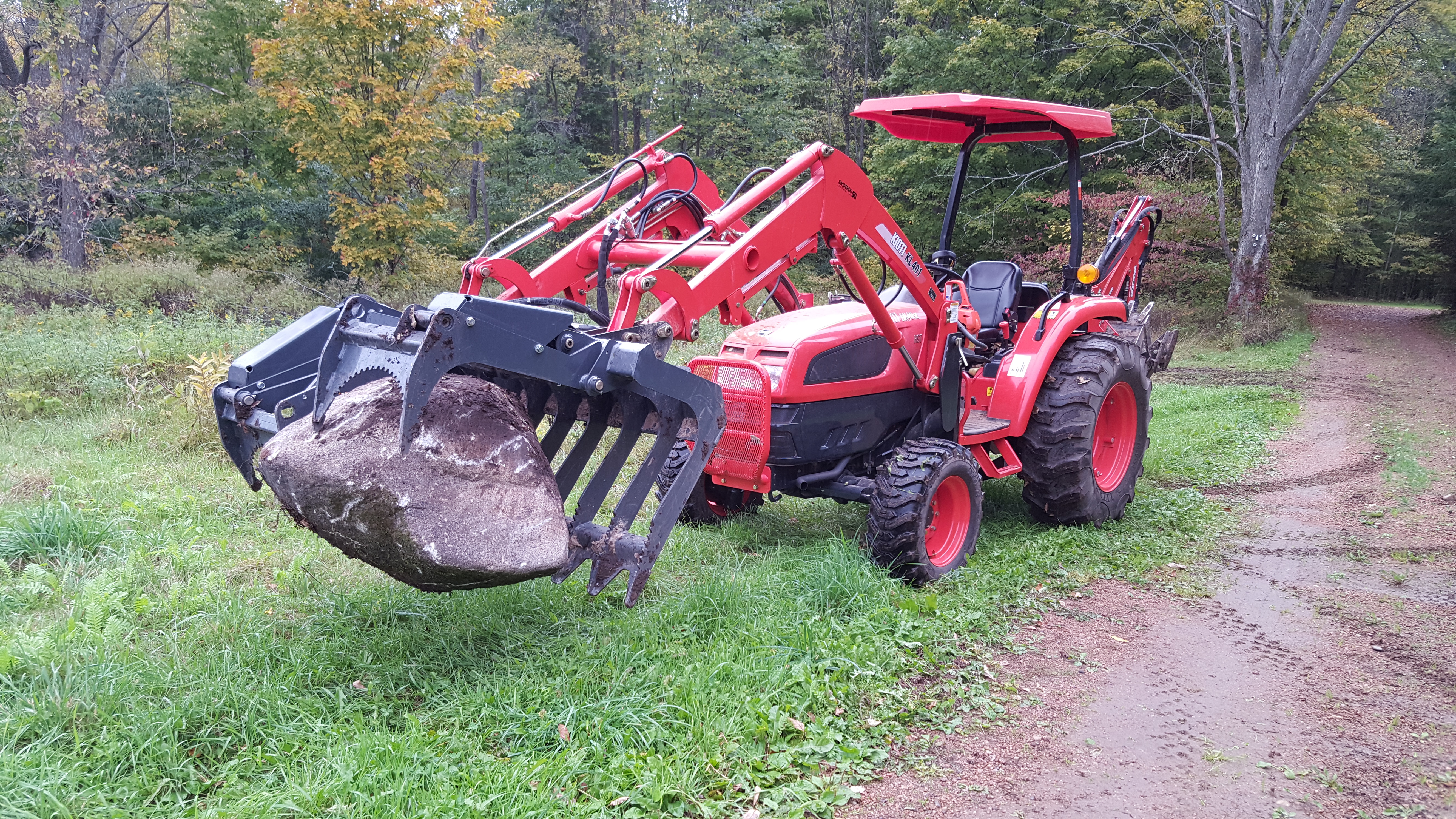

I've moved some big rocks but I wrap chain and drag them.

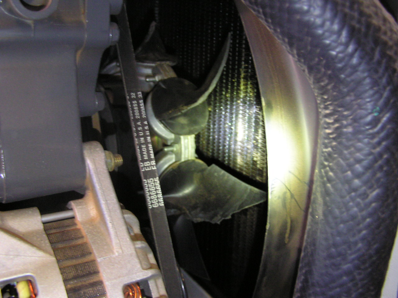

My wife was out cutting some heavy brush the other day with our Kioti and came back to the house saying the oil light was on.
I doubted the was an oil supply issue, most likely a stick knocked the wire off the sensor. I get out there and find that a stick / tree trunk got up into the back side of the rad area and knocked all of the blades off the fan. Luckily the damage to the rad was minimal and nothing was leaking.
I've got a fan on order, a dealer that's 2 hours away had one on hand and shipped it out right away. No idea why the oil light was on, I am wondering if it's a combination oil pressure / oil temperature light as I know the engine was hot when she shut it down. Luckily I have a cab so she just used the cab heater to cool the engine done before turning it off.
