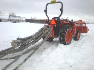

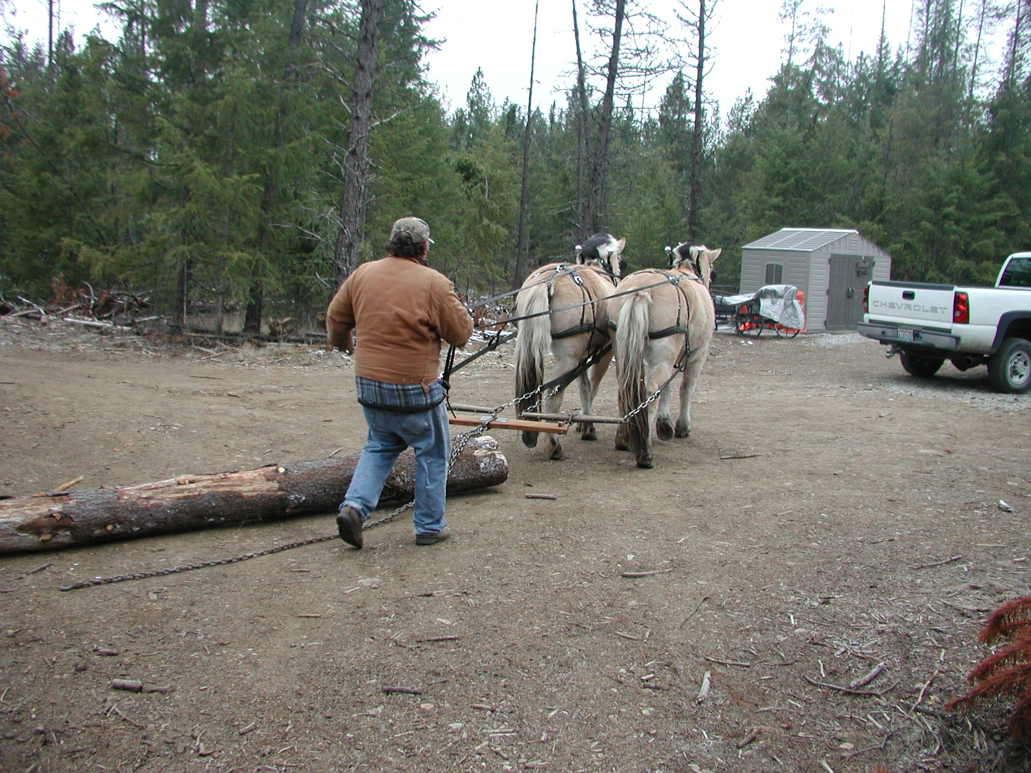

na, this is how you skid trees
just kidding. can you make your own??? like in the picture provided above??
i try to minimize logging with a tractor on my place, cause i tend to destroy too many other trees in the process. i'll try to pull them out of the denser areas with logging chains and loader hooks.

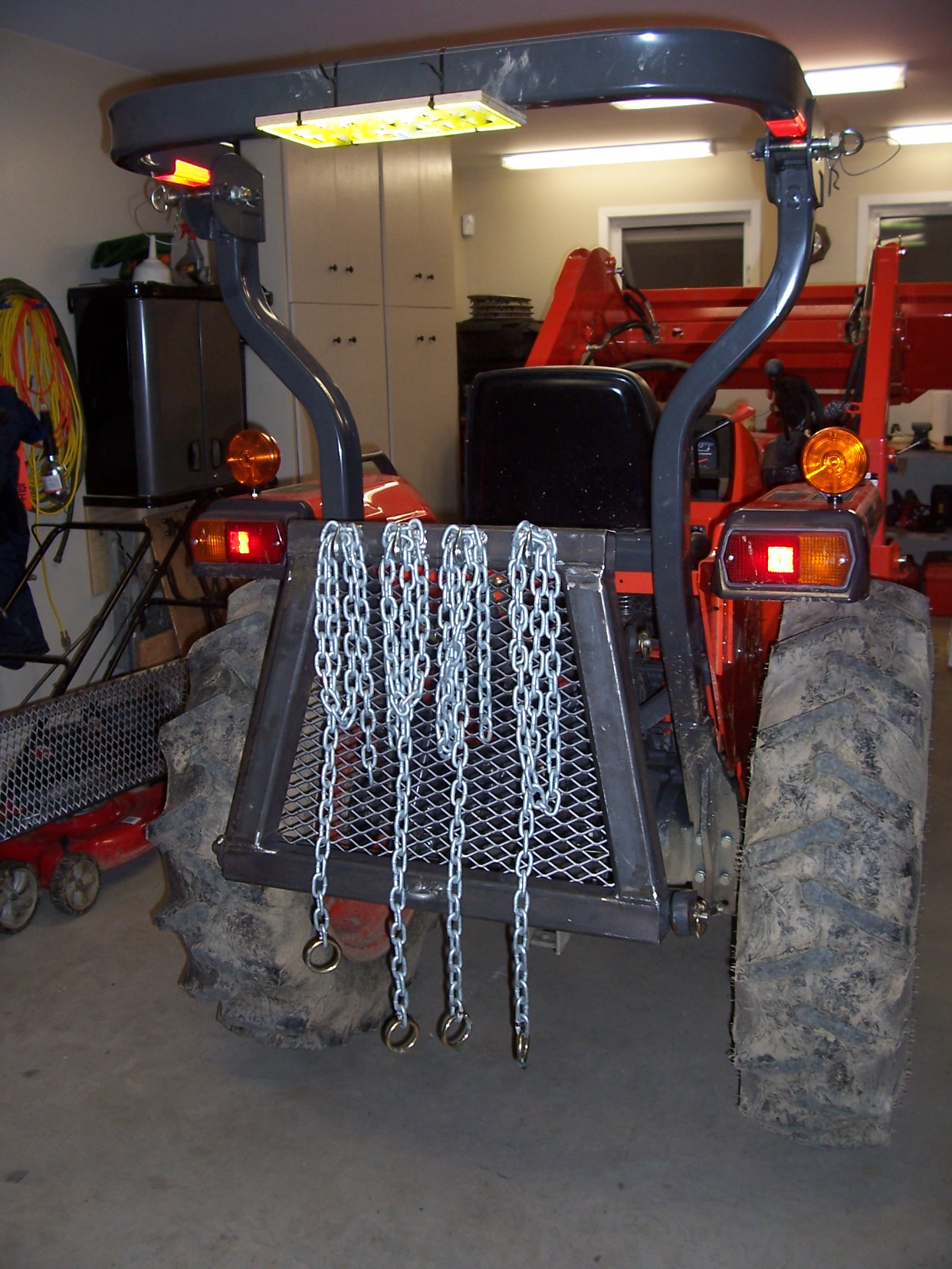

More on topic, I made my own. A few hours with an angle grinder and a welder and it's done. Works quite well.

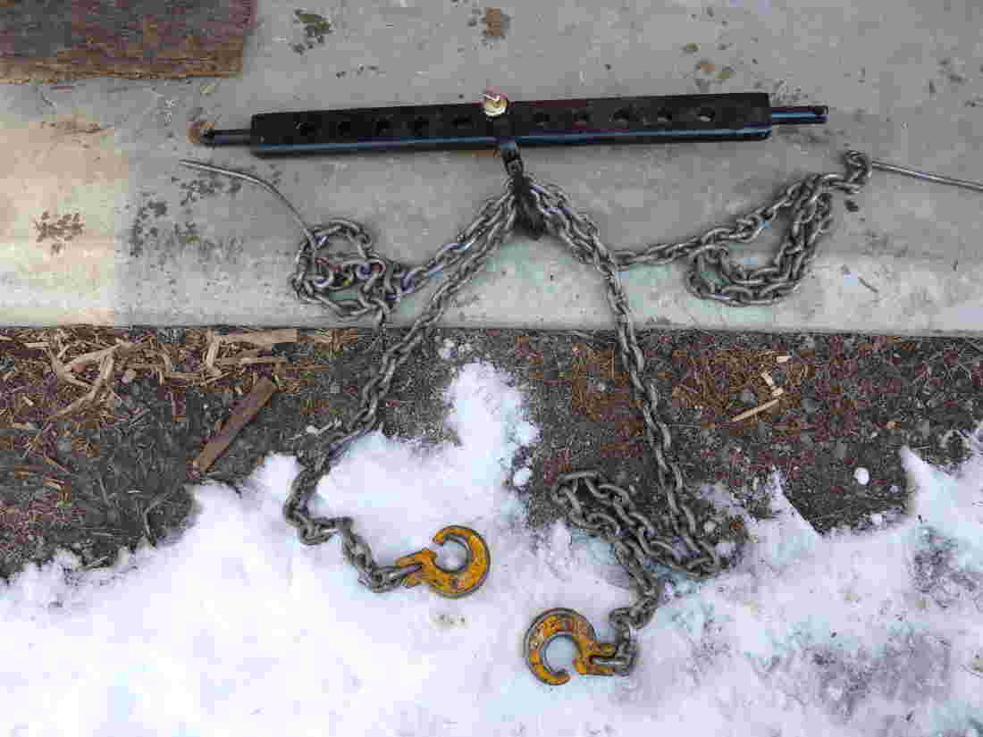

Have you seen a cross draw bar with tractor hook(s) being used ? It is not exactly what you are looking for and it is not nearly as nice as Sean's or the Wallenstien units but they are better than using your fixed draw bar. You can use more than one hook with a couple chokers on each. And you can pick all the logs up with your 3ph to make skidding easier. It is also relatively inexpensive. The draw bar and tractor hooks are available at Tractor Supply. Just thought I would throw this out there.

Looks like a good idea to me, Gordon. I had the "plate" imprinted on my mind when I started, so it stayed there.
The only drawback I could see with the crossbar is the possibility of the log hooking on a stump. Common sense can prevent a lot of that kind of problem, but stuff happens.
I'm giving some serious thought to either adding a hydraulic winch to mine or going full-blown logging winch. I have a bunch of alders to haul out of the ground, and they're in a tough spot to get at.
Sean

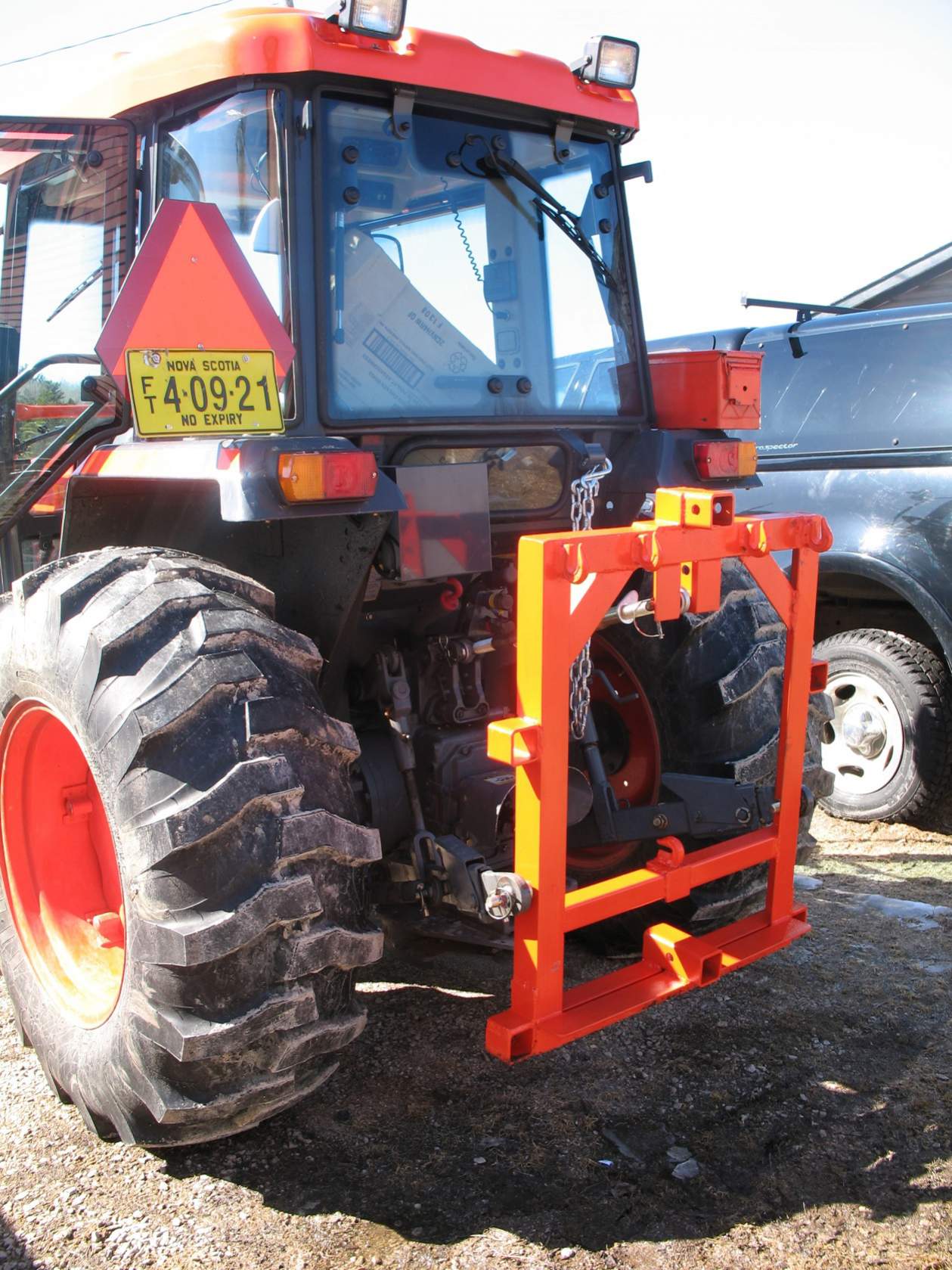

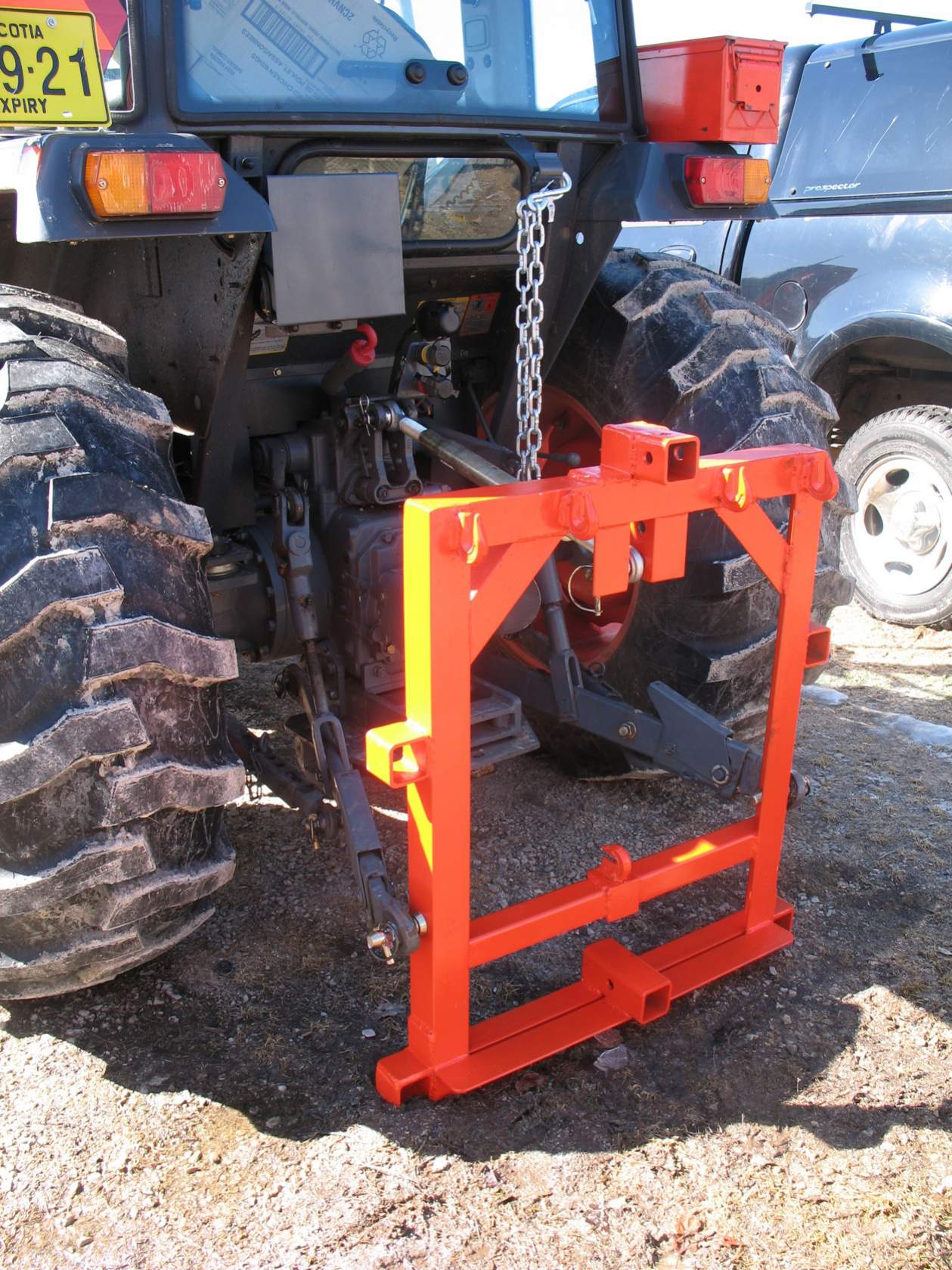

I have a winch but built this several years ago...
Lloyd
PS: saw the Wallenstein plate at the Moncton farm show a few weeks ago... it retailed for around $850.

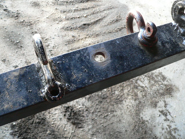

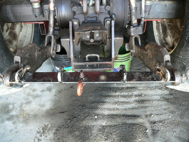

I made one like that, but also welded 4 chain hooks on it as well. It worked quite well for me the first year I did serious logging for the out door wood stove. Then I got the Farmi 601.
I will try to take a picture of it and post it later today....edit: pickies below.. I doubt I had $100 in material in it, (at retail). The key it to get all your log butt ends lined up evenly, drop the lower links, cinch the chains somew3hat snug and raise the TPH just enough to get the buts off the ground.........
First rule of thumb when skidding logs with a tractor: EASY, CHEETA!:thumbsup:
