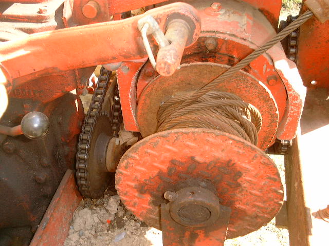

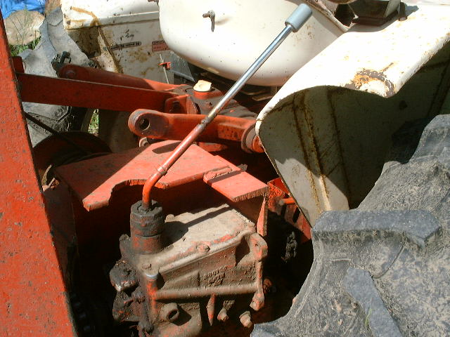

Here are a couple of pictures of a skidding winch that I built
for the Satoh S650G when the tractor was new. I used a #60 chain drive from the PTO shaft to the input shaft of a
Volvo transmission, and a chain drive from the output shaft of the transmission to the input shaft of a large worm drive box. As you can see I cobbed a spool out of 1/4 boiler plate. I've
used it for yarding and skidding for better than 25 years, and
the tractor and I are still alive.
   / Log Skidding #35
Here's another pic of the same rig. Hope I'm posting these prpoerly....
   / Log Skidding #36
Here's another picture of the skidding winch. I chose not to
mount this on the 3PT rig but directly to the tractor frame.
I have never used my 3PT setup since I installed this winch
