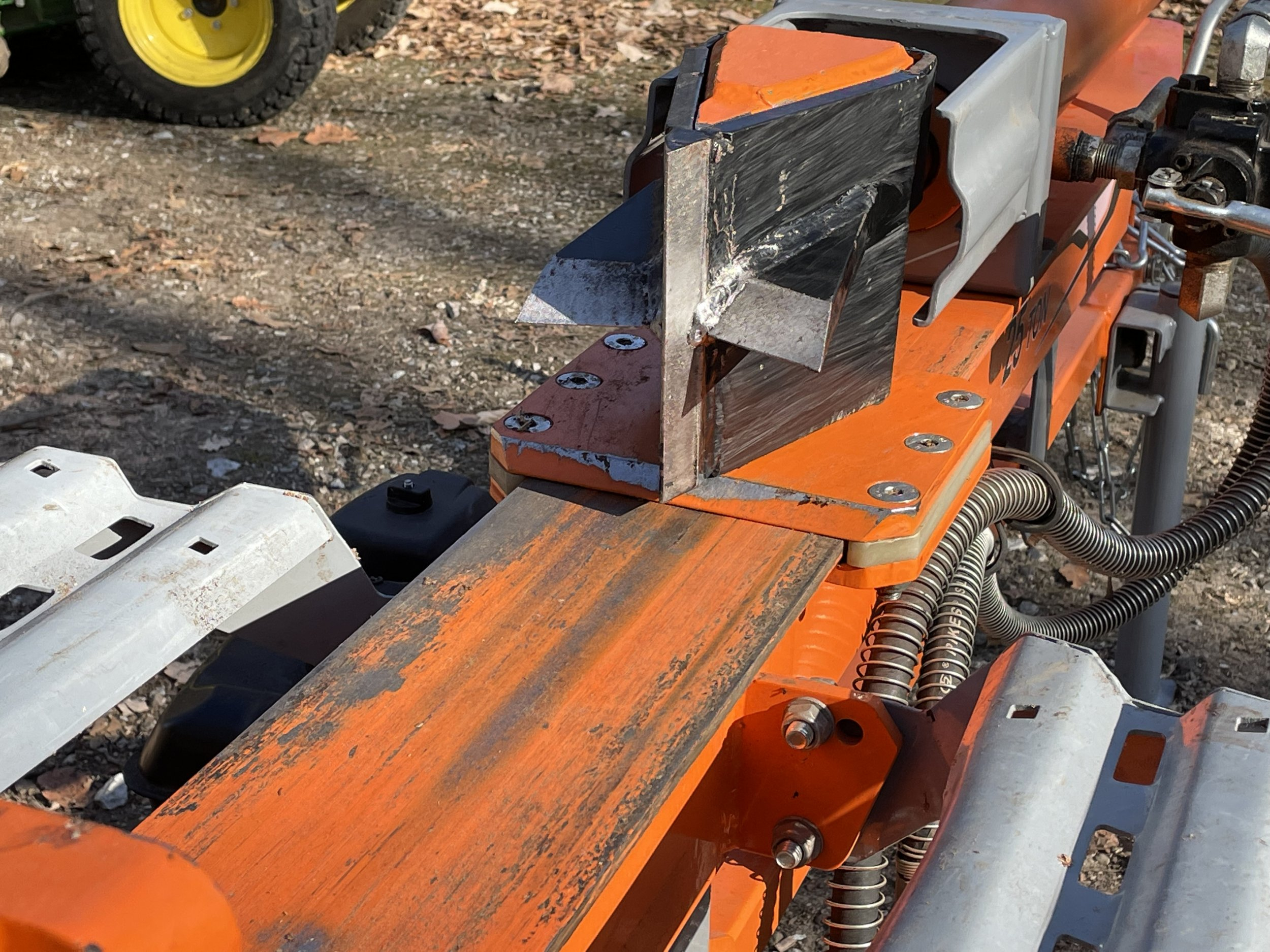

Sure, but it's in just about every splitter pict. I post, as I push everything through the 4-way! Another thing that's nice about that design, it doesn't spit splits at you!
There's a better pict. for you...

Sawyer Robs picture looks like it would work well. It’s hard for me to describe but mine sits to low so the bottom splits are to small and the top ones are to large.

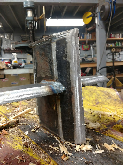

I posted a pic of mine in post #7. I made it so the wings are set for the "ideal" size firewood.
That is my wings are 5" high. So a perfect 4 even splits would with a 10" round.
Not all pieces have to be perfect.....8"-12" rounds work out really well with my 4-way.
But what about a 7" round? Something that "without" a 4-way I'd only split in half. But with a 4-way on that would result in the two lower pieces being about perfect.....but the top two being little 2" splints.
Or what about a 13" piece.
Bottom two would be idea but the two coming off the top would really need busted again. So the odd-shaped piece going through the 4-way again....odds are one or two of the pieces would be a little splint.

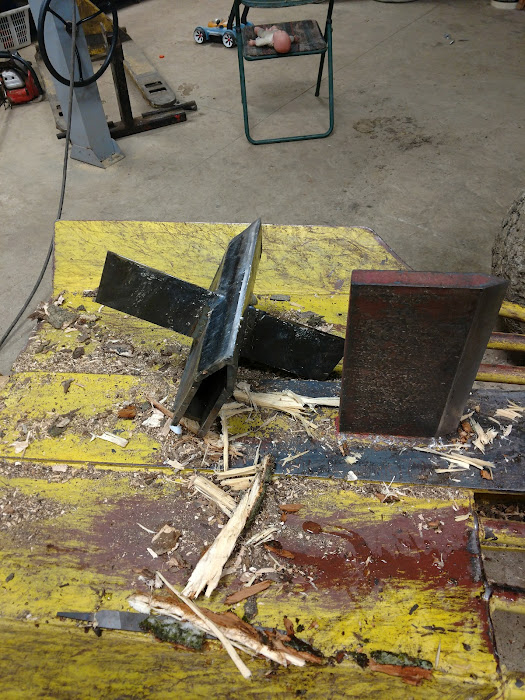

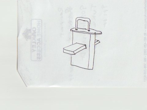

I have this and bent up this 1/2" bar for a handle. Works well.
/ Log splitter 4 point wedge #51
Looks alot like mine. No handle, I just grab the wings for my handle

When you talk about a "fixed 4-way wedge" are you talking about one that is bolted or welded on to the splitter, or are you talking about one that is easily removable with no tools required, but is not adjustable in height?
There is no way I'd want one that is bolted or welded in place, but I would not want to be without my removable 4 way wedge. I drop it on when the situation calls for it, and pull it off when it doesn't. I do try to stage my rounds in such a way that I'm not having to switch back and forth every couple of splits.

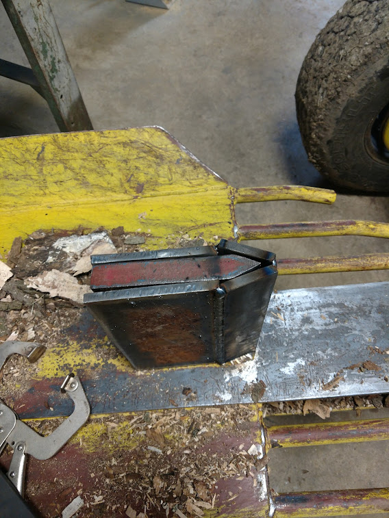

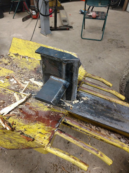

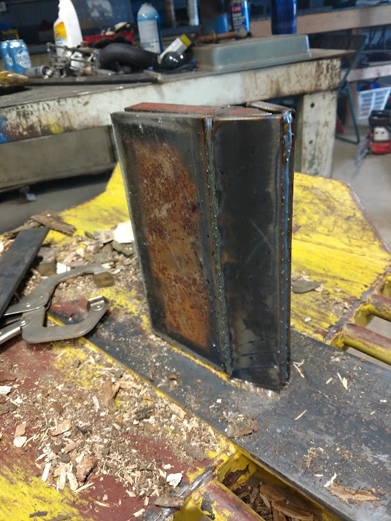

I attached a picture of mine and one showing the splits. The round was roughly 9” and two of the pieces are perfect for me, one is to small, and one to big. Not a big deal, close enough, but if the round is bigger or smaller, not so good. Once again not a big deal as the 4 way just drops on mine and comes off with no tools.
That's what I used to do.
Then I became twice ur age.
One hand toss suits me better.
You mentioned in another post that you thought your horizontal wedge sat too low, making th bottom splits too small. That one looks pretty good to me. My original 4-way wedge split a bit larger than that: about half way up a 10" high vertical wedge. I had the factory make me another that was about an inch lower. I get a bunch that are about 3.5"-4" through the bottom, and the top varies depending on my log size.
I do tend to split smaller than some people. Smaller chunks burn more efficiently (though I do realize that maximizing efficiency is not everyone's sole goal: There is a balance with efficiency of burn and making efficient use of your splitting labor. Size also affects how frequently you have to load. Also, the bigger chunks are more likely to last through the night.)
Your correct, it sits a little higher than I remember. It’s definitely quicker having the 4 way if the round is the right size. I may experiment with it a little more.
