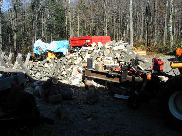

Hello Will. I'm afraid I can only find one picture of my splitter tonight, and it isn't the best of pictures.
My splitter is made up of a lot of pieces I scrounged. The right angle gear box came from an old buzzsaw that was on a Ford 8N. I took off the old wide flat belt pulley that was on it, and replaced it with a double v belt crank pulley off of a small block Chevy V8. The pump was an Ebay find, the oil tank on it was a fuel tank from a dragster my friend had, and the cylinder and valve came from Northern Hydraulics. I had to pay the long dollar for the I beam, and the PTO shaft I also bought new.
It is packed away for the winter in back of my storage shed, so I can't get at it right now to take any better pictures.
