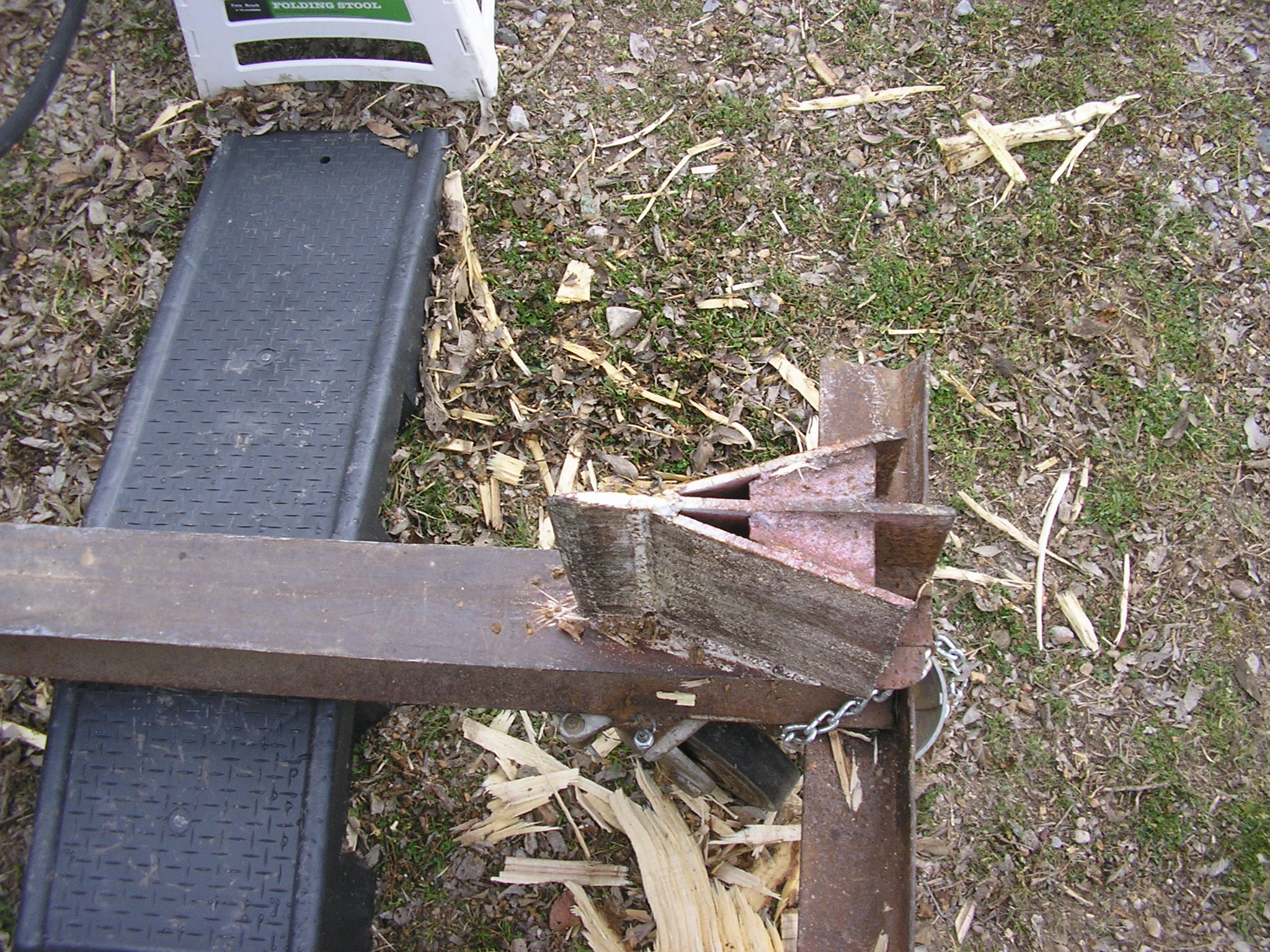

I have a 4 x 24 cylinder I bought from ASC and a homemade ram. I toyed around with the cutter and through 4 iterations I got what I want: The blade 8" tall, is as sharp as my hand grinder can make it, and is made from 3/8" steel stock. Approximately 3 inches beyond the point and welded to it, is the wedge which flares about 20 degrees in both directions. This setup provides the maximum #/square inch initially to get the blade into the wood and once it's started the flare to force the log apart.

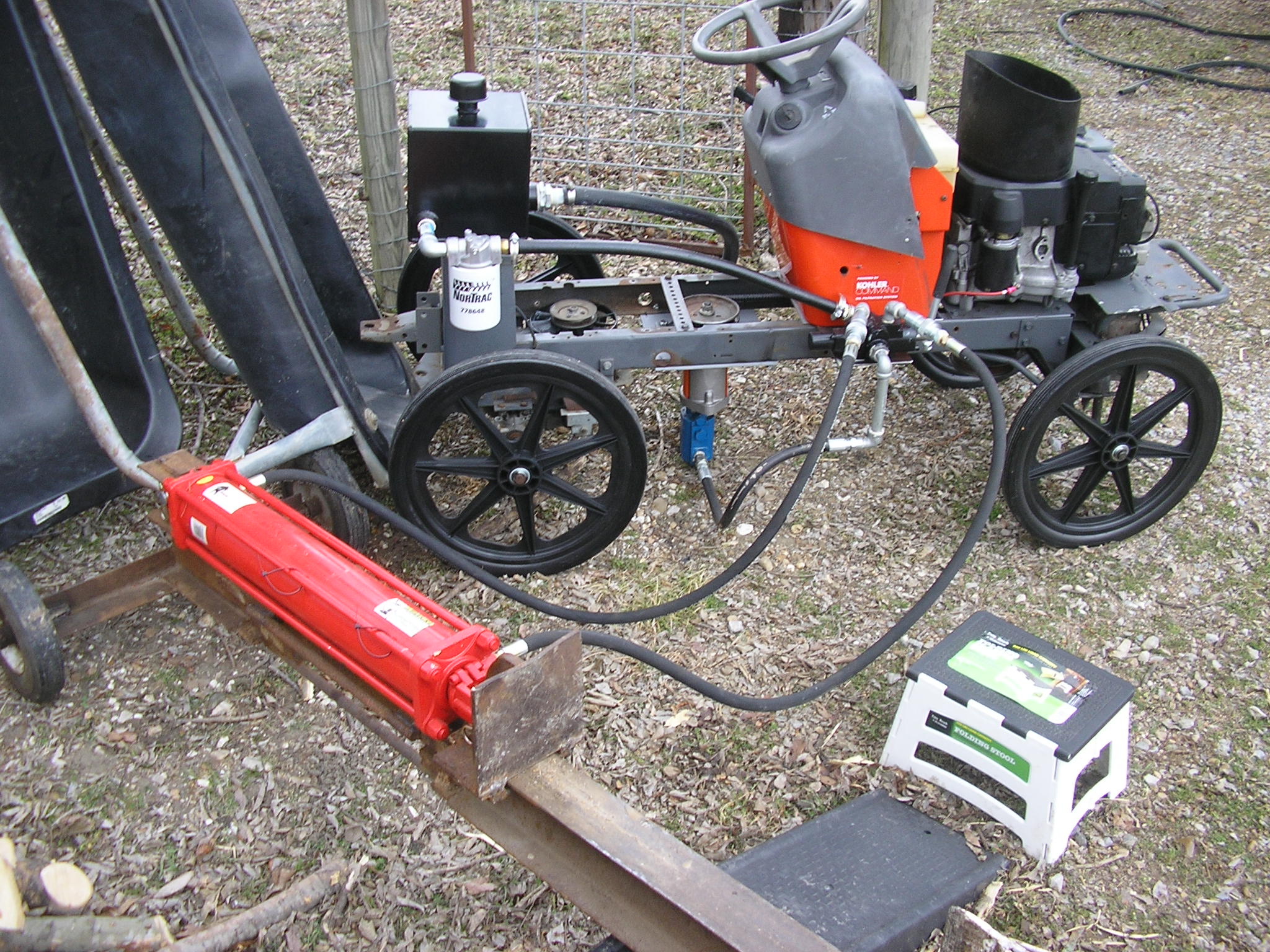

I had been running it with my tractor but to offset cabin fever this winter I had an old riding lawn mower sitting around with a shot deck and decided to make a pump driver out of it hoping to be more convenient than the tractor and it surely turned out that way.
The engine is a 15 hp Kohler 1:1 V belt driving the 16 gpm 2 stage pump (8 hp drive requirement @ 3600 rpm stated) from Northern Tool where I also purchased the "log splitter" control valve, Lovejoy drive sockets and mounting bracket for the pump, all to allow me to V belt drive the pump. In surfing the www I found a hydraulic site where I learned a few things about log splitter hydraulics which helped in the design.
First thing I learned was to keep the runs short. Outlet of the pump is 1/2" so the pressure line to the controller is 1/2" and about 18" long. Return from the pump is 3/4", about 24" and routes to the filter and 2.8 gallon oil reservoir. Also the site said that making the return large helps your cylinder retraction time. Lines to the cylinder from the control are 1/2" x 5' each, reason being I wanted to sit between the splitter and the drive unit. Unloaded cycle time is 7 sec out and 6 back with the Kohler running at the notch in the throttle plate which should be right at 3600 rpm. I am really pleased with that as my tractor was really slow....partly because I had very long 1/2" lines between it and the cylinder, plus the pump was only about 8 gpm.

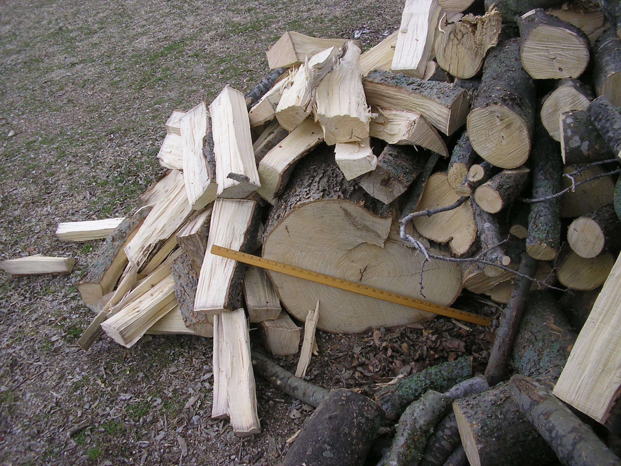

Yesterday I was splitting some 24" trunks from a tree I cut back in December; wood is Hackberry, kind of green and stringy like Water Elm. I deliberately made my splitter close to the ground so I could roll logs to it and minimize my lifting, in addition to being able to work large pieces alone, as I was doing yesterday. On these big guys, I used automotive ramps to roll them up and onto the beam. I could hold them in place with one hand and reach over to the mower to get to the control handle for the split.
The ram zips right up to the log at a nice clip as stated and as soon as the blade contacts the log the second stage of the pump immediately kicks in. You can hear the engine load up somewhat with the new load but the second stage (high pressure, slow speed) only runs for a couple of seconds, just long enough to get the knife edge embedded in the log and then the pump reverts back to low pressure high speed, and the ram moves out again and pushes the split log off the end.
In running the numbers it says that my setup is capable of only 15T of force. But the name of the game isn't force per se, it's force per unit area. That's why I have the sharp edge on the blade and keep the wedge part back from the tip giving time for the blade to get embedded in the wood before you attempt to split it.

Ok. It was supposed to get to 74 today. I walk outside, it rained last night, the wind is out of the N and no way will it be 74. So I got out the camera and took some picks of what I did yesterday waiting for supper.
With the site expander you can get a birds eye view of the pics for more detail.
I learned, somewhat into the project that the pump had to be turned CW looking at the shaft end and that it couldn't tolerate lateral loads....aka V belt drive. Since I wanted to use the pulley off the lawn mower that previously propelled it and it was turning CCW if I mounted the pump above the frame. Since I couldn't do that, I had to mount it where you see it and it required the drive (bracket and Lovejoy couplings) which added about $150 to the bill and then to get ground clearance since I had to mount the pump below was another $160 for the solid tires and wheels to raise the frame higher off the ground. However, the different type and style of wheel assys made it a dream to push around by hand.....original plan was to use the self propel function for moving about and drive the pump from the lower sheave that originally drove the mower deck......but it's fine as is.
The V belt was special as it had to drive the required hp. I did a lot of looking and found out that there are a lot of different considerations when one designs and produces V belts. This one just happened to be for a JD riding mower and cost about $27, but it can drive about 11hp and I only need 8 max.
The sump is the 2.8 gallon from NT also for about $70. Have no pump cavitation problems with this setup. Filter assy about $30 from NT. The inlet to the filter is 3/4" 300 psi hose (that's what the storebought units use in this spot) whereas the outlet is radiator hose. The "log splitter" valve from NT also was about $70. Add QD couplings and 1/2" hoses and you're pushing another $100.
Things kept adding up, but it's done, money spent and now I have a super splitter to use.

In looking at your fittings use for the hyd, I would remove all the water pipe fittings as they are not rated for high pressure.
Otherwise looks like a nice clean build.

Thanks. Have been on this farm since 1979 when I bought it and personally built my house. Every one of my hydraulic cylinders over the years has been connected with "water pipe fittings" and high pressure, double wire wrap hydraulic hoses and some of them, after 35 years are still in use. Never had a problem. Why should I change now?

I would take JJ's advice on the water pipe fittings. some day 1 of them will blow, bad news.
I blew a flexible line on the back hoe this winter. The pressure cleaned out the ditch I was digging.

Was that comment concerning me? If so, what would you like to see? On cute, other pics of it look like a Model T Ford, I think and I agree on being cute. The best part is it's electric start.
On the pipe, I am not the least bit worried. You can google NSF and all and get numbers for WP and BP on iron pipe. As stated, every hydraulic cylinder I ever ran was with it and that has been a lot over the years. Besides, the normal pressure of this system is less than 300 and the high pressure is just a spike and less than 1/4 the BP of Sch 40 iron pipe.
I too have "blown" double wired hyd hoses but where they started leaking they deserved it. Was well past time for a new one.
