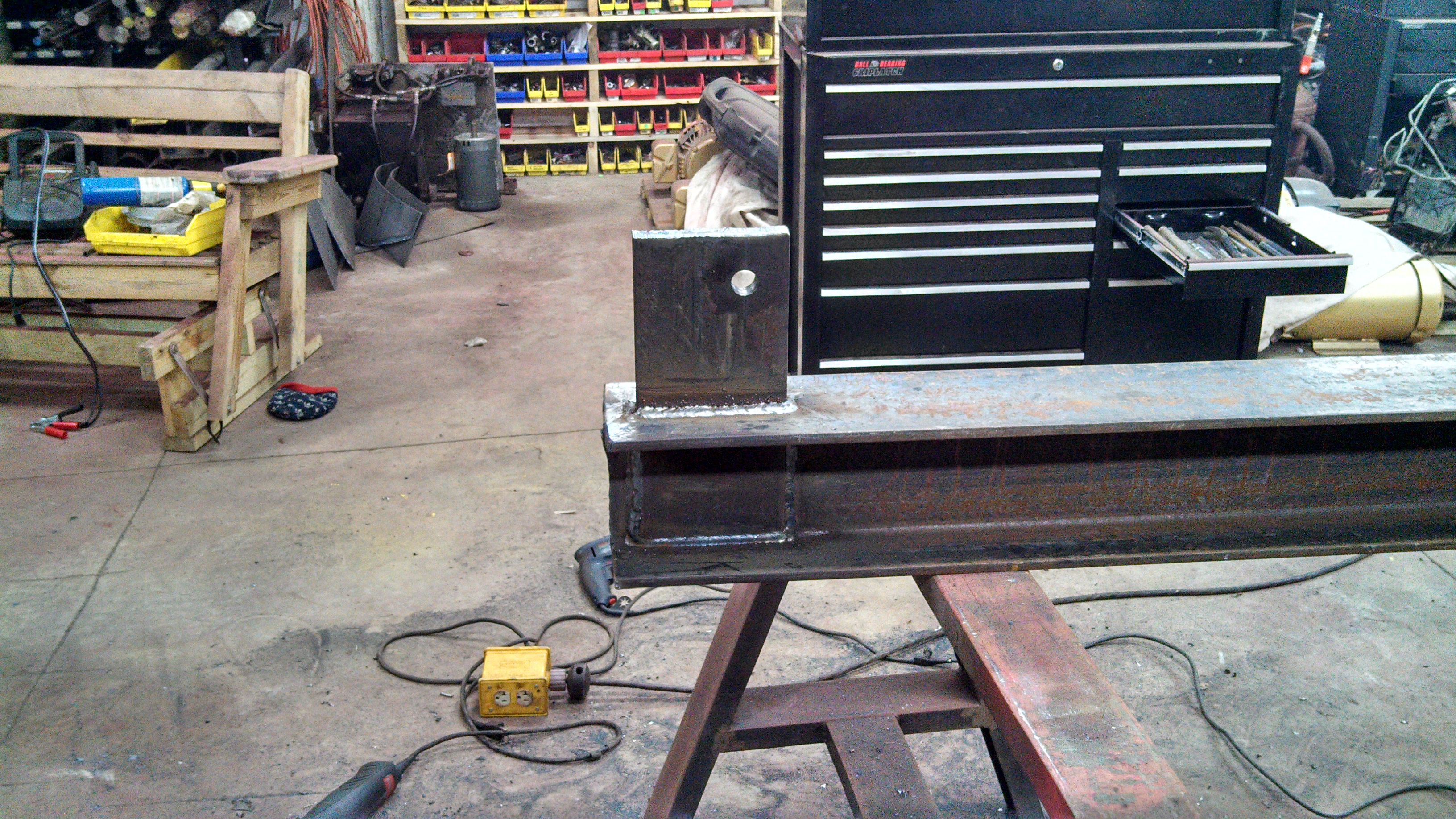

Just need to add an end plate cut the 4 way tube down and weld the axle on
Just over 10 pounds of rod in this thing so far
/ Log splitter build #20
Did you ever mention what size cylinder you would be using?
A potential weak spot I see is the cylinder base anchor/eyelet. Just surface welding to the top of the beam like that. Have seen several splitters rip off a connection like that. Welds were good, it rips out a chunk of beam with it.
I got some pointers from some good fabricators on here, and here is how I ended up attaching the 1" thick wedge and anchor block on my splitter.
