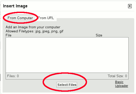

Click on the photo icon at the top of the editing window.
This should pop up a second screen with "From Computer" "From Internet". It is a bit ambiguous, but you want "From Computer" to be selected, then you click on "Select Files".

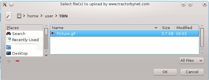

A third screen pops up. Sometimes I find this is backgrounded, so I'll hit "Alt-Tab" to find it.
Select your file and click "OK". You can use the Control and Shift keys to select multiple files if you wish.

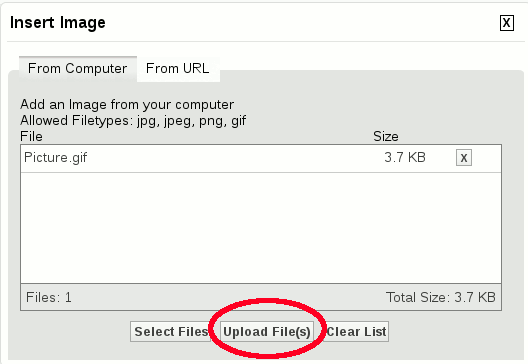

Once you hit "OK", it brings you back to the second screen. Just click on "Upload Files". Don't click on the "X" unless you don't want one of the files. Clicking on "Select Files" will take you back to add more files.
Once you've added the photo, you should see something like this in your message. Put it to where you want the photo to show up.

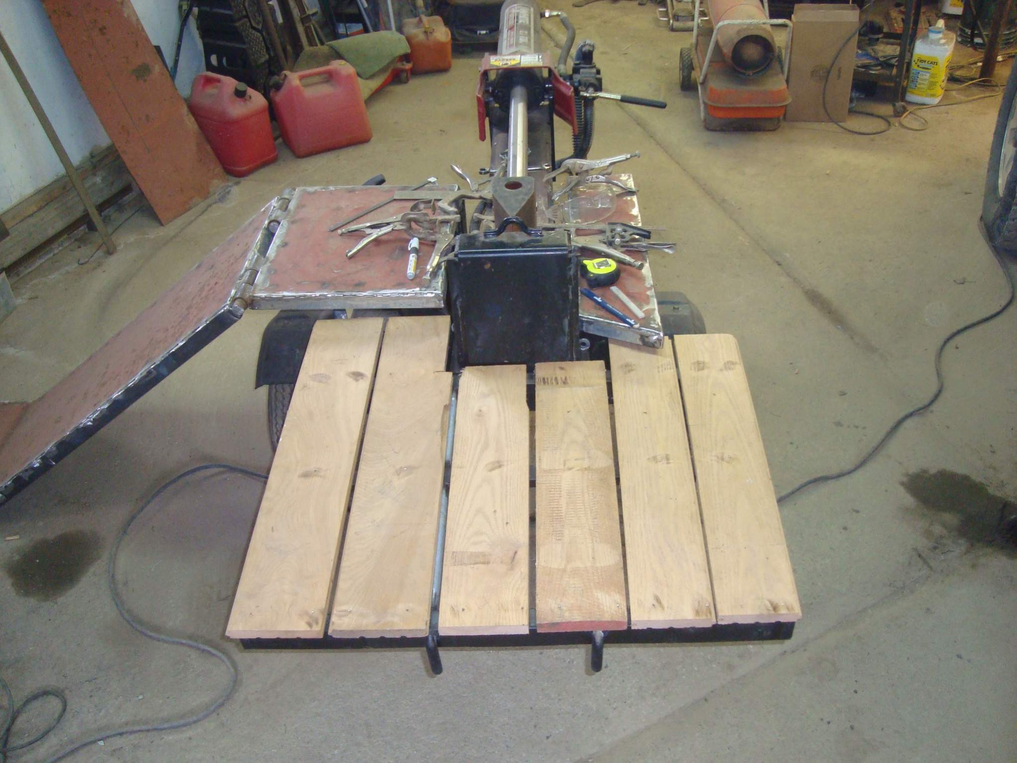

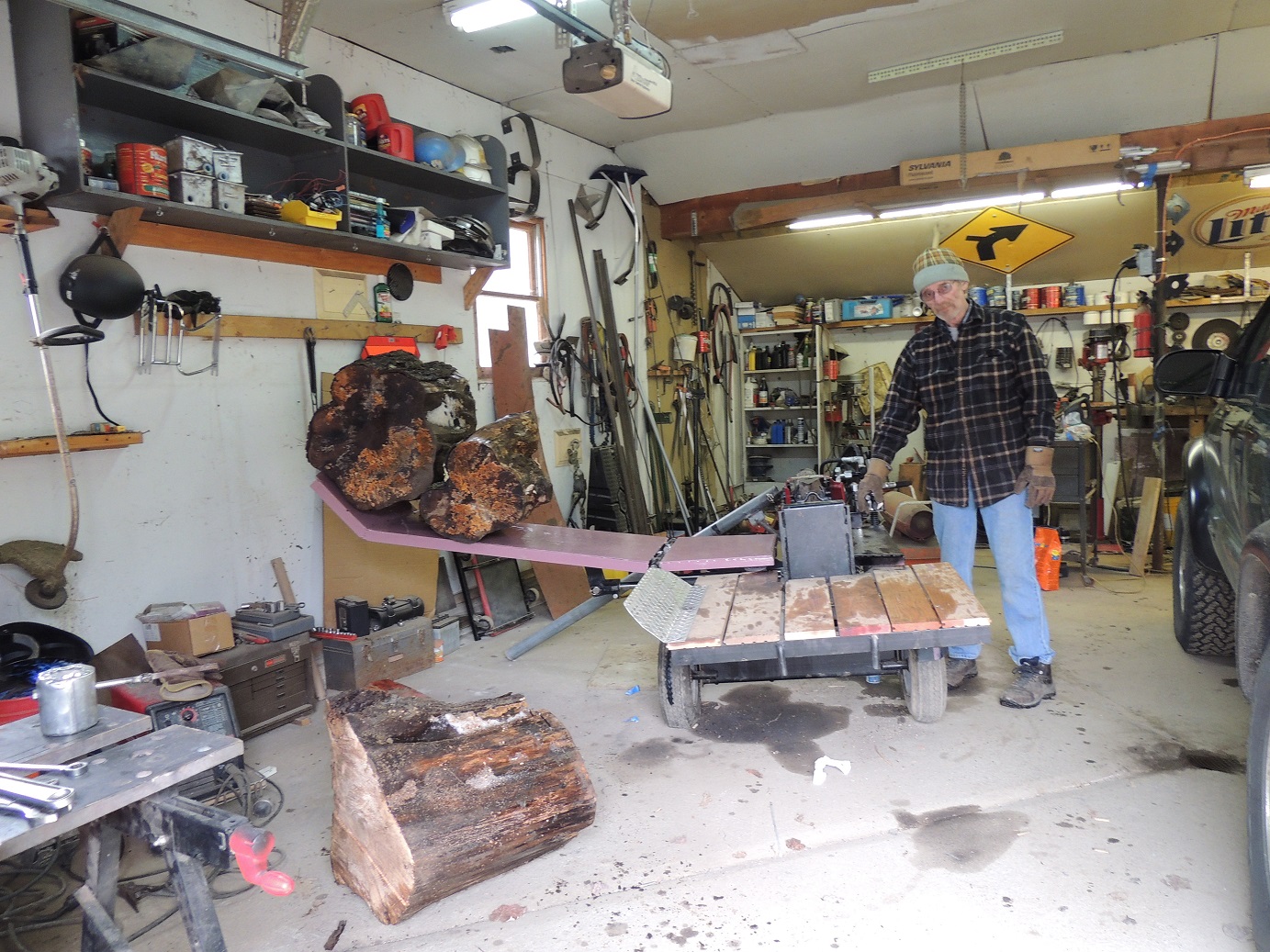

splitter 1.jpg Thanks CliffordK This is the first Pic where I build the side tables .. Small table where she stands and a larger one for the in feed side..
   / Log Splitter lift table build #12
Glad you got the photos working.
It looks nice.
Is the table on the left for loading the splitter, and on the right for unloading? Of course, you still have half the split piece on each side, but I assume it is easy enough to shove it aside.
It is hard to tell height from here, but I assume the left table is at the same height as the bar in the splitter.

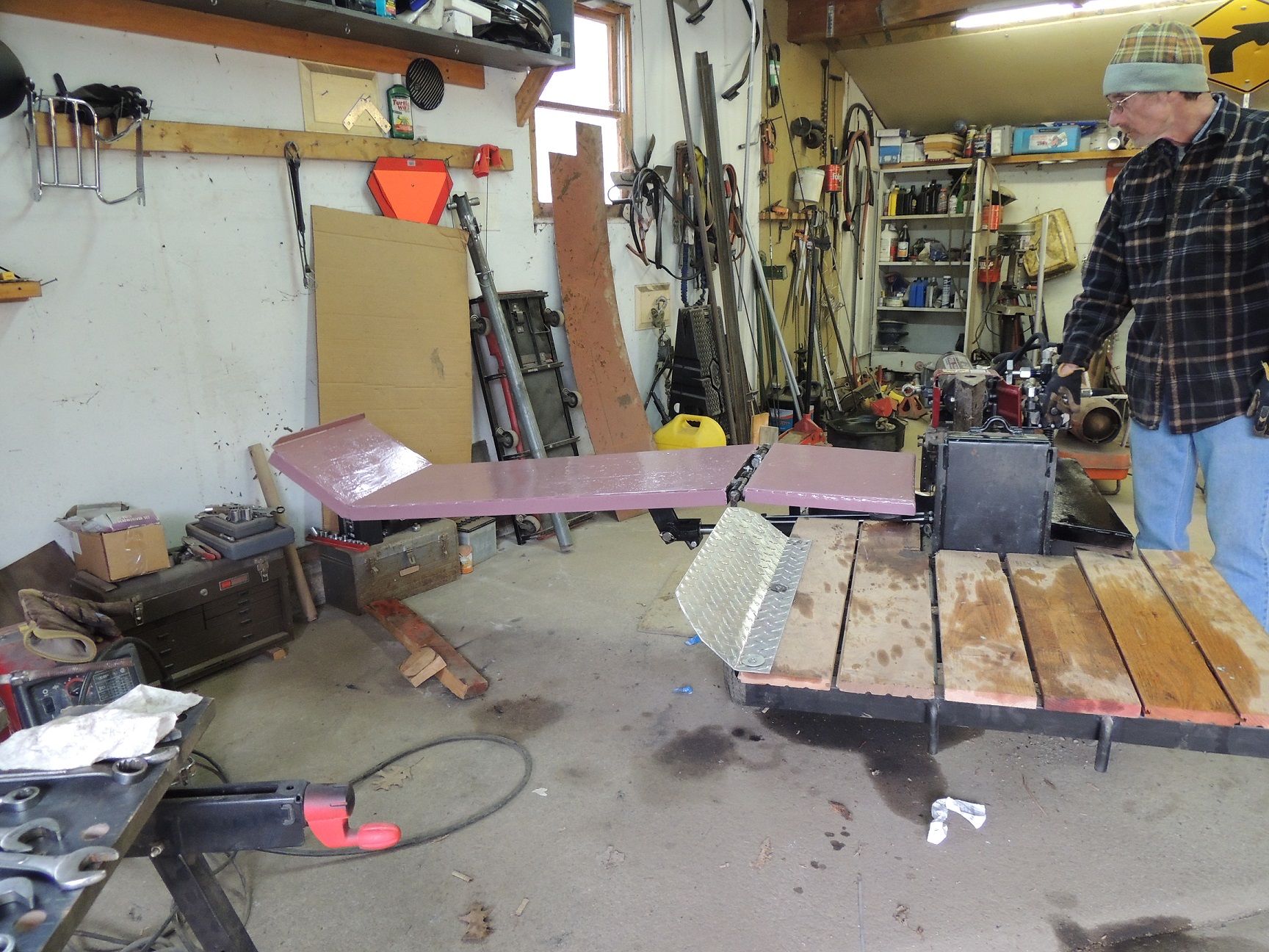

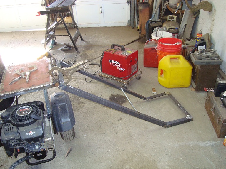

DSC00003.JPG This is the hinges going on to the lift table,, I used 1" black pipe and some 1" rod stock I had kicking around,,

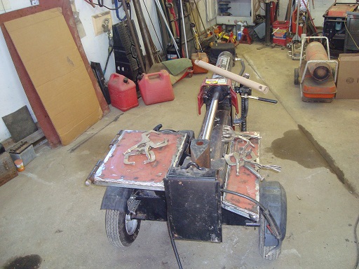

splitter3.jpg Here is the accumulator table done,, As she splits she fills up this table and then throws them in the loader to take to the pile,,
I have to wait for the wife to load more pic's on the stick so I can show you more..
The whole thing when stored in the barn will fold up so that it keeps the same footprint as before,,,

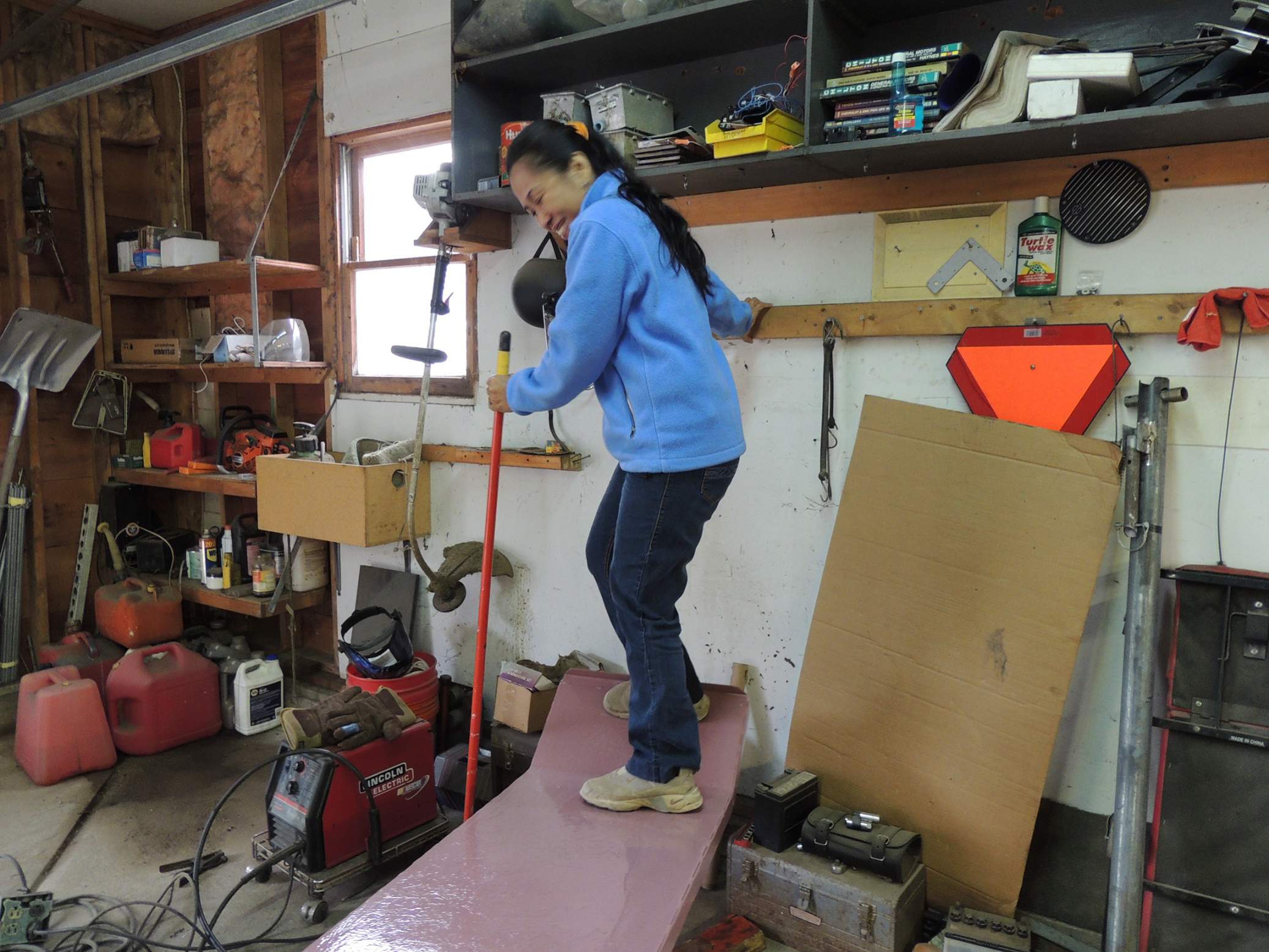

DSCN0006.JPG The real weight test,, notice the support leg on the other side of the lift table.. After she finished 6 cord with it this year she found that you could fill the table then just roll them up to you when ready ..

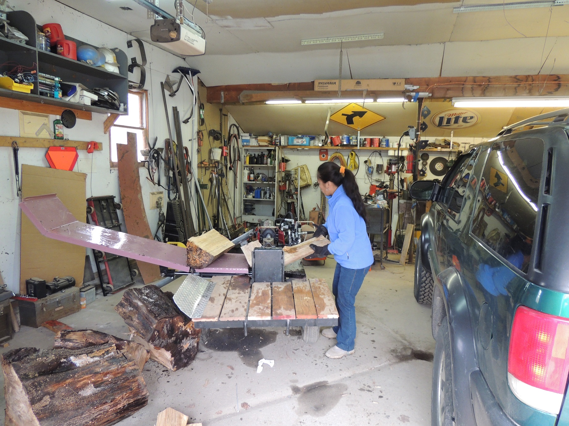

DSCN0011.JPG Final test in the garage,, She likes it,, :)
#20
One thing she did find out while using it is if you get real round big ones,,, Don't lift too fast.. One rolled right through the splitter onto the ground,, She stepped out of the way.. We didn't get pictures of it out in the field but still have a few apple tree butts to do,,
