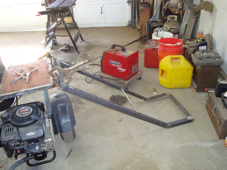

splitter 1.jpg Thanks CliffordK This is the first Pic where I build the side tables .. Small table where she stands and a larger one for the in feed side..
   / Log Splitter lift table build #12
Glad you got the photos working.
It looks nice.
Is the table on the left for loading the splitter, and on the right for unloading? Of course, you still have half the split piece on each side, but I assume it is easy enough to shove it aside.
It is hard to tell height from here, but I assume the left table is at the same height as the bar in the splitter.

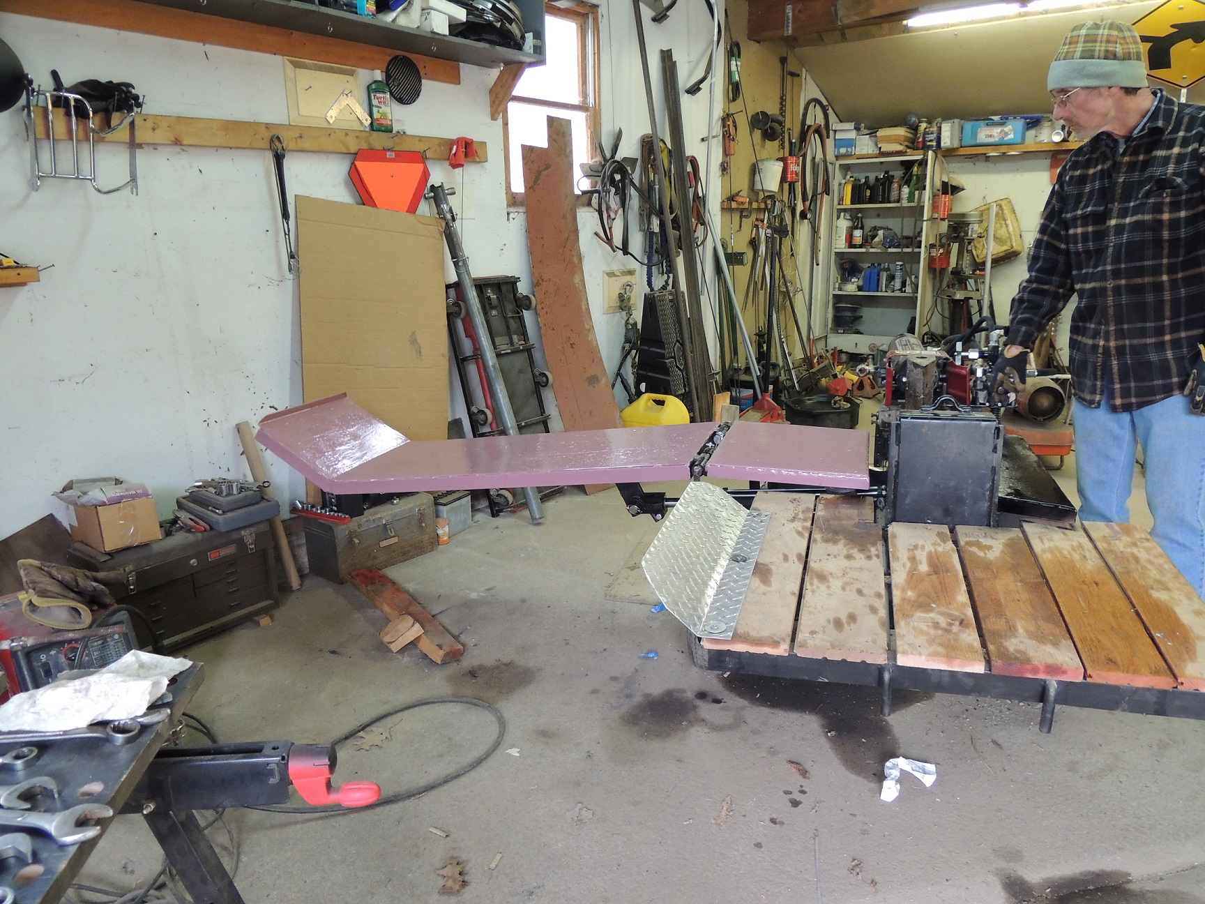

DSC00003.JPG This is the hinges going on to the lift table,, I used 1" black pipe and some 1" rod stock I had kicking around,,
#14
It looks nice.
The table on the right is just there to give a place to slide the split piece out onto the accumulator table..

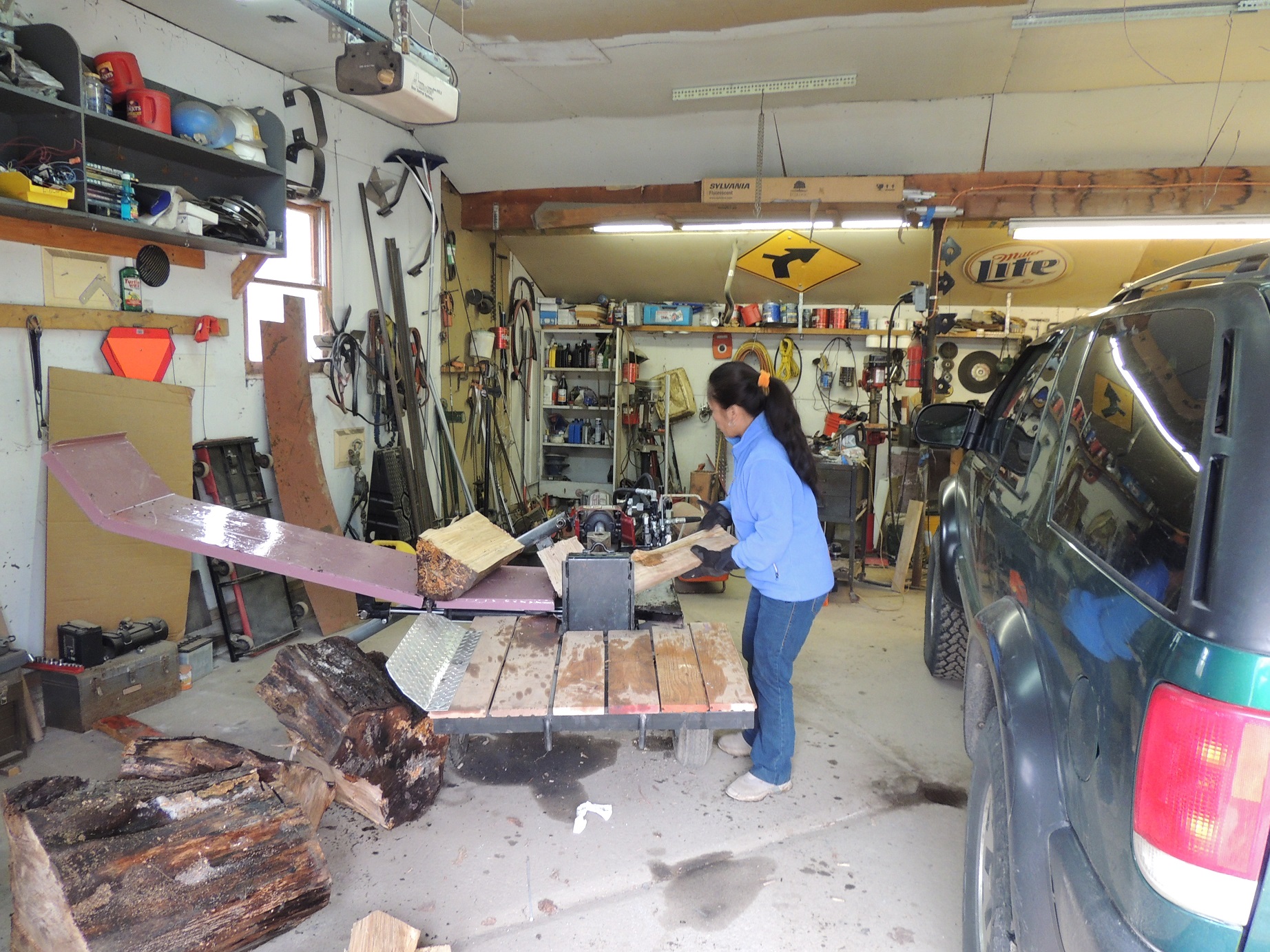

DSCN0004.jpg Weight test is done now for a log,, Opps I forgot to put on the stabilizer bar.. I'll install it before the log though..

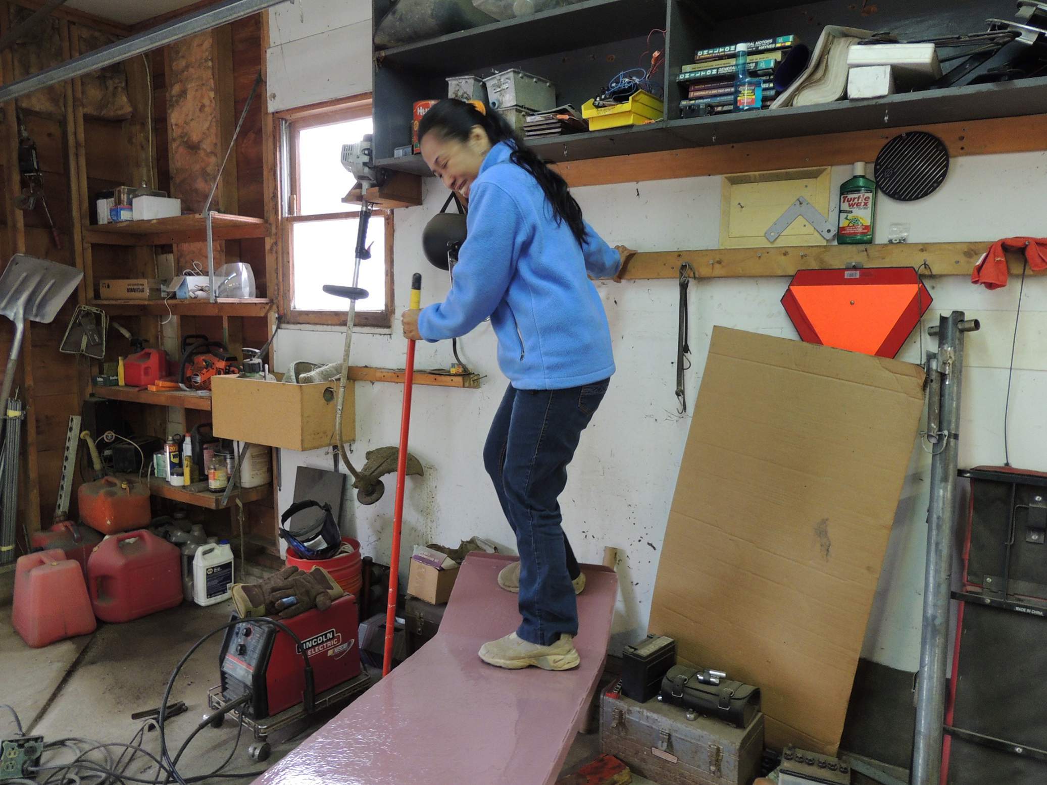

DSCN0006.JPG The real weight test,, notice the support leg on the other side of the lift table.. After she finished 6 cord with it this year she found that you could fill the table then just roll them up to you when ready ..

DSCN0011.JPG Final test in the garage,, She likes it,, :)
#20
One thing she did find out while using it is if you get real round big ones,,, Don't lift too fast.. One rolled right through the splitter onto the ground,, She stepped out of the way.. We didn't get pictures of it out in the field but still have a few apple tree butts to do,,
