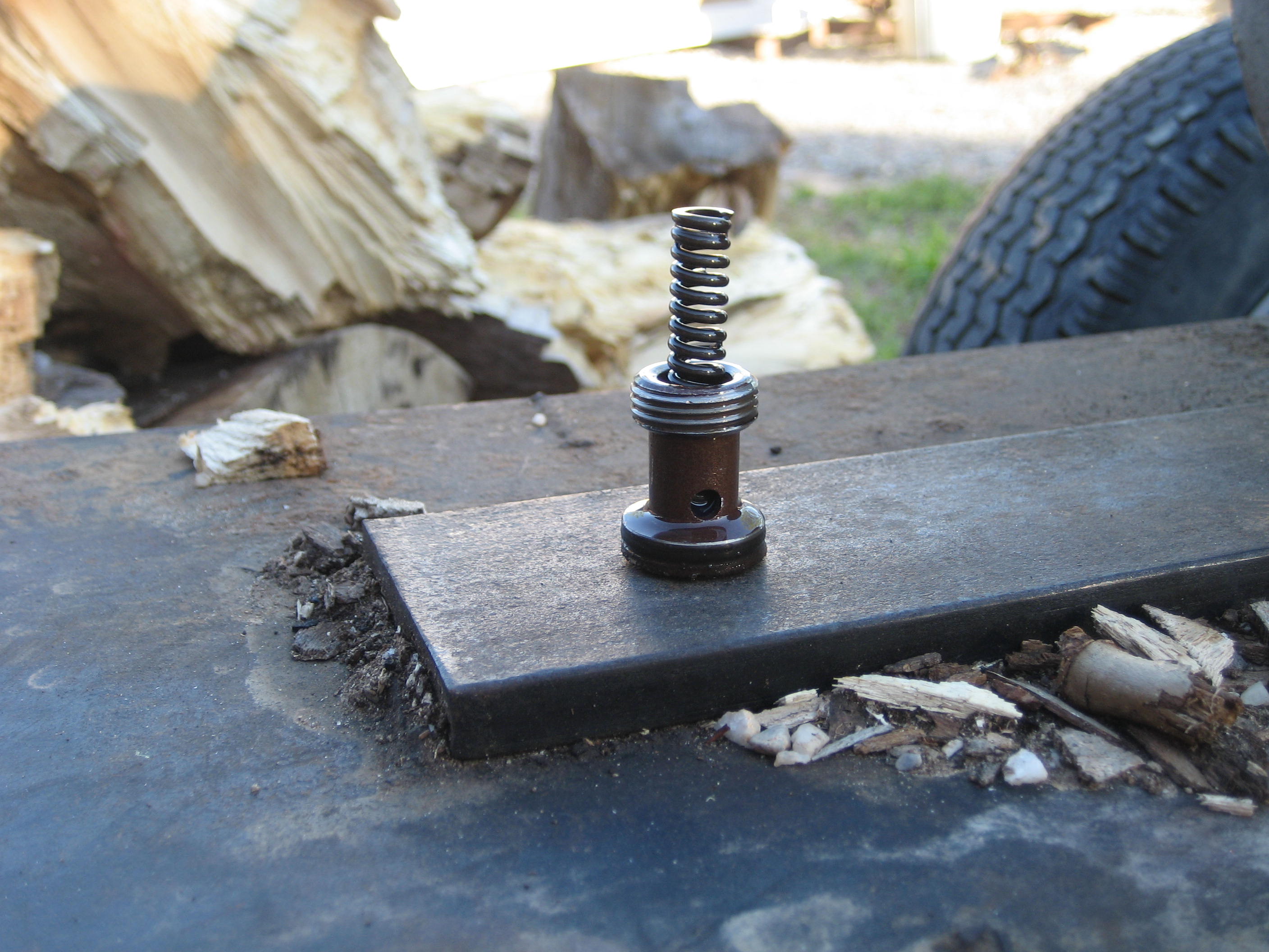

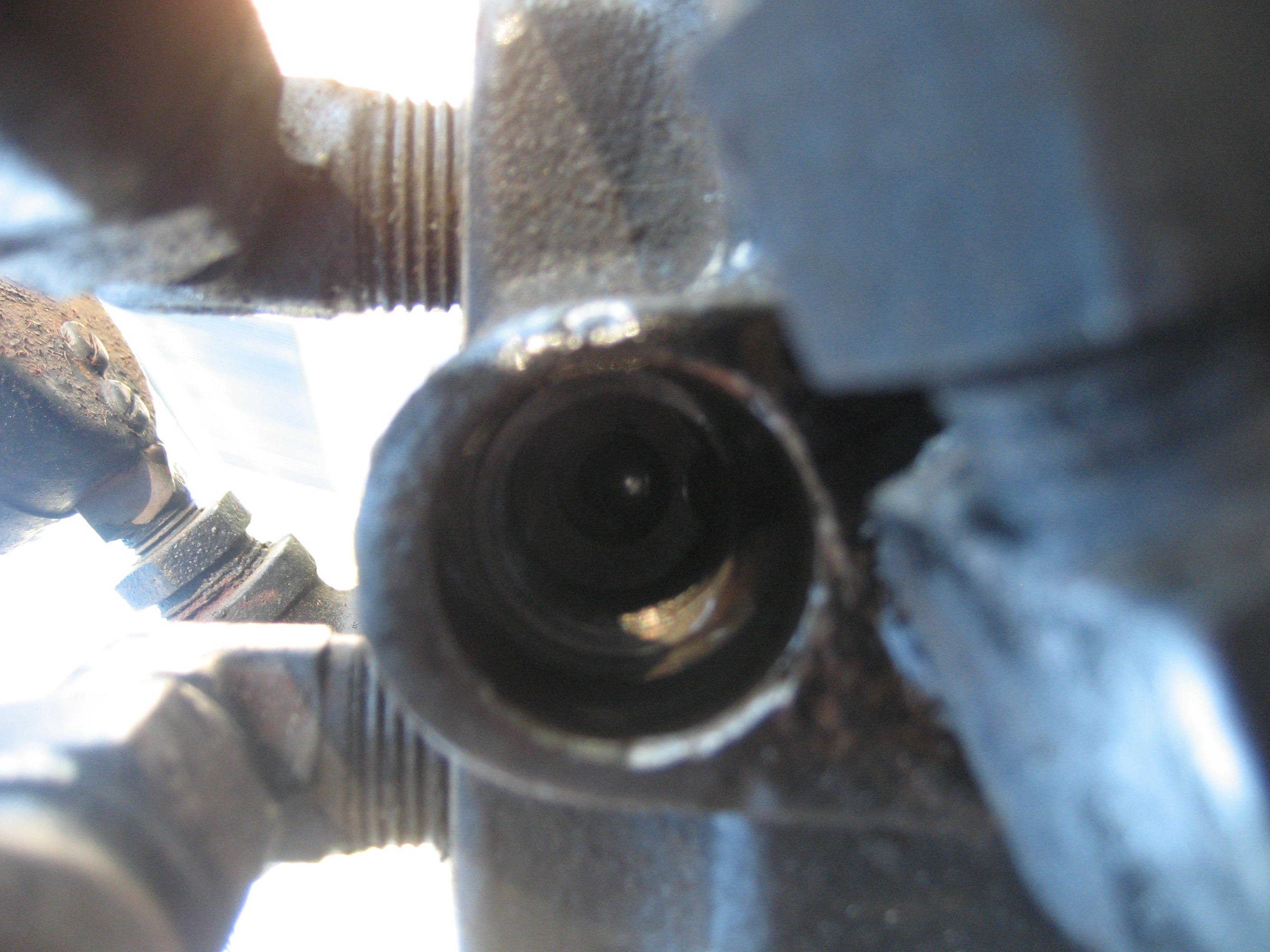

Well making a divit on the edge of the plug and hitting it using a punch and hammer several times did the trick. I started to think it was not going to do it but it finally gave way.
But, I did not find what I thought I would. There is not a pressure adjustment screw. Just a spring and steel ball pressed against the inlet side. I guess a new log splitter valve is needed.
Now, since my cylinder is 6 inches doesn't that require a different valve compared to smaller cylinders. I thought I saw that somewhere.

The control valve should be able to handle the volume from the pump.
The PDF you showed had an adjusting screw. Apparently what you have is an older valve with a non adjustable relief.
/ Log Splitter Pressure #23
the plug ,spring and steel ball are your PR, to adjust it you turn the plug in to increase the pressure and turn it out to decrease it. the plug pushes on the spring that pushes on to the steel ball. the more spring tension applied on to the ball the more hydraulic pressure needed to move the ball off its seat to release oil back to the tank side of the valve. the balls seat is just a hole between the in port and the tank port.
as far as the valve being to small this is not a problem in your case because of the pump size, at 4 to 5 GMP and a 6 inch cylinder you will have a slow machine. at 6 inches you require at least 16 GMP to increase the speed to a good workable speed. Jim
