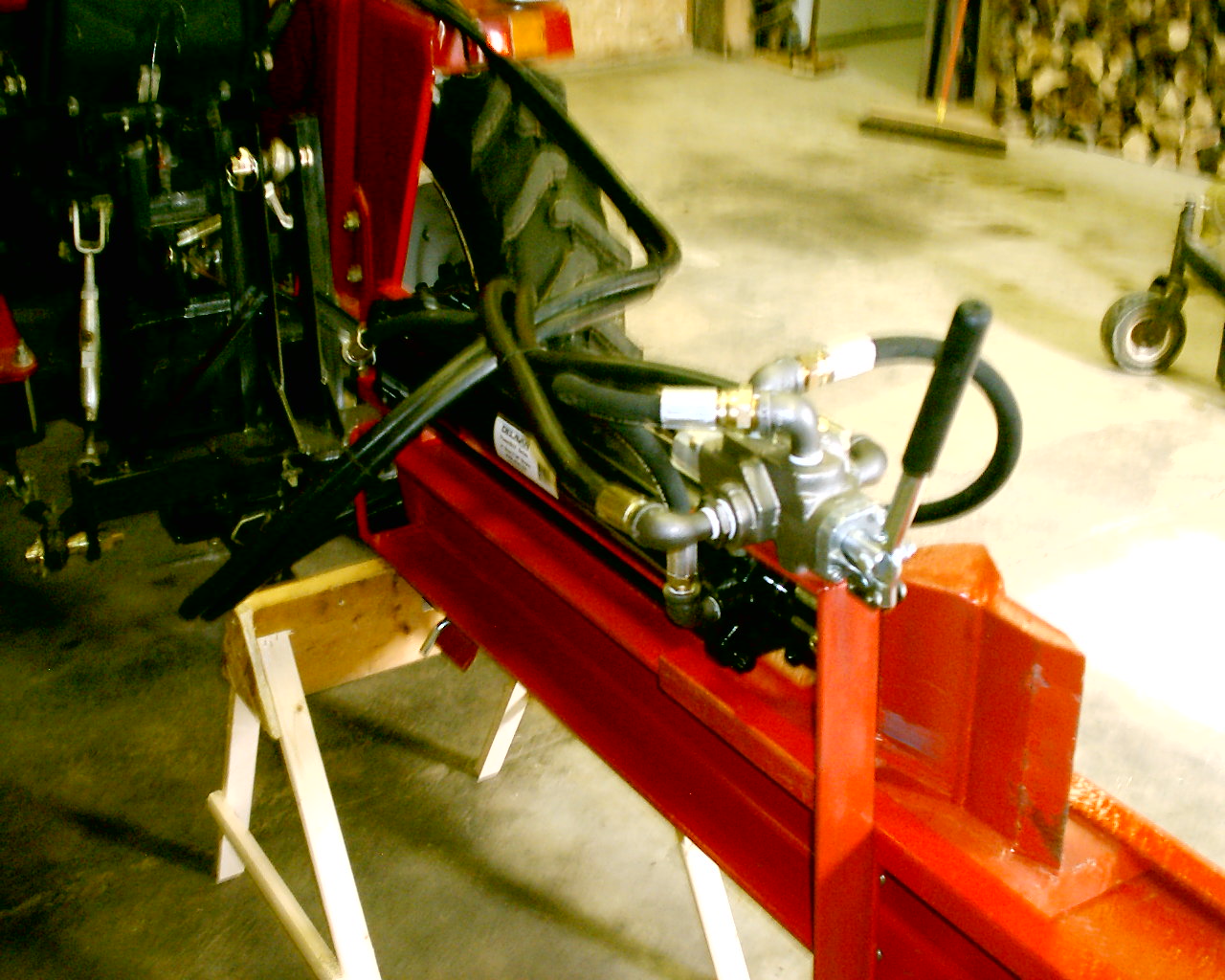

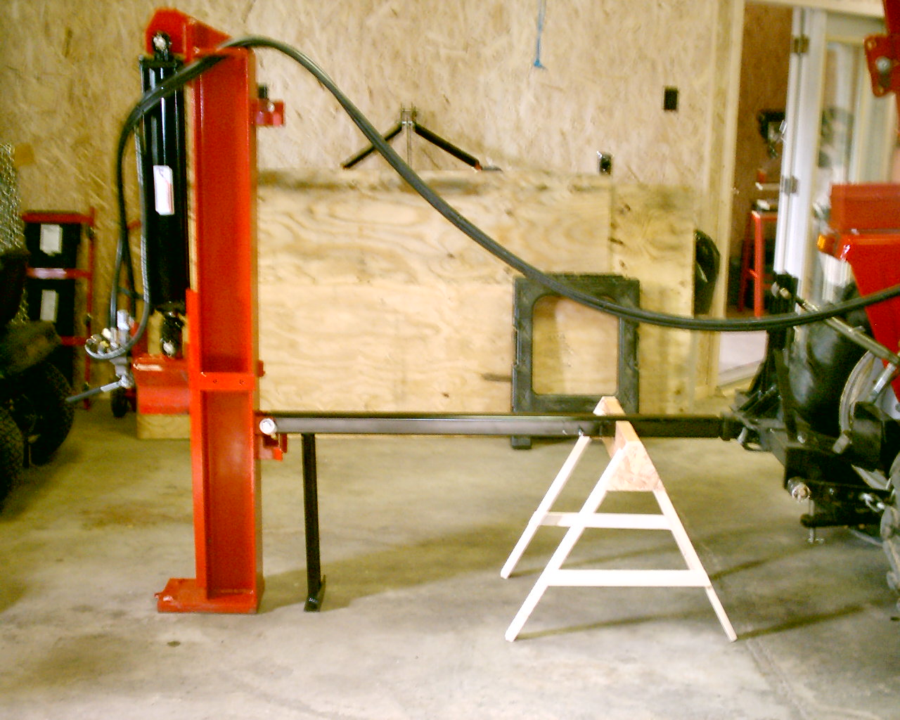

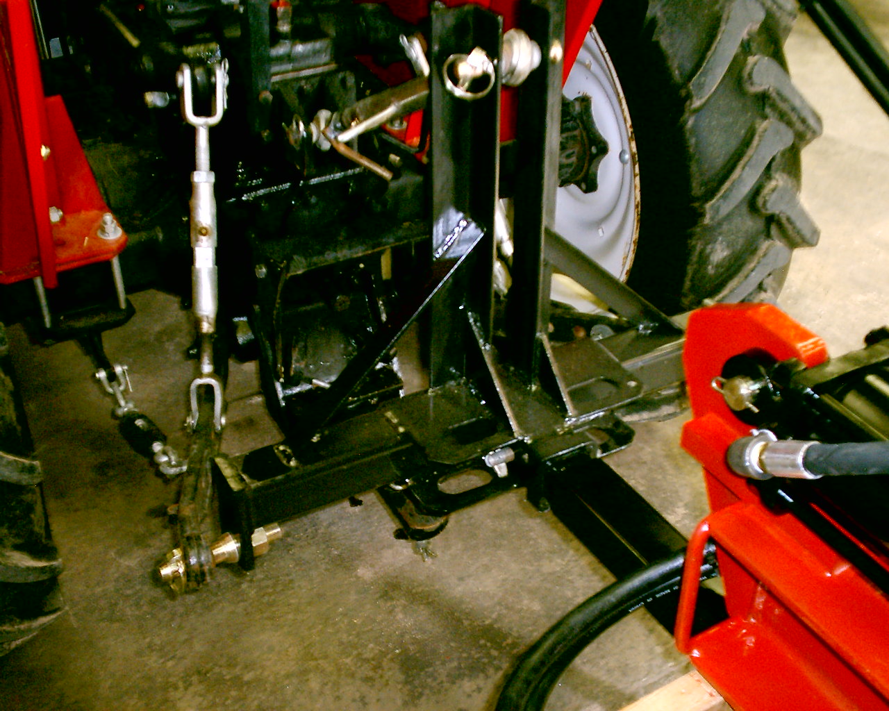

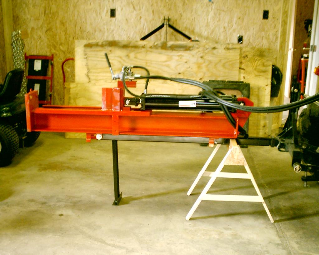

Here is a pic of a log splitter I made for my 3 point. I bought the beam off a wrecked tow behind unit then started fabricating. I did not like the store bought units since they only allowed access to one side of the splitter. I usually split with a buddy. I had to fabricate the frame, hitch, wedge, then put together the cylinder, hoses, and valve. I have about $400 in it. It goes horizontal and vertical and runs off my tractors hydro system. It will split anything I throw at it and I am guessing it has about a 6 or 7 second cycle time at 1300 rpm's.
Chris

Here are a few more pics.
Chris
