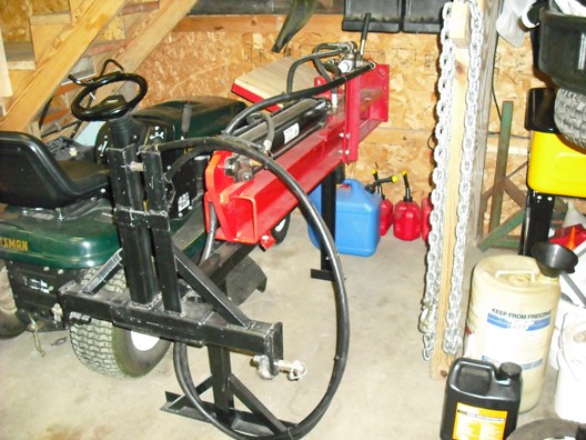

UPDATE FROM Thom2
Diamondpilot was RIGHT. The cylinder is shot. I'm off to the TSC store to pick up a new cylinder. Special $229.
Heavy-duty Double Acting Cylinder, 24 Stroke x 4 in. dia. - 1837573 | Tractor Supply Company
I'll have the old one rebuilt to have as a backup or rig it on something else.
Thanks Folks, Thom
I am not happy I am right but you can get it rebuilt for about $50 if there is noting needed other than seals.
As for the valve. I would put back on the one that it came with. Top off your fluid and send the Price Valve back since its not really a log splitter valve or keep it for another project.
By the way things have sure went up. I built my own splitter 5 years ago and got my cylinder at Rural King, just like TSC. Anyway its a 4" x 24" stroke just like the one you showed for $99.
Chris
