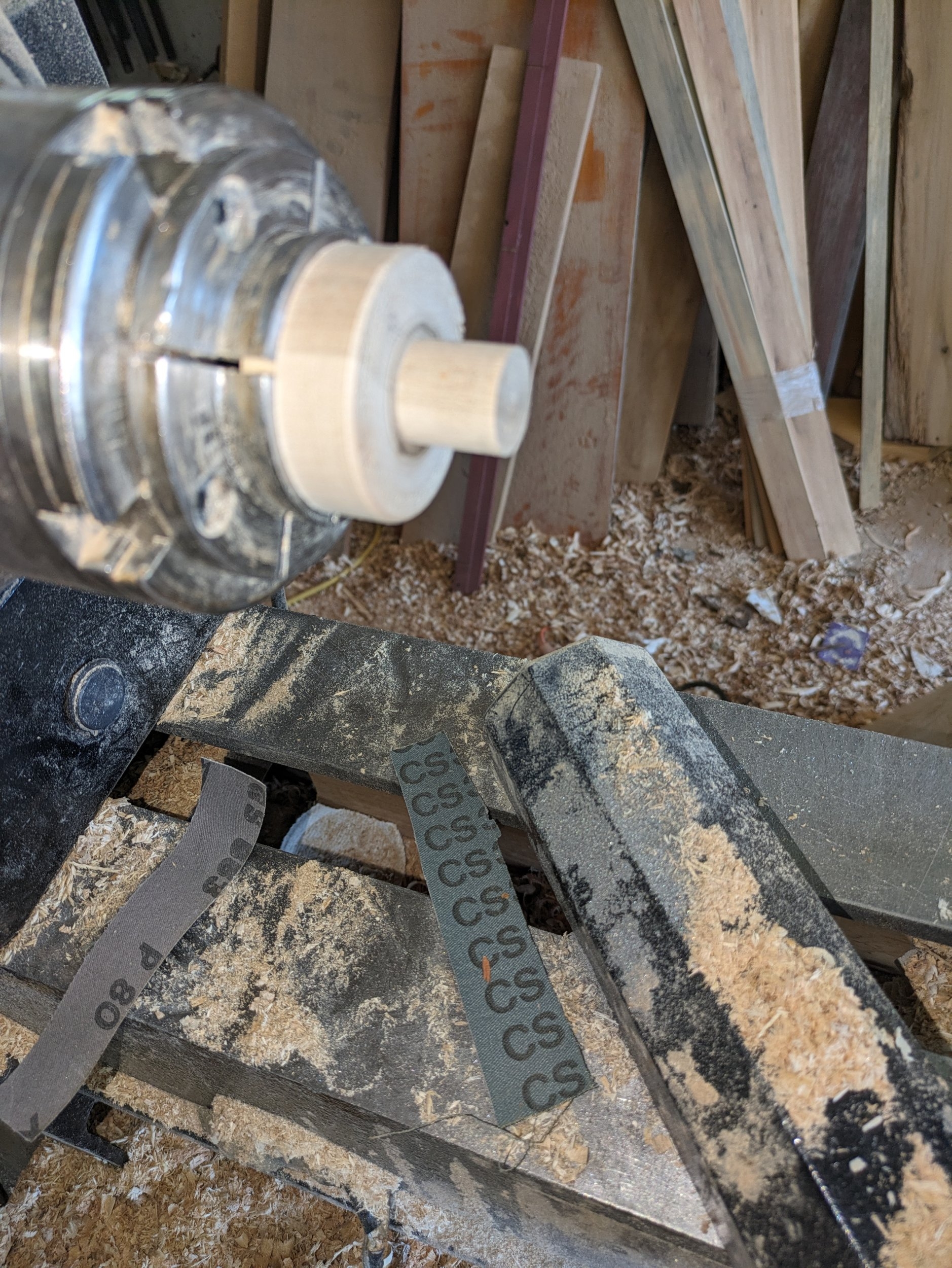

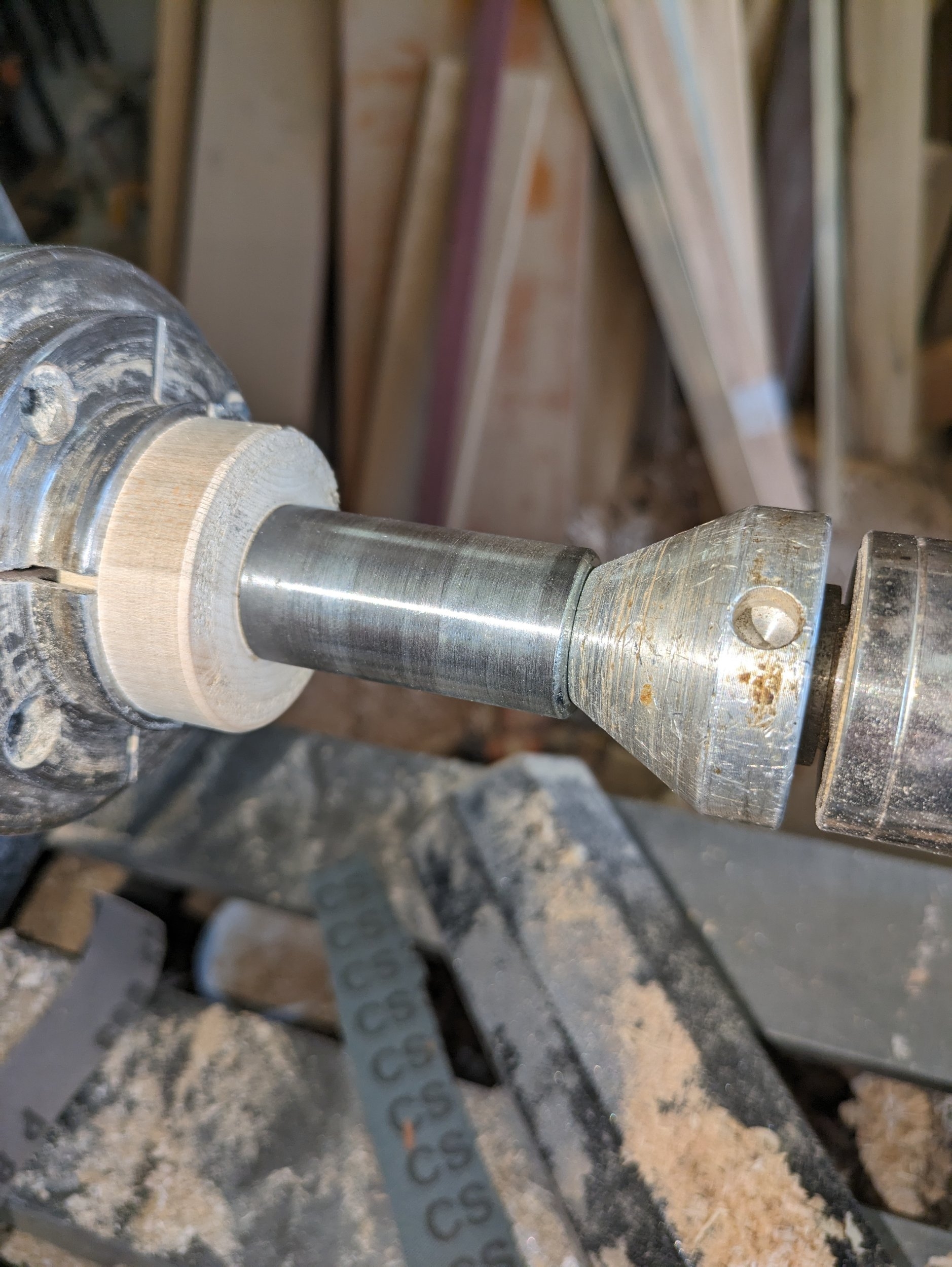

Update: I bought 5 of the 3/4"x1" bushings at Lowes for $1.50 each, so about half of TSC. They were 1" to a few thousandths over so I made a jig on my wood lathe that they would slip over and used a file and sandpaper to get them a few thousandths under 1". I have not gotten around to taking the old wheels off yet but am assuming that axles are a bit under 3/4" and bushings will slip over them but I have a 3/4" drill bit in case.
