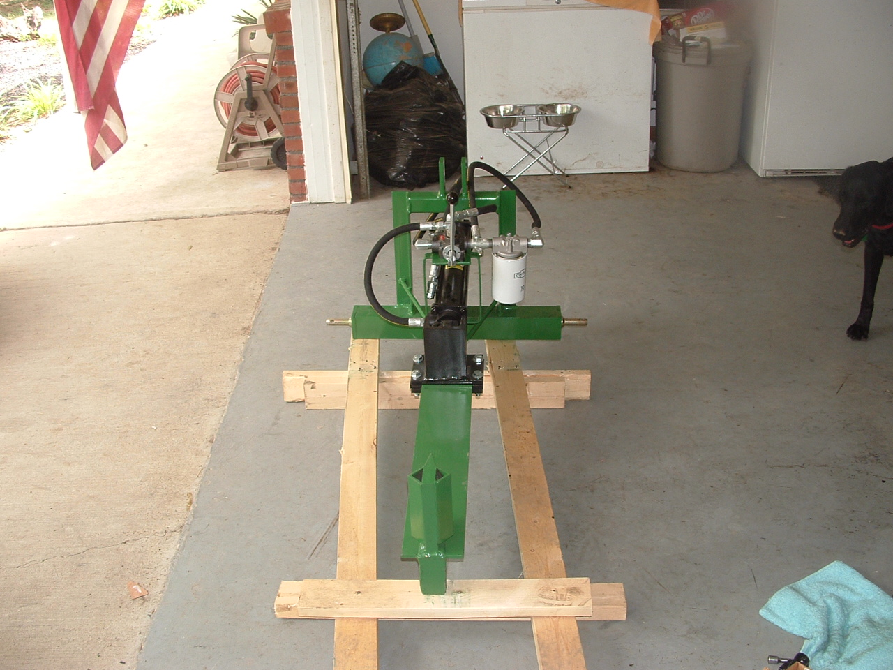

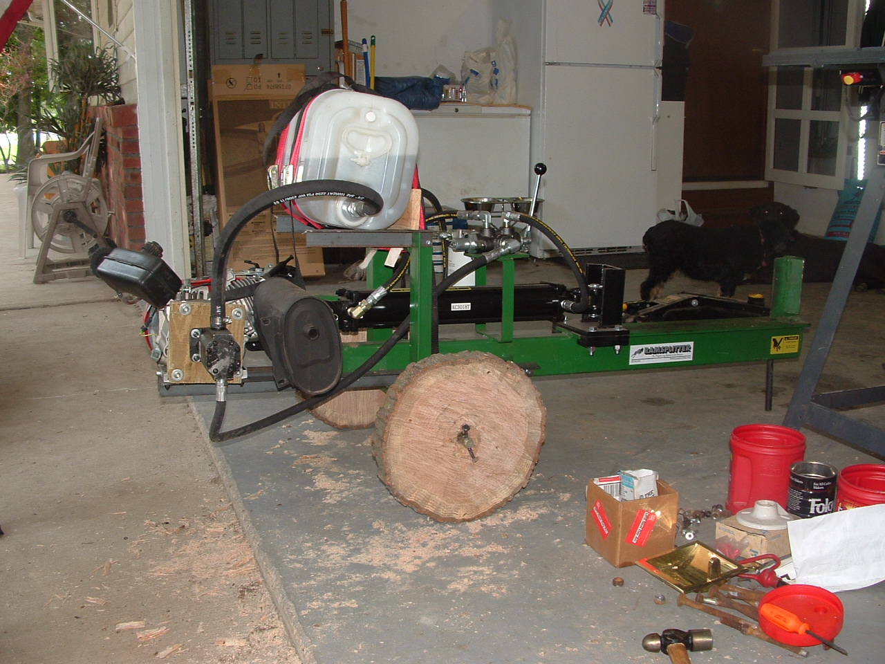

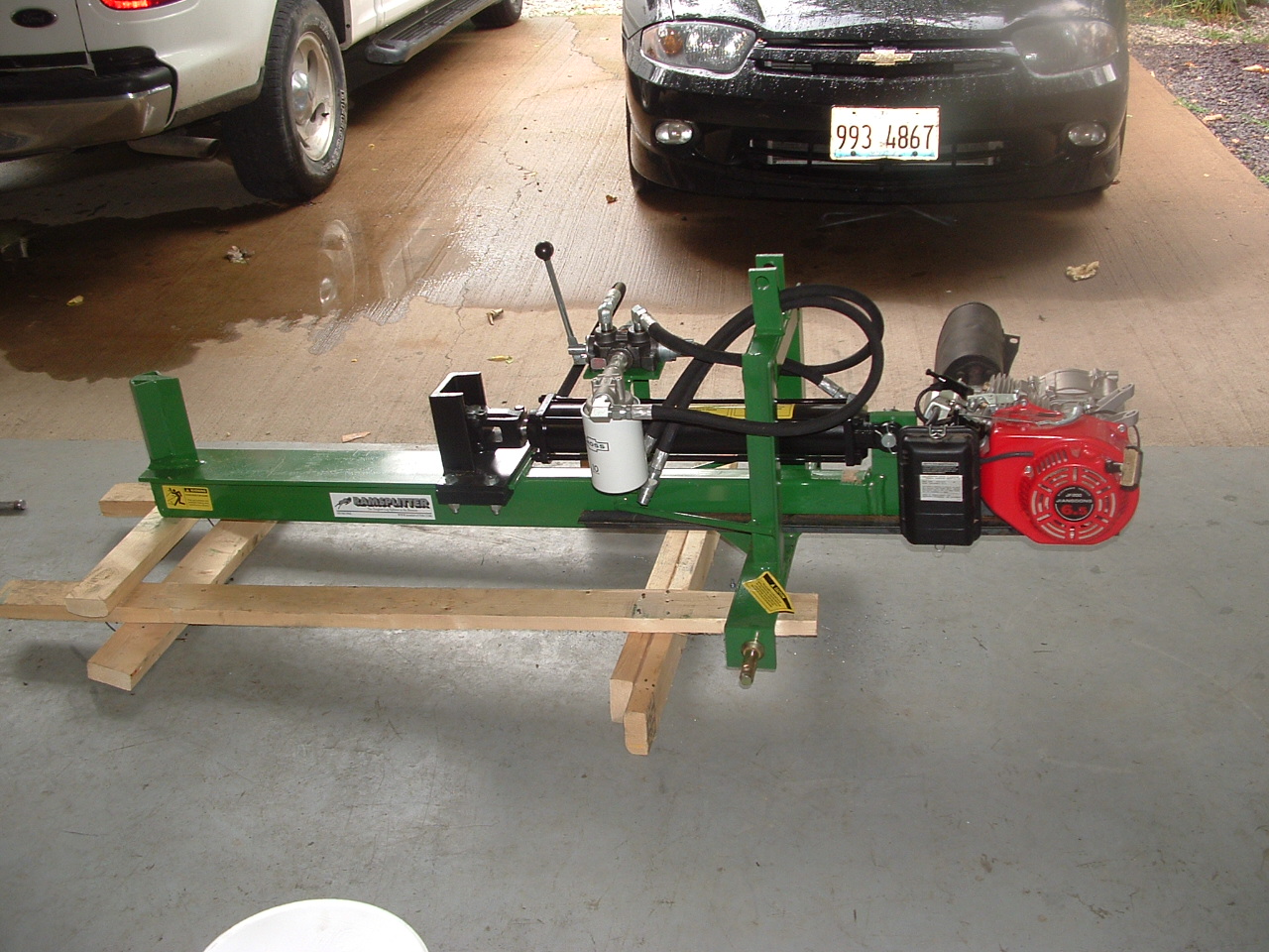

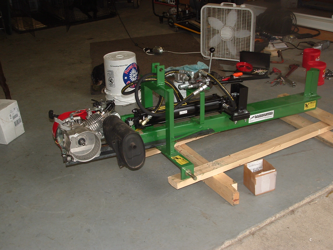

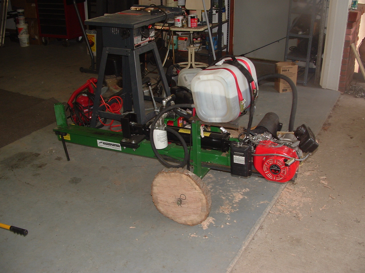

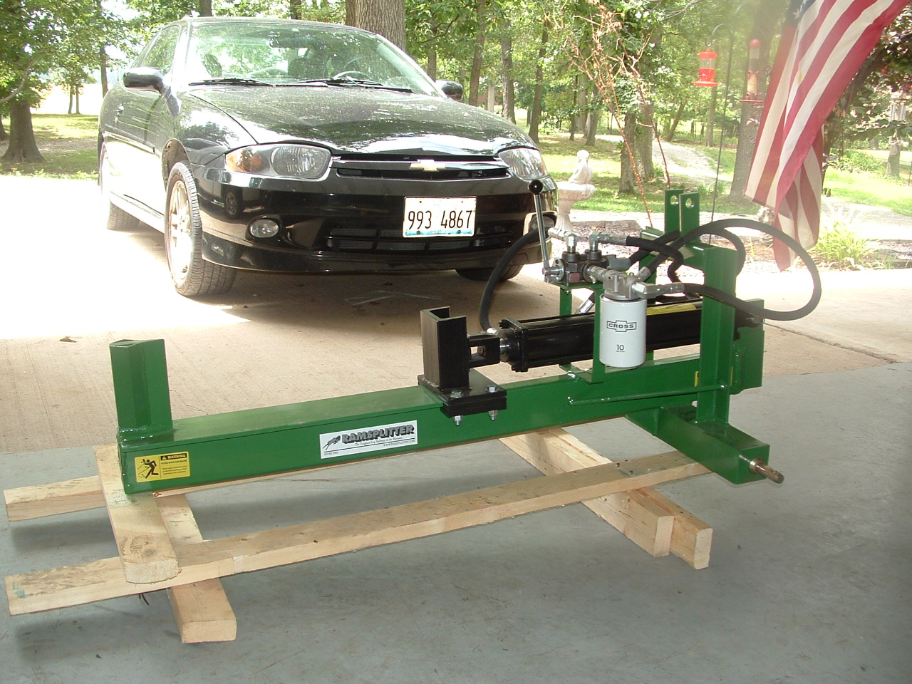

I just bought a 3ph log splitter on E-Bay. But I built a place to put a 6.5 hp motor and reservoir because I don't have a tractor. I got it this way cause it was cheaper than buying one built already. I also had to buy a pump but still the total cost was under $600.
Take a look at the one on e-bay. It may be just what you're looking for.
Joe
eBay: Log Splitter, 3 Point Hitch Attachment 16 Ton (item 280134615649 end time Jul-20-07 20:00:00 PDT)
Joe did you get it yet? what is the quality like? Anyone else have any input?
   / Log Splitter #24
Yea...I got it and it runs great. I have used it several times in the past week. It does seem to get a little warm (the fluid and hoses) but like other guys, I get tired after about two or so hours of splitting wood, so I give the maching a rest.
I got my camera back so I will be posting pictures of it here as well as on the Hydraulics Forum.
Joe
   / Log Splitter #25
Pics are here! I've upgraded the fuel tank and, umm, wheels/tires since these pictures. LOL:D
