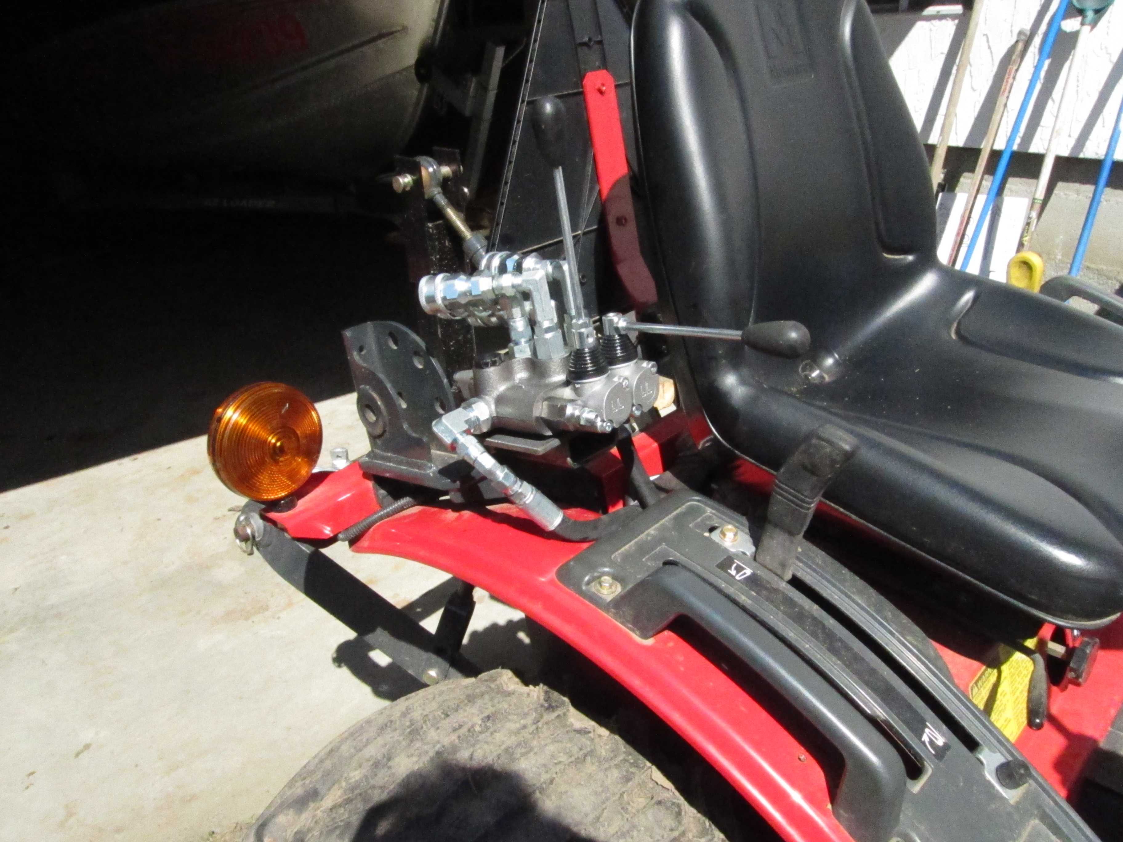

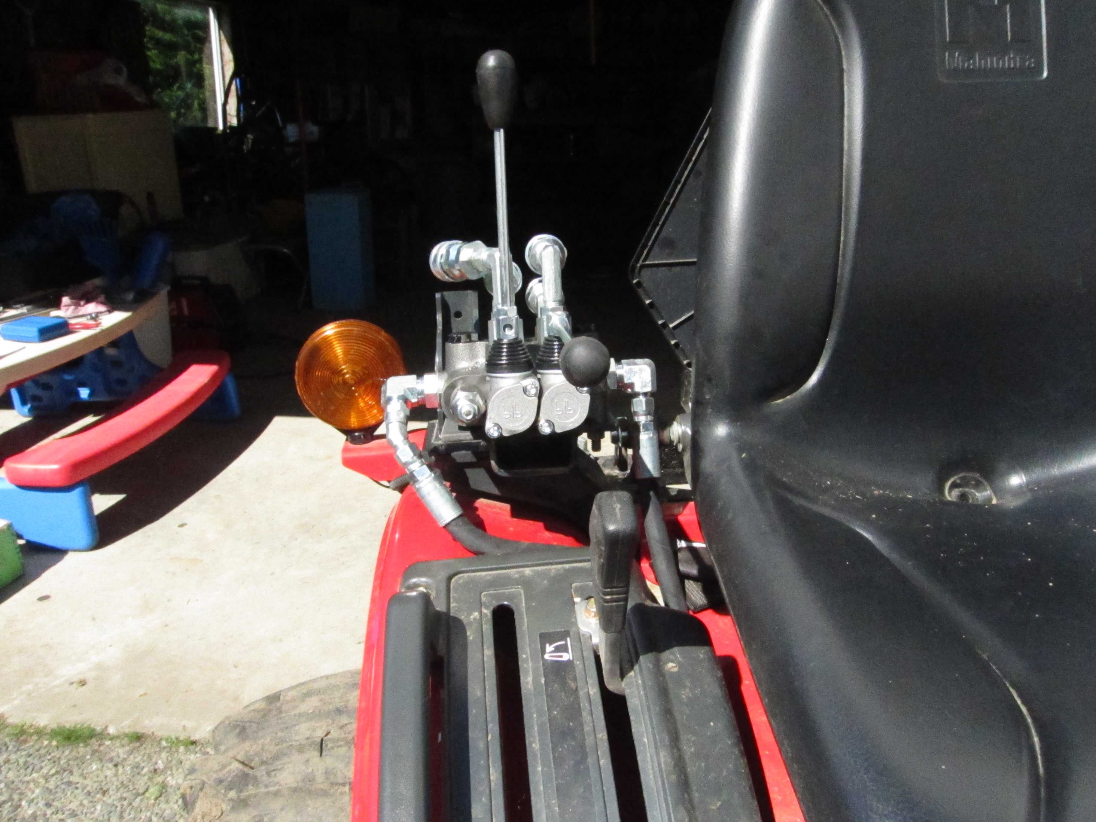

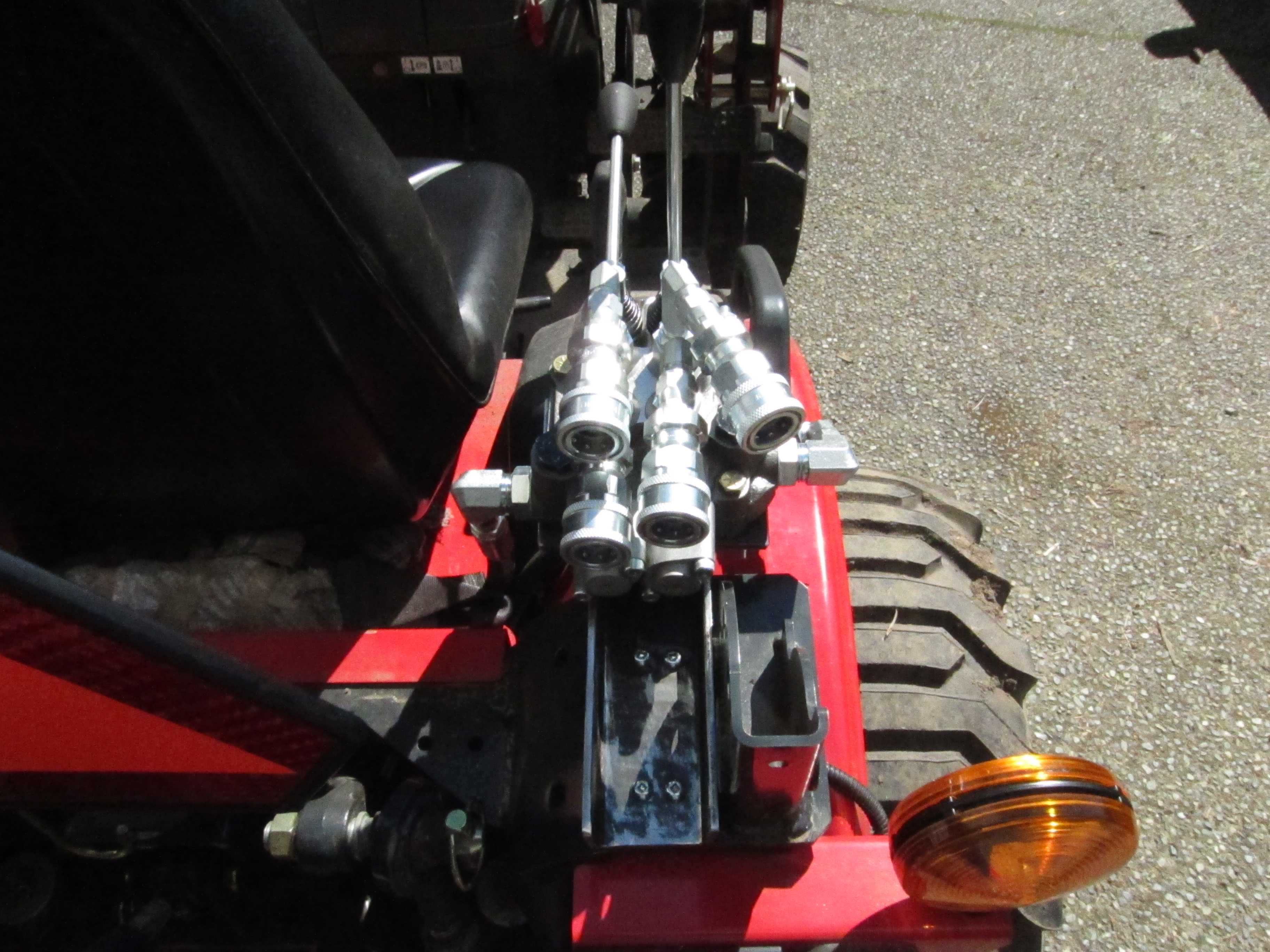

I have an 1815 and have the same thing in mind to run a 3-point hitch splitter off the tractor.
I just installed the power beyond kit and a 2 spool remote valve.
I got a used cylinder and I'm having the base and top bracket welded to an I-beam at a local welding shop.
I know it will be slow but it beats splitting by hand.

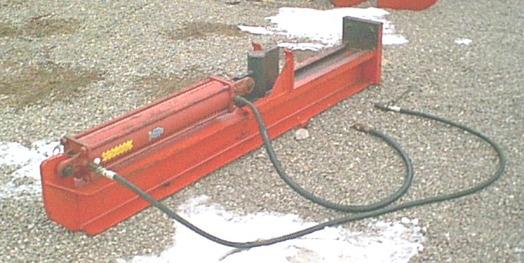

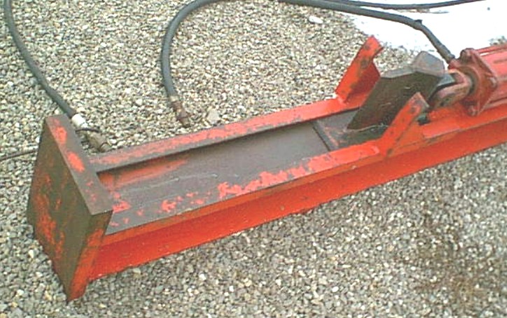

If anyone has the same idea, I have one that is already welded up. $375. Ken Sweet
