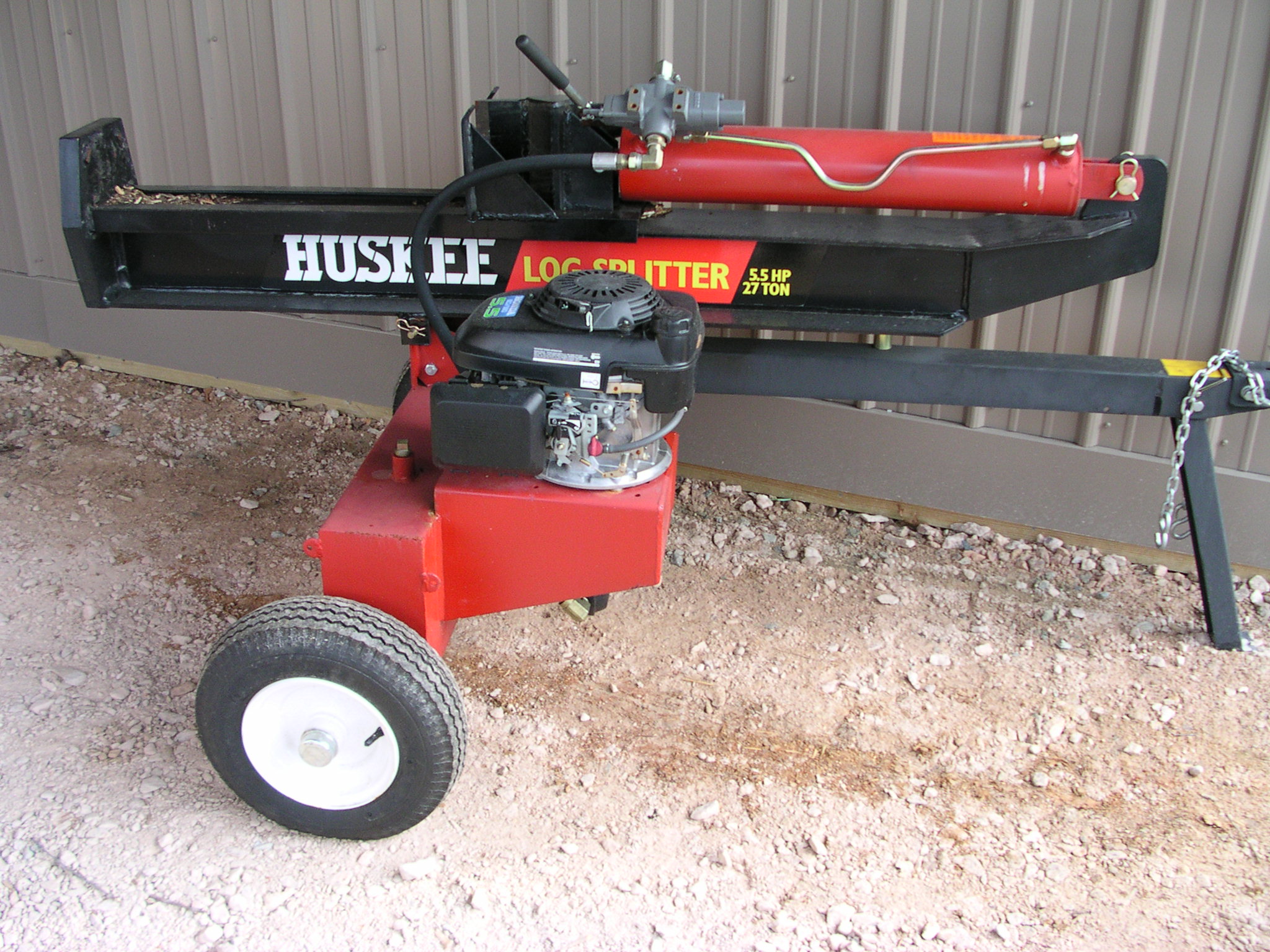

I picked up this one from a local TSC store a couple of years ago and have been very happy with it. I especially like the position of the control spool lever which allows me to operate it by myself.
Since I took this picture I've replaced the crappy stand with an adjustable top-wind swing-away and made a log rest platform on the far side. Dropping splits on my foot got to be old in a hurry.
I've never tried anything it wouldn't split even a 18" gum that produced a lot of cussin' and fumin' on my part.
Years ago I owned a store-bought and a home made splitter that needed fixing as much as it worked so I was pleasantly surprised this little guy has held up so well. I think the current crop are far better made than those of 15-20 years ago.
Just my .02.
