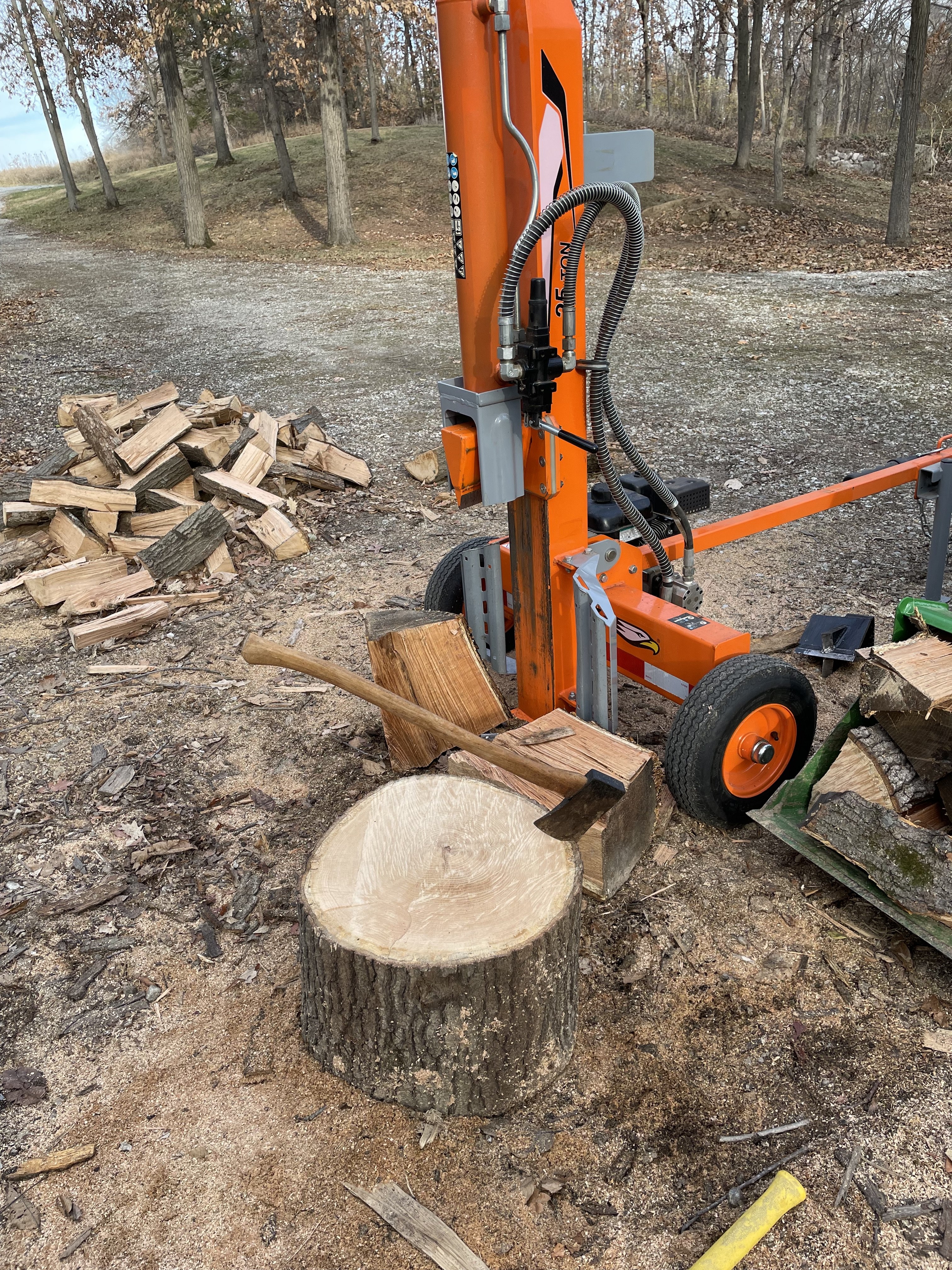

Like Big Bubba said I just roll large rounds over to the splitter. You can move some really big ones this way, then if you’re good when you tip them flat they end up in the vertical splitter. I’ve also learned to use an axe to help for leverage for moving the rounds, just sink the axe head in. I also use a round to sit on when splitting the larger ones.
One advantage to owning one is you can just work a couple of hours a day, no need to rush.
A picture of how I setup for large rounds, tge round with the axe is the one I sit on.

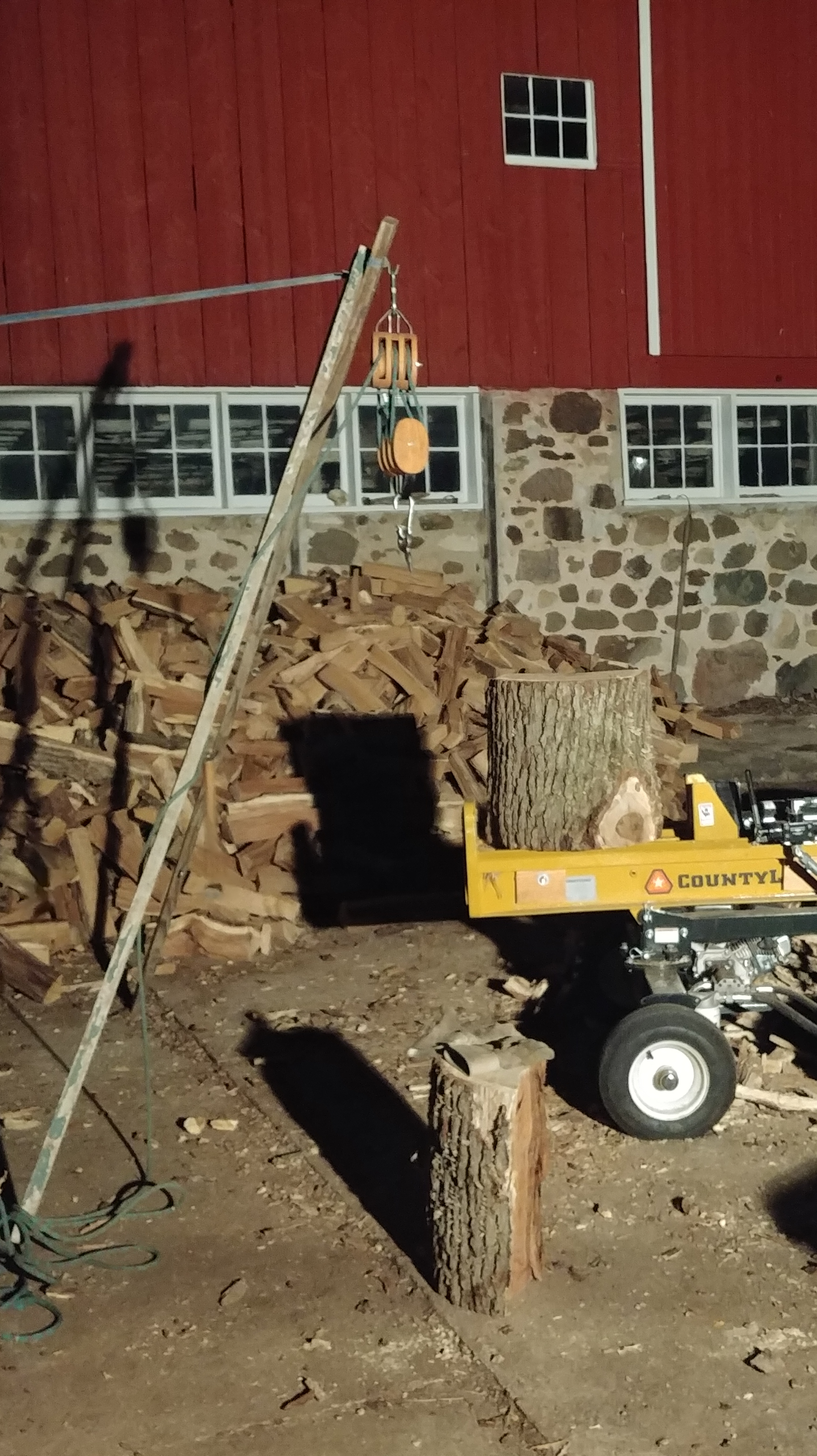

That was when I had the splitter but no tractor with a loader. Once I did get the loader, I decided to use it - and promply dropped a large round on the splitter and made a nice mess of things. Luckily the steel was soft and easily bent back from pretzle to straight again. Another idea I had was to grapple a manure spreader full with 1/2cord of rounds, and roll them off the back onto the splitter, then toss the splits into a second trailer. It all worked for the most part.
It was mentioned that a flat surface, like the top of an I-beam, is way easier to keep chips off of than the county line types that have the wedge enclosed in rails. Something to look at.
How high were you dropping it from to bend the steel???
Those countyline splitters and clones are meant to withstand cylinder force, and one fg round on the end (fat guy), and thats about it. A 200lb round tipping off the loader from 6" up was enough twist its members.

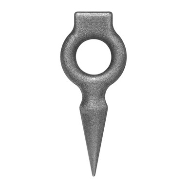

You bring up a great point. An axe works. The specialized tool called a pulp hook is almost an essential hand tool if splitting wood. It makes the job so much easier that you wonder why it took so long to realize what a gem of a tool it is for this endeavor.
The other tool you’d use as you use the axe is the pickaroon
