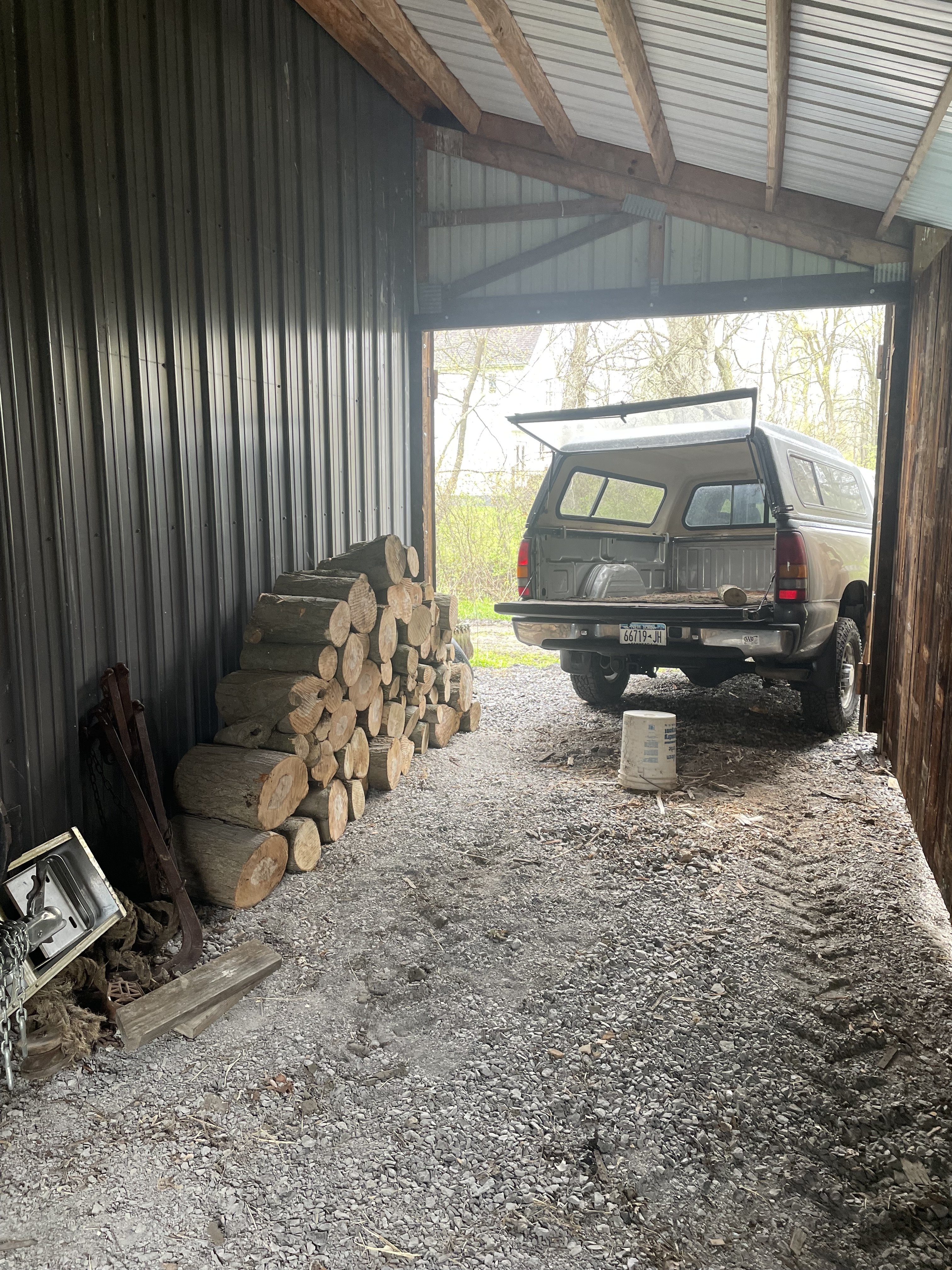

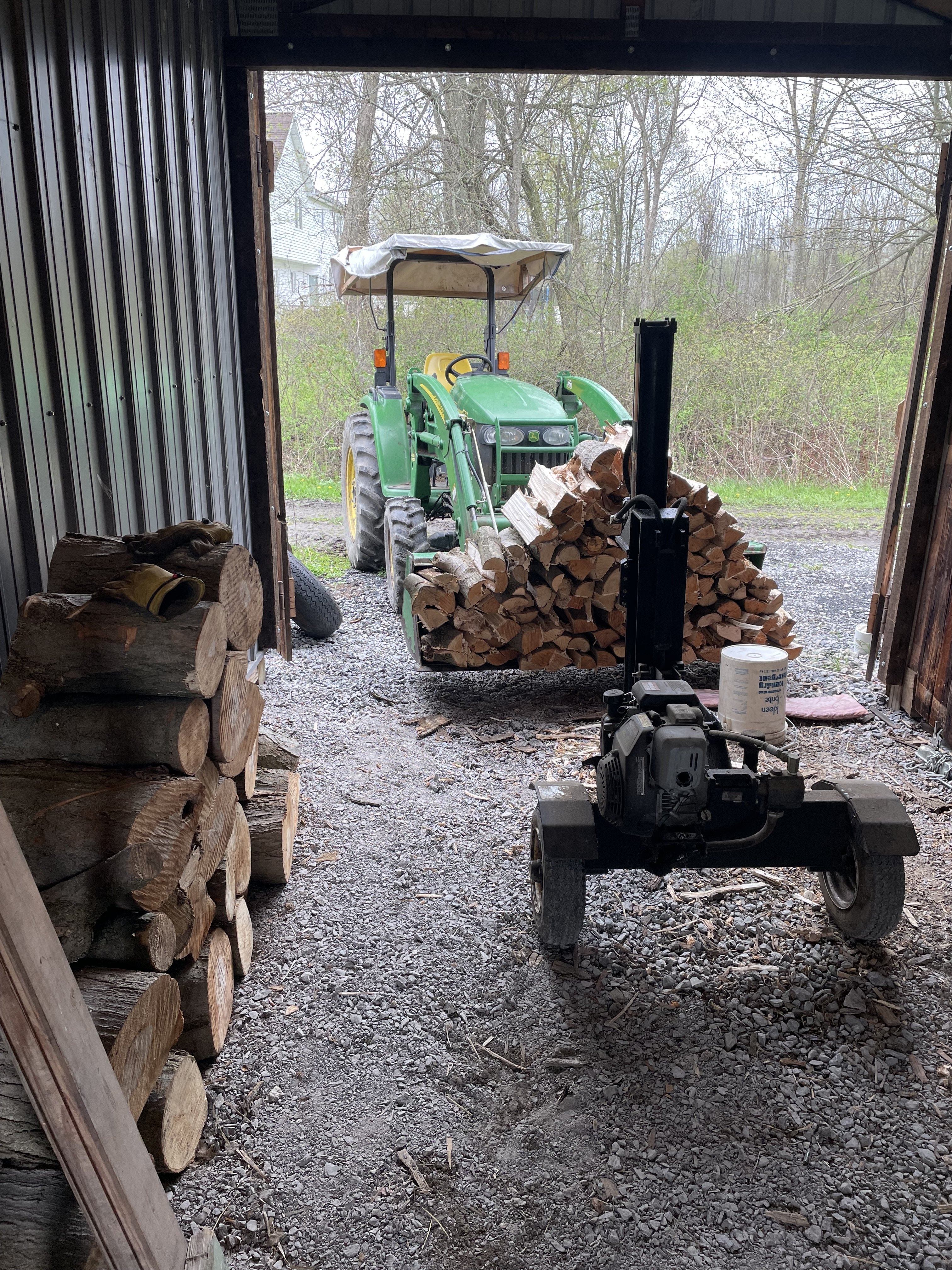

I enjoy splitting wood, with my 20 year old 22 ton 2-stage horizontal /vertical northern hydraulic splitter, powered by a 5 or 6 hp Honda engine. I find it a very relaxing way to pass the time on rainy days, which we get plenty of up here on the Canadian border, about half way between lakes Erie and Ontario.
I mostly use the splitter in the vertical orientation, while seated on an upturned 5 gallon bucket. It’s easy to roll the larger rounds onto the platform, and I toss the splits into the bucket of my canopy-equipped 4 WD tractor, then move that out to the adjacent woodshed, that has a wide overhang. It can be pouring rain thru this whole operation, and me and the wood stay dry the whole time.
On non-rainy days, I buck up the wood, usually over at my parents place 17 miles away, where they have about 50 acres of hardwoods. Unlike my own 10 acres of woods, their’s drains real good and I can access most of it just about year round with a 2wd tractor. I’m usually limited to about 3 months of summer and a month of winter to get firewood out of my own woods, with a 4wd tractor
Cycle time isn’t bad at all with this splitter, thanks to the two stage hydraulic pump and smaller diameter cylinder. Frankly, I wouldn’t mind if it was a little slower, because I find it a very relaxing way to kill time on rainy days. Way more fun than sawing up the wood.
My favorite part, of the whole firewood making operation, is loading and unloading the woodshed. What a pleasure that is, compared to keeping the split wood outside on pallets covered by tin or tarps. Splitting is second best.

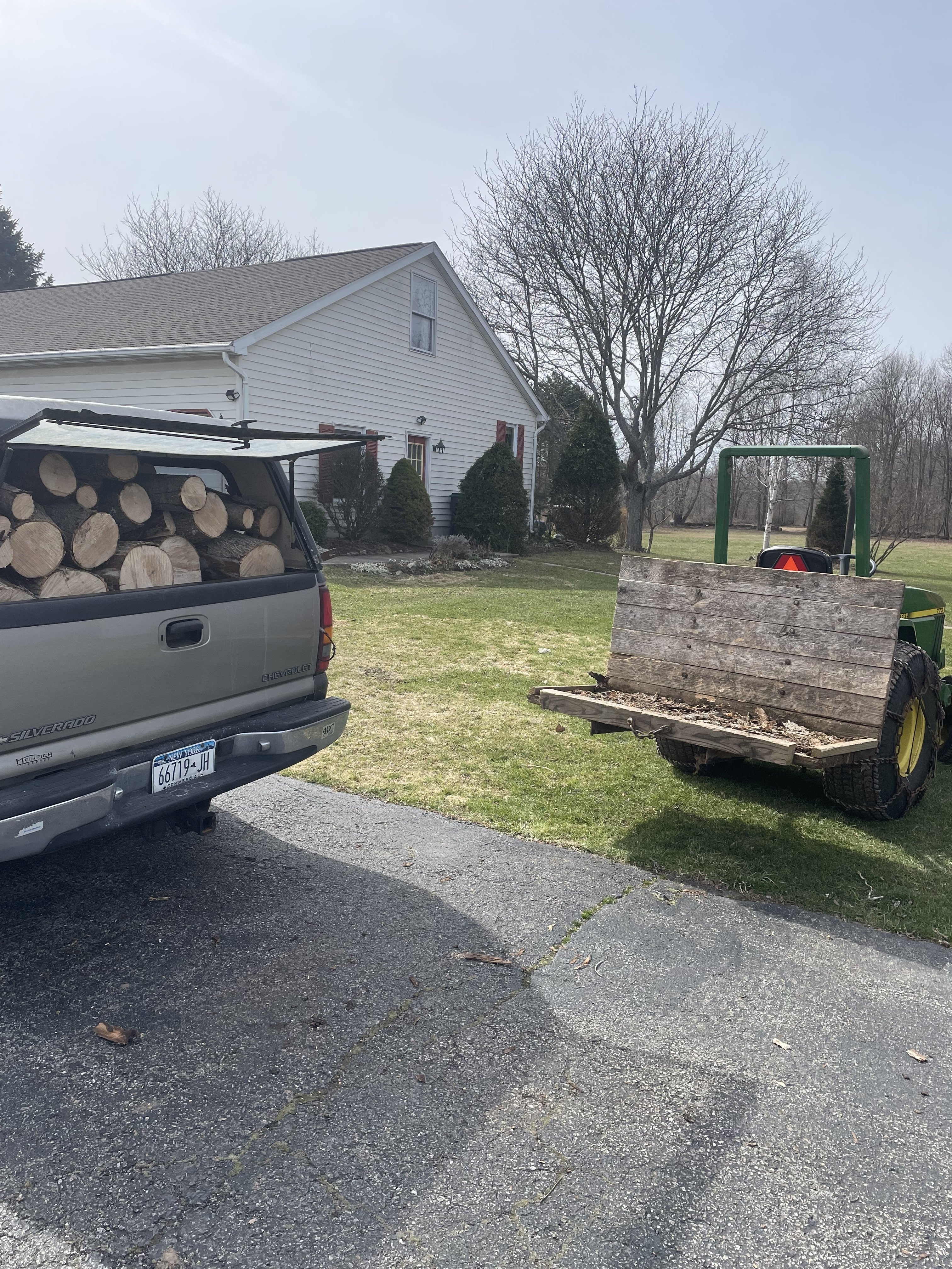

I miss the days when I burned more oak, but the chains do stay sharp a little longer cutting up the softer stuff. For the last 15 or so years, most of what I’ve been burning has been ash. They were about half of the trees in my own woods, and about 1/4 over at my parents. EAB has killed them all now, so I will probably only need to deal with them for another couple years.
I no longer cut them down (too unpredictable when they are dead), but I try to cut them up within a month or two, of when the wind drops them. It’s been years since there was a shortage of blowdowns on the trails in my parents woods or from the hedgerows of my fields or my little woodlot at home .
As I’ve gotten older, my back gets sore bending over to cut them up on the ground with my saw, so at home I use my tractor forks to lift the logs onto a trailer, to buck them up. Over at my parents, I usually sit on a chunk while cutting up the logs or lift them with a 3-point carryall.
My dad’s little JD 770 works good for hauling the chunks from the woods trails to my pickup. I’ve got to drill a heavy plate, to bolt to the front grill guard on that, so that I can haul more on the carryall . That’s my next “rainy day” shop project. I also have a pretty good pile ready for splitting in the splitter shed now though, so I guess it’s time to pray for rain.

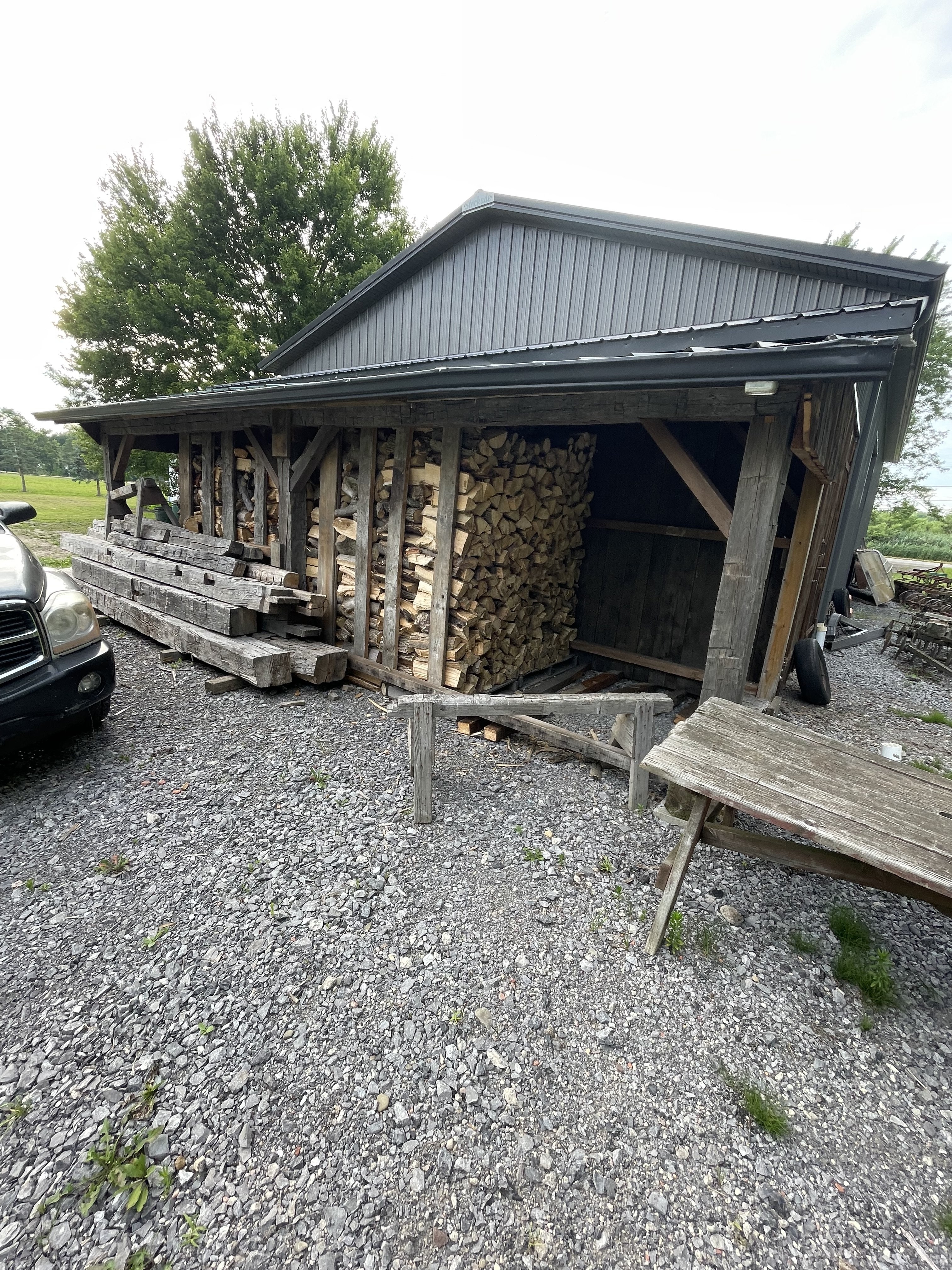

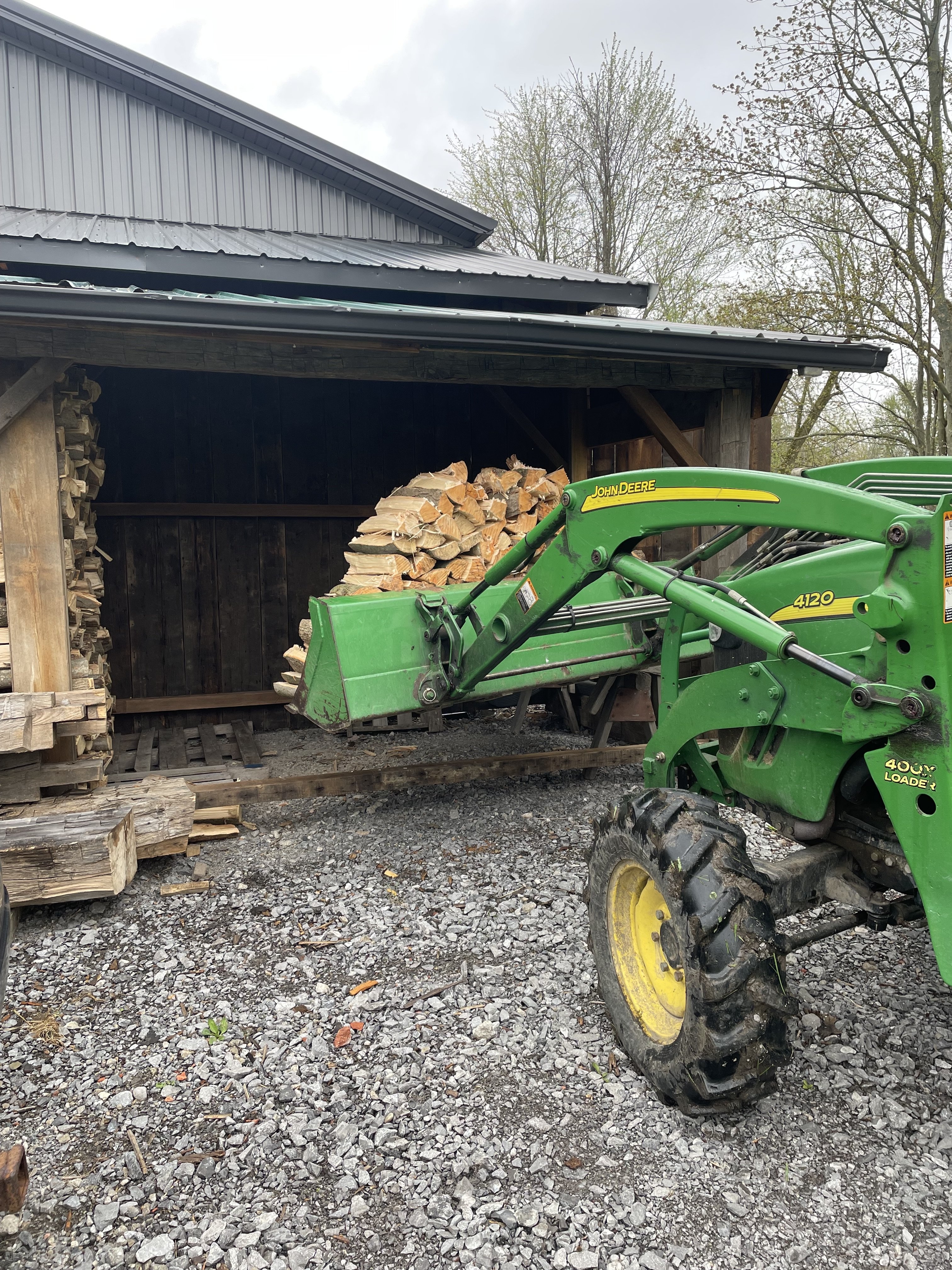

Stacking firewood outside was definitely my least favorite part of the whole operation also. Having a decent woodshed makes a world of difference.
Keeping firewood outside was torture, stacking, trying to square up the ends of the piles, and unloading dealing with tarps or tin covers in the wind, snow and rain.
This woodshed turned all that around and made the stacking and unstacking my favorite part. My woodshed holds 24 face cords, which is enough for (4) average winters, to heat our well insulated 2000 sq ft house.
All the material to build it was free - I recovered the hand-hewn oak posts, beams, sawed rafters, and purlins from my great great grandads old timber framed barn, which I dismantled, and the roofing tin is the shipping damage “protector” sheets, that came with my new Stockade pole barn.
