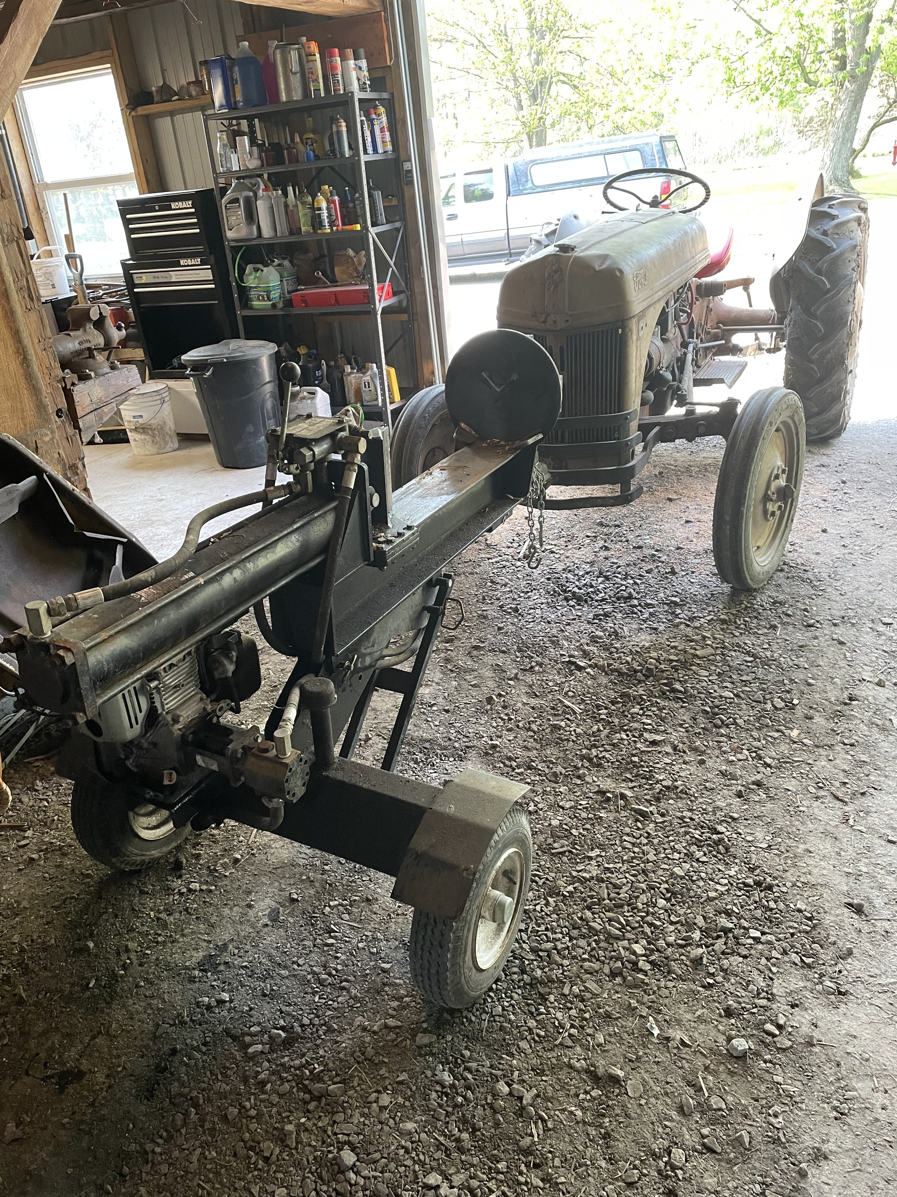

I was pretty impressed with the strength of my 22 ton, 5 hp Honda, Northern splitter in the retraction mode. The welds on the backing plate were kind of shoddy and cracked after about 10 years. The splits across them eventually widened to about 1/8”.
I tried heating the broken area up with my torches, and pounding the plate back square with a sledge, but wasn’t successful at that. Next, I chained around the back of the plate and around the wedge, fired up the engine, and used the cylinder to completely close the weld split.
I left it running there, and laid down several beads along the split with 1/8” rod. I don’t think I’ll need to ever worry about it breaking again.
Overall, it’s been very dependable the last 20 years. I’ve never changed the hydraulic oil, which was cheap stuff from Tractir Supply, but I do change the oil in the Honda once per year with 15W40 Rotella.
Ive also changed the air filter once or twice in 20 years and I’ve always used ethanol free gas in it. When it starts taking a few extra pulls or running a little rough, I give the carb a squirt or two of carb/choke cleaner while it’s running. That usually straightens it right out.
