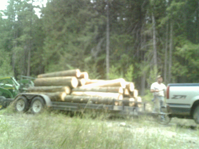

Why not just stack the logs naturally and chain them down. You will have to make more trips but the smaller loads will be easier to tow. And might not be too far off the trailers limit.:)
Just chain them to the trailer. If your going to stack them, put some boards in the stake pockets that are higher than the highest log.

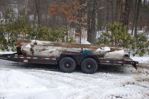

Not that Fenders make good bunks, I found using blocks again the outer logs keep them from leaning on the fenders so hard or at all.... then chain and binder them down. Hauled many a load this way. I not caught no grief from DOT or anyone but the forest service who tried to pin me for hauling pulp wood because of my log lengths ... fixed that buy cutting the logs shorter.
The best way is a pair of bunks fastened to the trailer. Got to lift the logs a little higher to load but they will be cradled nicely and held off the trailer deck to help in unloading also.

I would suggest some sort of headache rack on the trailer if at all possible. For somereason even in a tight stack, that one center log might not be pinched in very tightly and if you yak on the brakes, you might have a new swiss cheese tailgate on your truck! Your almost certainly going to have to take smaller loads than your thinking of if the wood is green as well. I also vote for laying down some 4"x4" dunnage so that the place can unload them with their forked machinery. This will also allow you to wrap the load with a pair of chains to make a bundle and then chain the bundle down.
