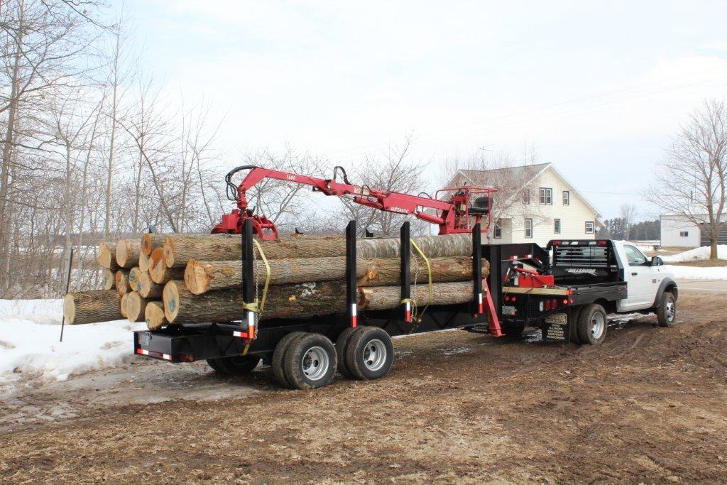

I would second the option to have a log trucker do it for you. It may cost you a couple hundred dollars but a lot better than hauling them yourself on a flatbed trailer. It just takes one accident and unless you are license to haul logs it might be problematic for you. A good alternative is hire a portable sawmill to come onsite and saw the pine for you at your place which would eliminate any cost of transportation. Attached is my small log trailer that I use around my sawmill and doing some hauling but if I was to transport any significant amount of logs I wouldn't want to do it myself. Log Trailer (2).jpg

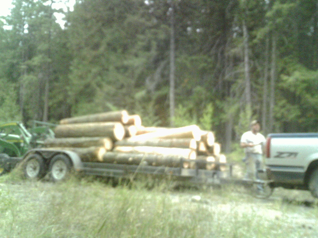

Just chain them to the trailer. If your going to stack them, put some boards in the stake pockets that are higher than the highest log.

Not that Fenders make good bunks, I found using blocks again the outer logs keep them from leaning on the fenders so hard or at all.... then chain and binder them down. Hauled many a load this way. I not caught no grief from DOT or anyone but the forest service who tried to pin me for hauling pulp wood because of my log lengths ... fixed that buy cutting the logs shorter.
The best way is a pair of bunks fastened to the trailer. Got to lift the logs a little higher to load but they will be cradled nicely and held off the trailer deck to help in unloading also.
