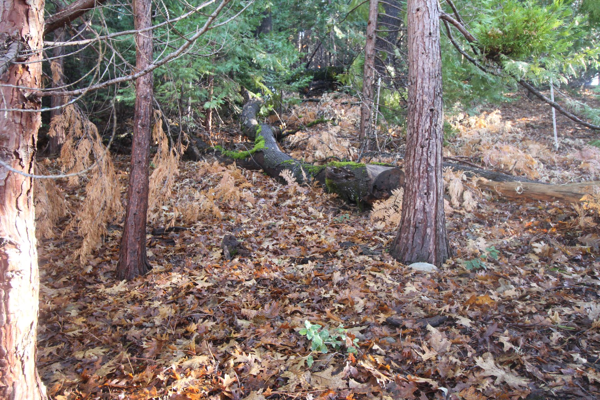

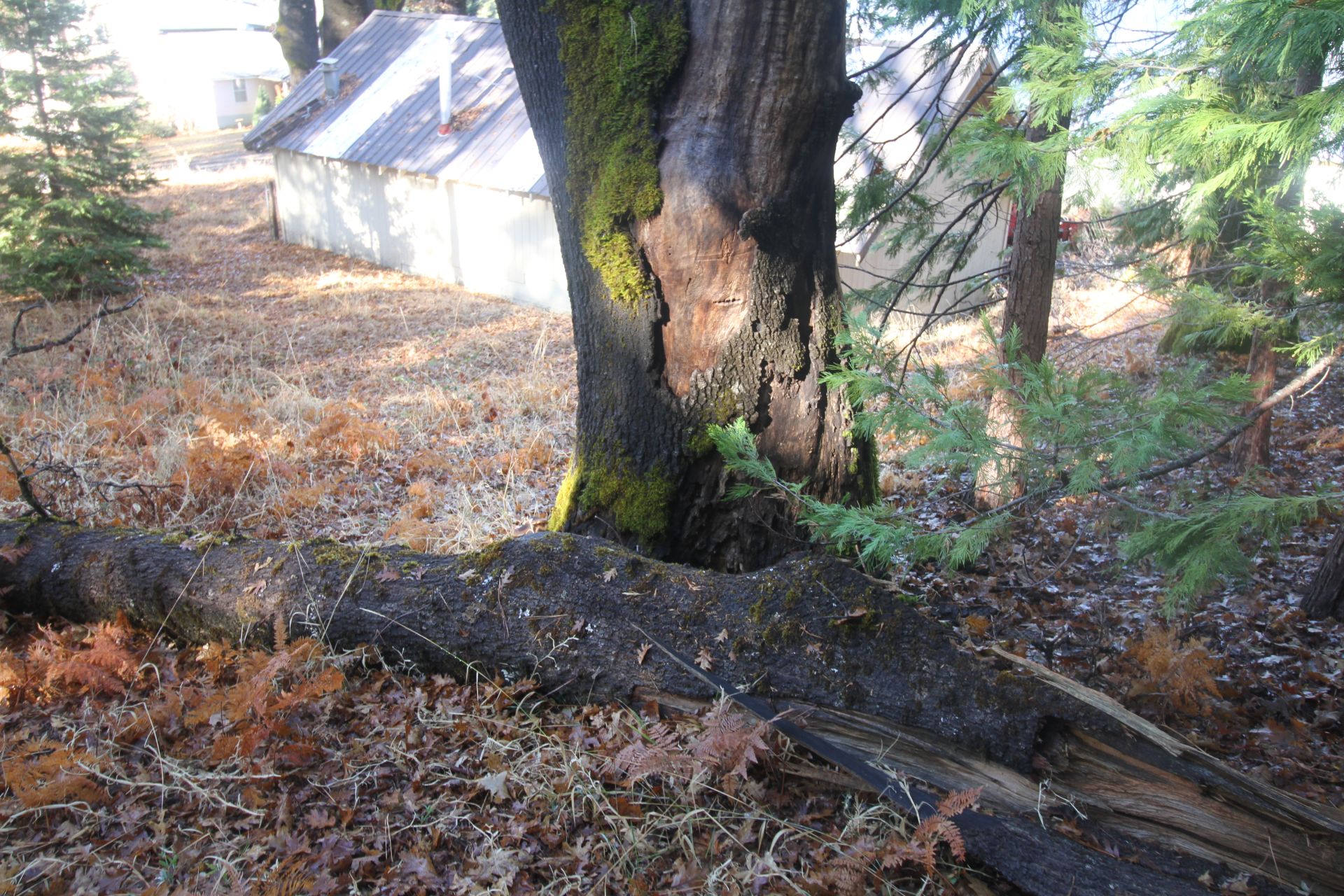

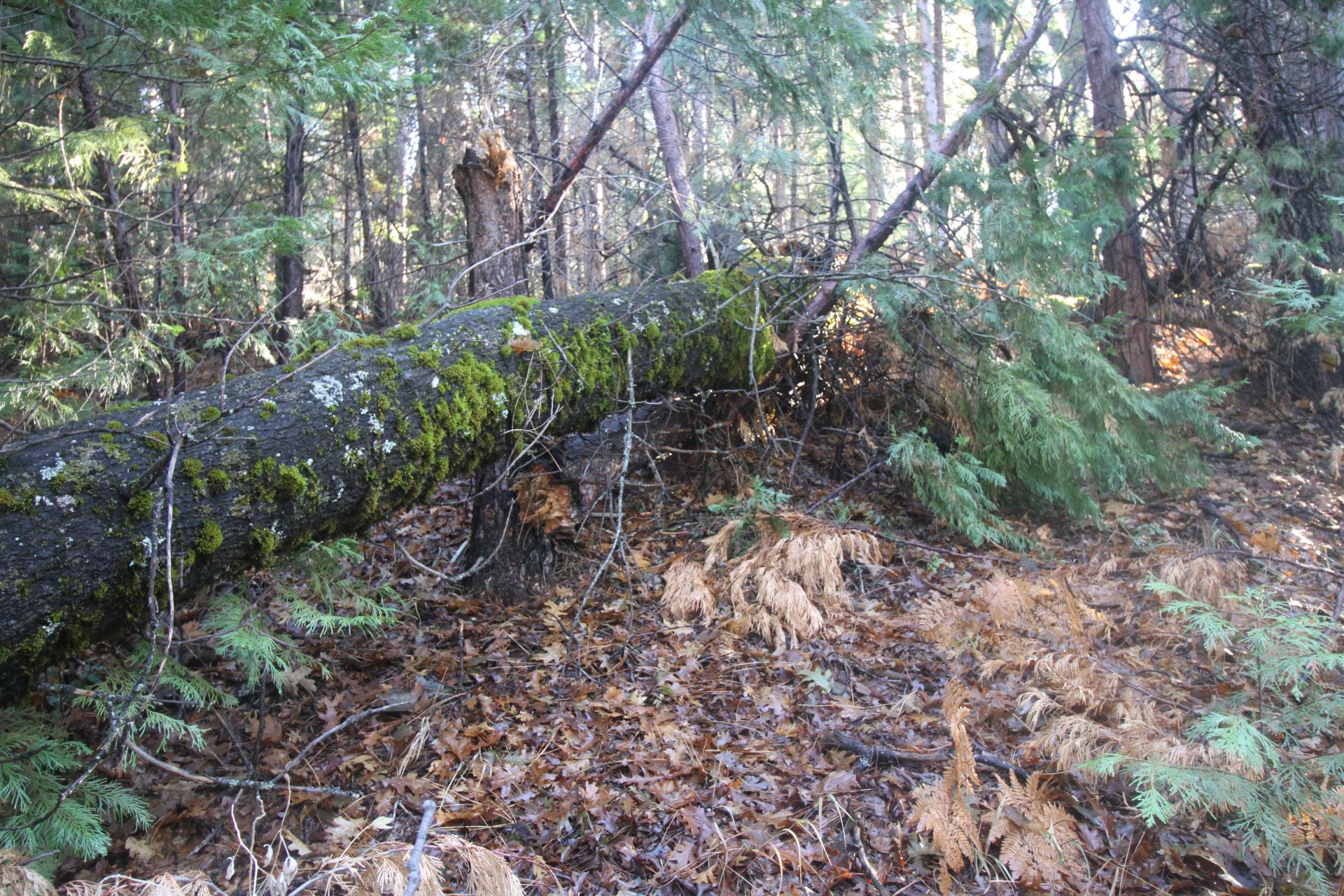

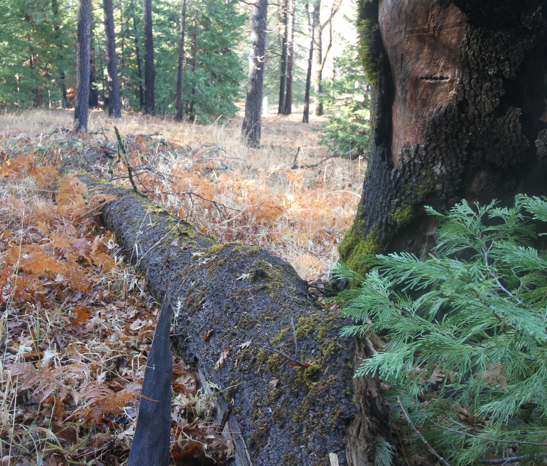

Here are some pictures of the limbs I want to winch "sideways" and "downhill."
I looked again at the limb I want to winch sideways. It's a little larger than I thought-- more like 20" at the fattest end.
The logs I want to come downhill are bigger diameter. Regarding a possible option to instead pull them uphill, I don't know. From being at the limbs and looking uphill, it doesn't look appealing. Maybe I need to climb to the top of the hill above them and see if there is a way I could winch pieces of the limbs out-- going uphill?

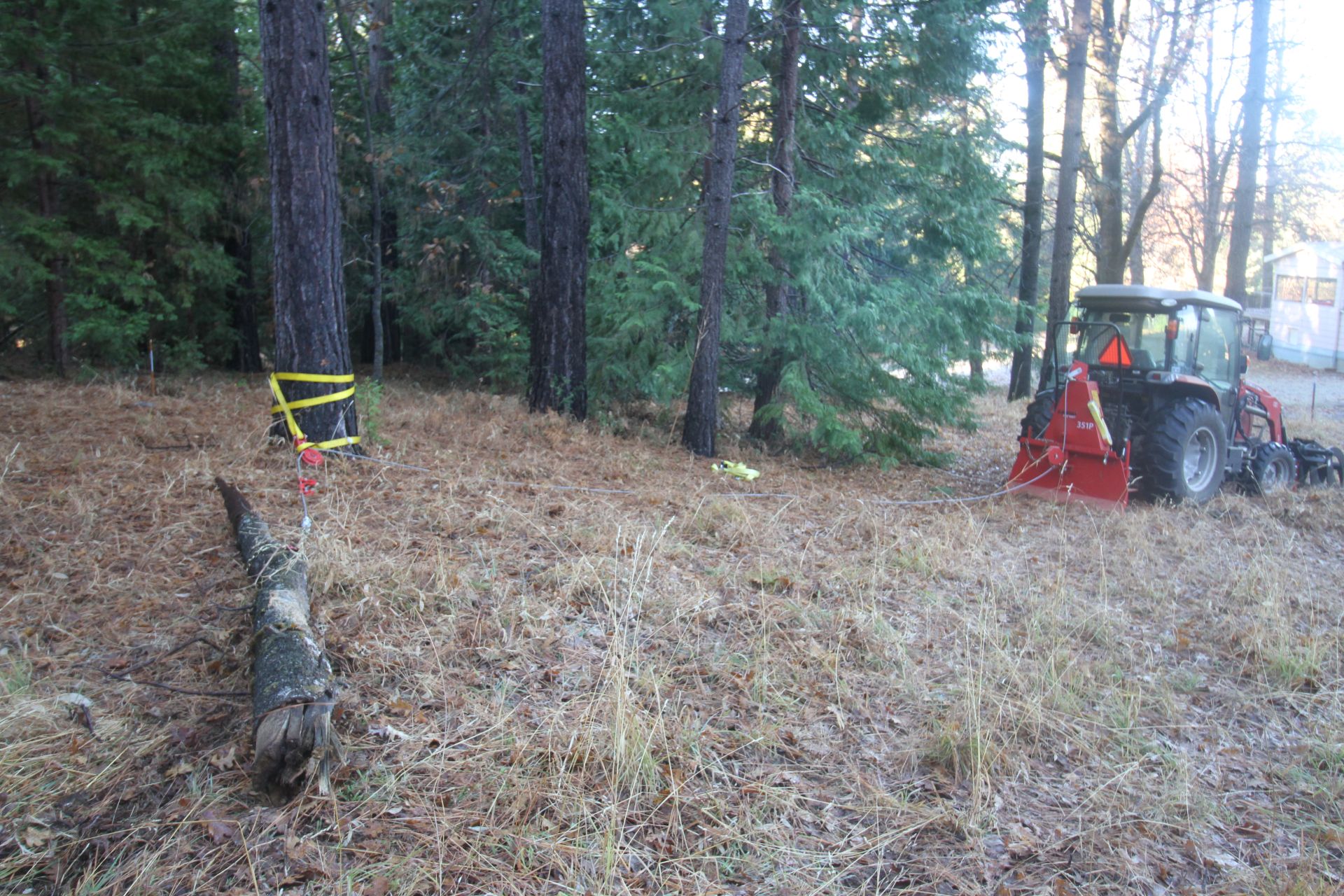

Personally I don't see your side hill as a "problem" is pretty gentle.... Slightly more than flat ground.... IF picture are not deceiving I would just wrap a chain around log and connect it to drawbar and give it a tug.....

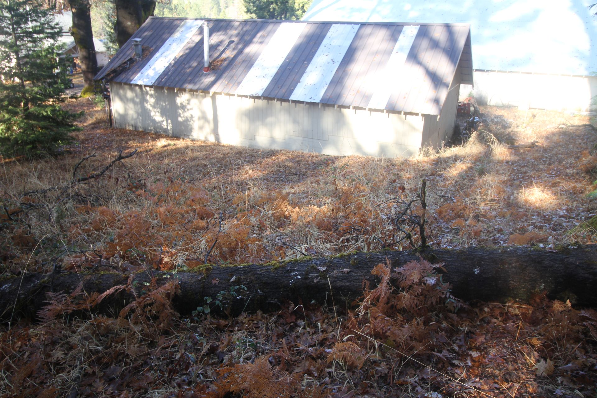

I spent several hours yesterday at that location, sawing up the smaller stuff. I quickly realized there is a *lot* more slope than I originally thought. Like John wrote: the picture doesn't show the slope very well.
There is enough slope that I'm concerned when I cut a section off the end of the limb, the newly severed section might take off rolling on its own. I will revisit it this morning and contemplate the good advice given.

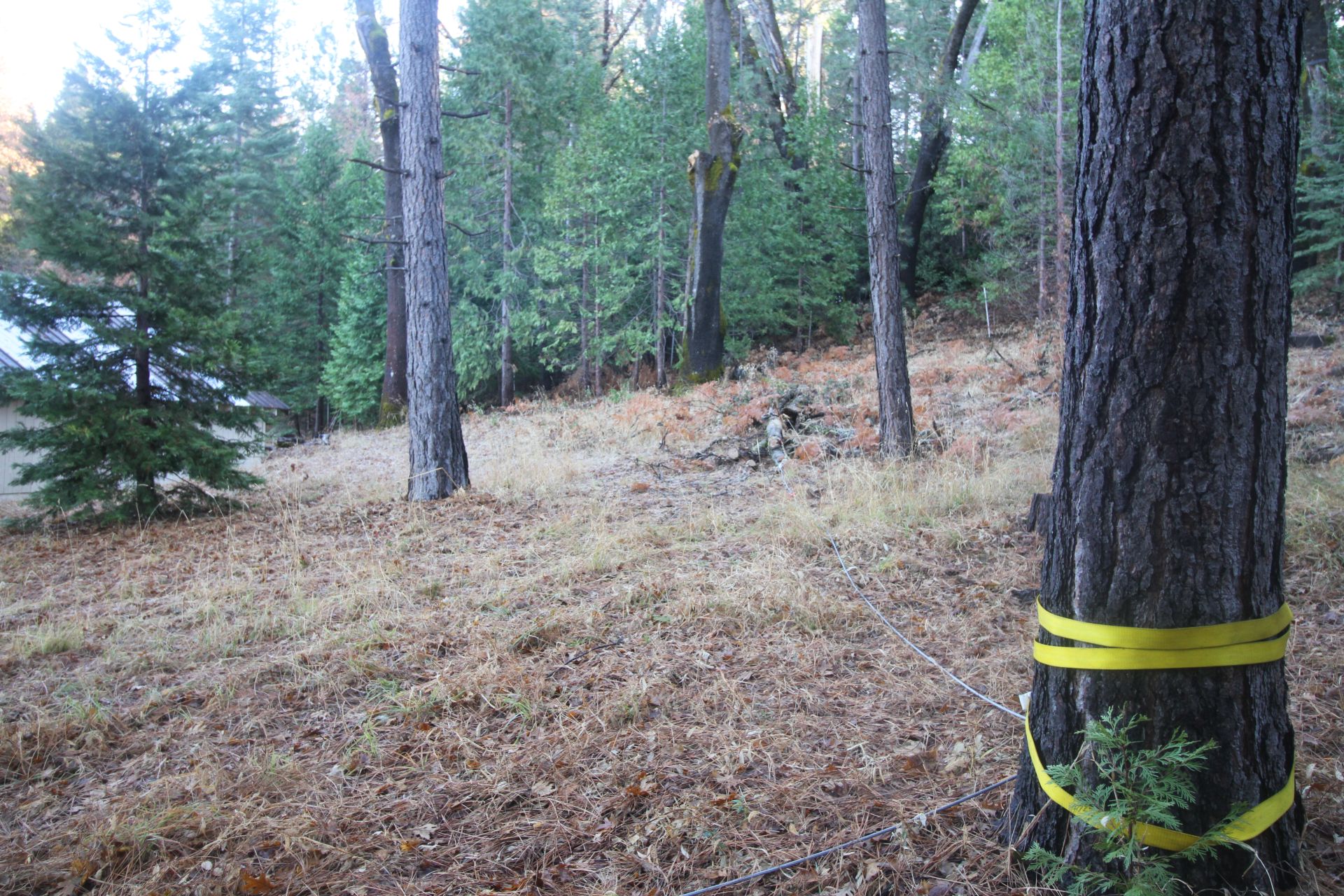

I took a few more pix that maybe better show the amount of slope.
I set up a (self-releasing) snatch block, with tractor below, and tried a first lateral pull on a small 7-8" diameter limb. It pulled nicely. There was very little downhill movement, which surprised me.
With that limb removed, I discovered one of the larger limbs has a fork in it. I have to cut the limb to make it shorter to pull, plus cut some of the "fork" out, but I'm presuming it's best to leave a good chunk of the fork intact so it would inhibit rolling?
