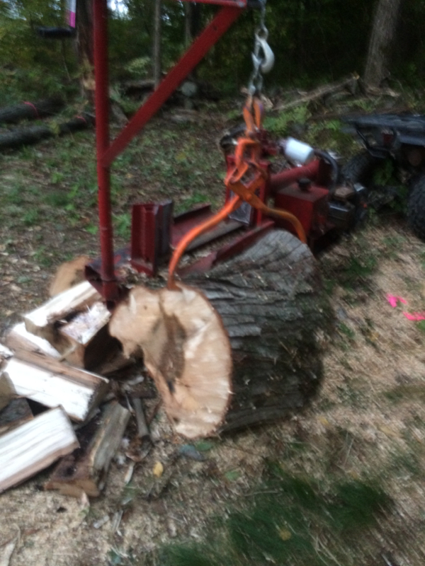

Hi,
Have a set on a hand winch I use to lift rounds up on my spliter.They work great if you have 2people one holds them on the round until it starts to lift.problem is by myself it doesn't work so good .i tap them in best I can but sometimes they come off until I get a tension on the cable.any one ever tried to attach a spring to keep them taught or does any one have another idea?

You might have "skidder" tongs instead of "lifting tongs". Lifting tongs have the gripping points angled quite a bit to dig into the bark when the log's weight is applied. A round may not have enough weight to activate the points. I use a small two-pound drilling hammer to convince the points into the log if it becomes an issue. Also, every once in a while the points will be sharpened. It is amazing how much better they hold when sharp.
A photo of your tongs would help.
Also, rounds tend to be difficult to handle with tongs unless they are used vertically on the end of the log. Using them horizontally in the center seems to cause the round to spin off the tong every time.

Heres tonghts pics it actually worked good on maple it doesnt stay in ash well i never lost a round tonight ive also learned to hook low to ground so its constantly pulling .any more thoughts its a little time consuming to tap the hooks in but sure in heck saves on the back

I think your tongs are about one size too small. Hooks point down a bit in the second photo.
Bruce
I'd have to agree with Bruce. You can see the tips on your tongs would let the round slip out. The tips should point toward the pull so that they seat deeper into the wood, the more pressure that is applied.
/ Logging tongs #12
Those are definitely "skidding" tongs, not lifting tongs. At least, that is the design. Obviously, in a pinch, they will lift.
The other thing is that tongs are made to go around the circumference of the log rather than as they are used in the photos. But...whatever works is the farmer's creed.

Still can't tell the difference between skidding and lifting tongs. They both seem to have tongs angle up to dig in. Other than the swivel, what differences am I missing?
The lifting tongs have longer and thicker points at a greater angle. The points will remain an angle when the tongs are spread. That way the lifted log stays attached to the tongs. They are also constructed out of heavier material.
The skidding tongs have shorter, less angled points. When spread, the points are parallel to the ground, or the log's surface, rather than pointed up. It can be seen in the photo of the round being lifted.
The skidding tongs are also designed to slip off if, say, the log being skidded hangs up on a stump. The tongs and the tractor are spared damage.

Do what DOZERNUT said and hit one side with a four pounder a couple of times. You don't have to hit both sides most of the time. Don't heat them. The size you have should work fine for firewood length.
