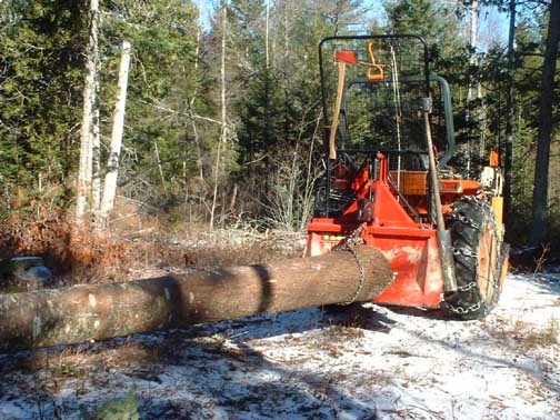

I have a Tajfun winch(EGV 30 A) and love it. It has been a real work horse. I have had it 2 years and have had 0 problems. The Tajfun comes with more and larger cable than the Farmi and 3 sliders as well as the protective screen stock. So make sure you are comparing the same thing when pricing. Don't get me wrong I think the Farmi is a good quality winch and really you can't go wrong with either one. I do not know anything about the other brands.
Used winches can be hard to find and if you do find one check the cable carefully, if you have to replace it your savings may be gone.
Check out the pics.
Good Luck
Dave

"I can only lift my winch 6" off the ground"
I would be in real trouble with my very uneven ground if I could noly lift my winch 6" off the ground.

   / LOGGING WINCH: BRAND COMPARISON #16
</font><font color="blue" class="small">( I would be in real trouble with my very uneven ground if I could noly lift my winch 6" off the ground.
)</font> That was my point. Although the winch is rated for a tractor my size it really isn't a good match. Much of my land is relativey flat; still I really have to plan my trails carefully, and this summer am going in with my backhoe to cut off some humps in my main trails. On the other hand despite my grousing on this and my previous posts I've managed to bring out about 100 cords of wood in the last few years; plus what I've cut for my own use.
You have a nice setup though. Last week I was trying to bring out some hemlock logs; after one got hung up on a stump I finally got POed, and replaced the winch with my drawbar just so I could get the butt off the ground. I'm about through cutting my lot; otherwise I'd be looking at a new winch.
